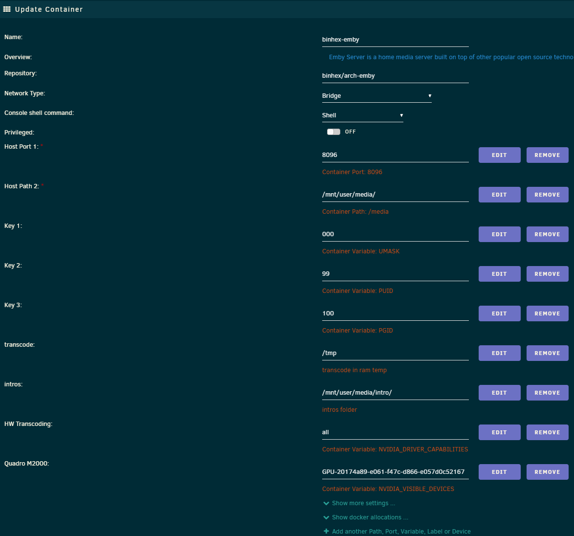

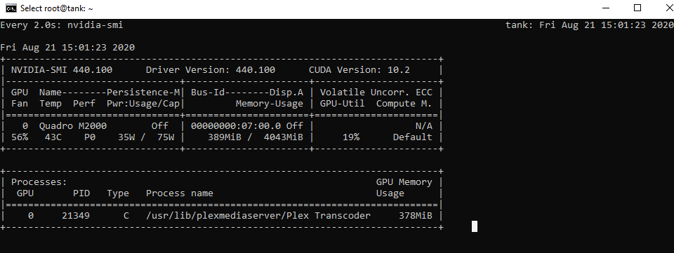

Trying to get my M2000 quadro working with emby, and having some issues it seems.
I followed - https://forums.unraid.net/topic/77813-plugin-linuxserverio-unraid-nvidia/ - and had easy success with plex.
Checking watch nvidia-smi from a terminal shows plex using it. Emby.... not so much...!

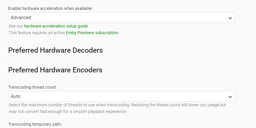

Under Emby settings I expected to see my GPU listed as shown in the tutorial, but no dice.
Any help greatly appreciated. TIA!

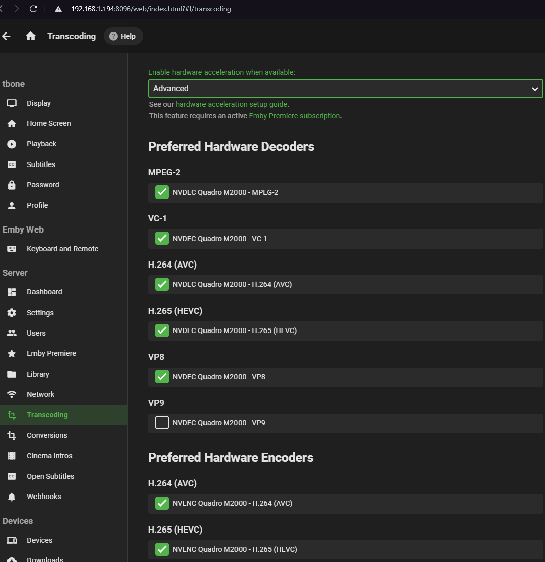

Solved by updating to EmbyServerBeta (from Emby)
pic1.png.f2106fdfb1a8951adf6ffb3a9b58234b.pngpic2.png.4a2b90353c7b63f23adab240c614105a.png

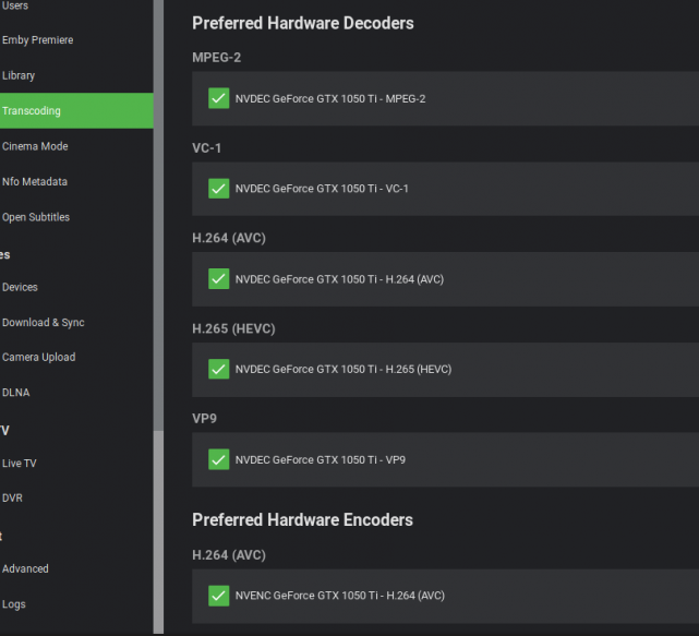

If you're using the linuxserver Emby install, it's exactly the same as Plex.  Can confirm it works fine (I'm using a much shittier GTX1050 to good effect).

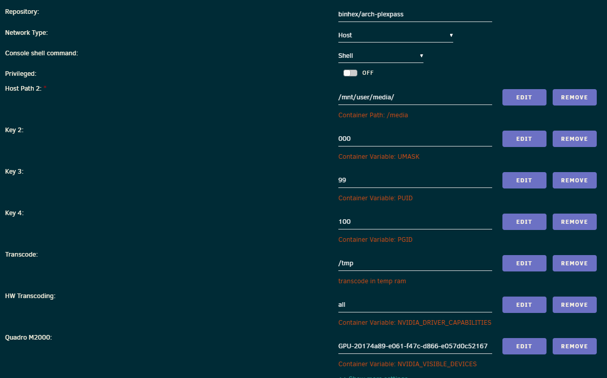

Glad to know others are having success (Rages inside!) bwahaha. I was hoping it was just as easy.... Maybe check over my config settings? Like you said, it was exactly the same I thought.... 🙄
pic3.thumb.png.663f899d7e54a33a4ab0a26c57d933eb.pngpic4.thumb.png.326103cfccc23bd31ef1650af2a935b7.png
Looks fine to me, did you remember to add the --runtime=nvidia variable in extra parameters?
I was hoping it was something that trivial... no dice :(
The worrying part is I should see them listed as shown in the tutorial...(mine pictured above) has two blank spaces :( :(

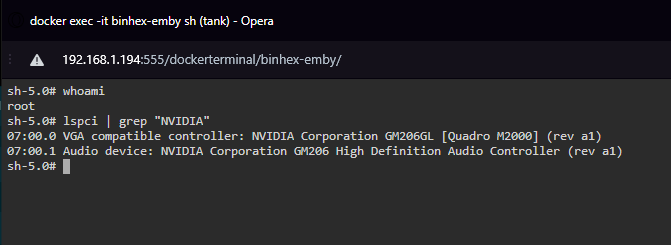

Can I console into Emby? ... (goes to test)

On that note, Is there any commands I could/should type out to show more info? lspci only shows its passed to the container, not necessarily used.
Just now, tbonedude420 said:
Good suggestion. Wanted to try the beta version anyway, so ill just test both and report back. My hope is its just not a supported GPU on the regular version, and it has been added in more recent updates/distros.
To be honest, I don't know, because it's always just worked for me, both using nvidia and Intel Quicksync using the i915 driver.  Hopefully someone else can help.
