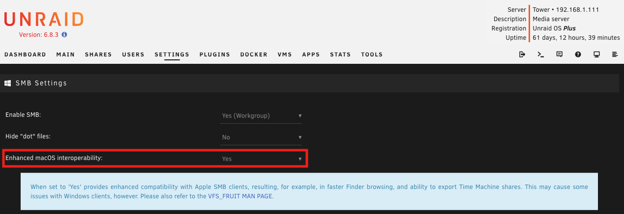

Hmm, I don't actually read/write to the shares much from my Mac (Catalina), especially big files. But I just did a test and the speeds aren't as fast as I expected for me either. I'm getting 10-20MB/s write, and a bit less on reads (single large file).
There are some SMB config tweaks floating around on the forum specifically for Mac transfer speeds, I will look into to this to see if it makes a difference and report back.
In the mean time, have you enabled "Enhanced macOS interoperability" under Settings/SMB Settings in unraid? If not, do that and see if it helps (probably requires restart of array at least).
1730142061_ScreenShot2020-08-24at9_32_45am.thumb.png.d42b10f7687ed2d94644bc19d4ebfc1c.png

I've tried the "Enhanced macOS interoperability" setting, but that broke my connection to the NAS from my windows machine.  Just wondering if anyone else came to any conclusions here.
