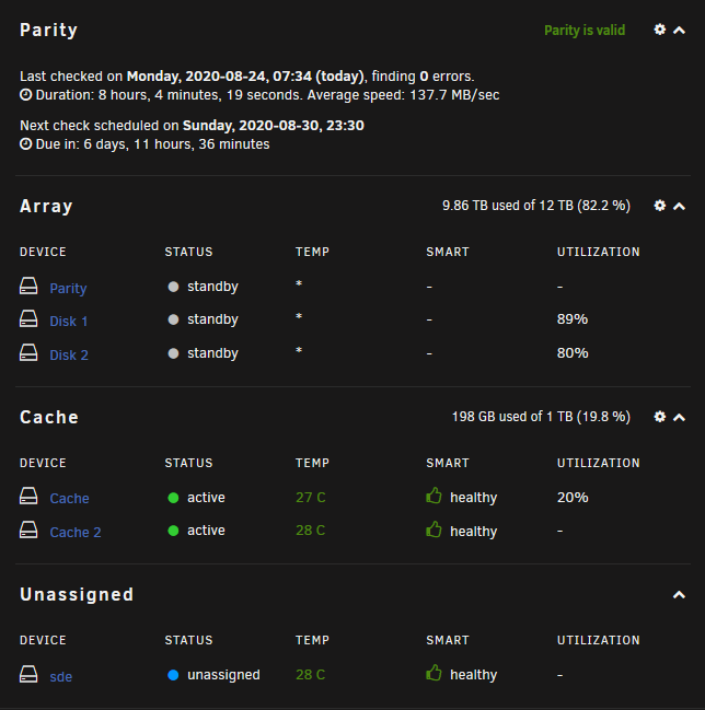

86861798_Screenshot_2020-08-24unRAIDDashboard.png.e7ed725e5a6eb768002350078cf3d315.png
My apologies for not sharing this from the get go.  Picture is worth a thousand words, or so they say
sde is my disk 3, or should I say it was.  As disk 3 is currently being emulated by the remaining 3.
I set smart to healthy, so I can monitor SMART without going into the details if nothing changed.....

Not according to the screenshot.

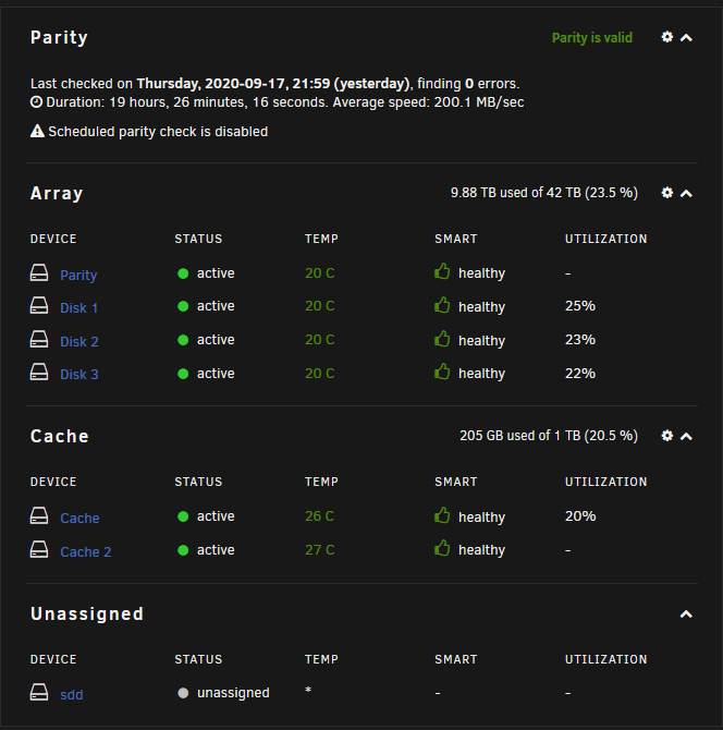

847399410_Screenshot_2020-09-18unRAIDDashboard.png.28d5385b996ff63bd7efd72c9ebbd31e.png
System finally looking good, from 12Tb to 42TB of storage, no data loss.
