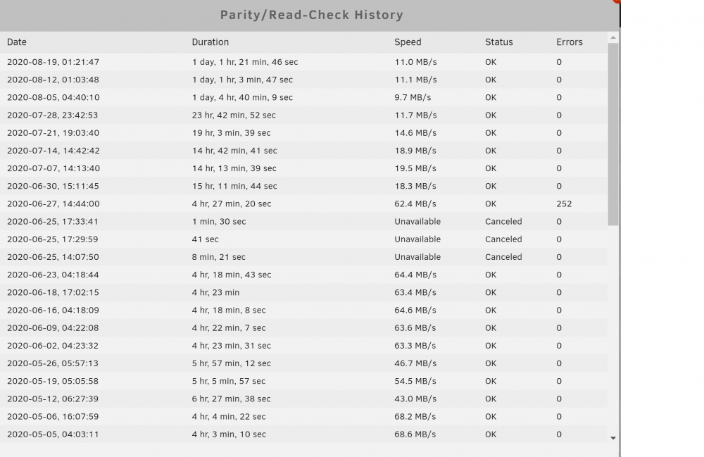

I am trying to understand why my weekly parity check speed was suddenly divided by 6 after replacing a disk causing errors.
I spent hours and hours on internet and on this forum looking for tips or advice on how to fix this, but nothing worked so now I post this message.

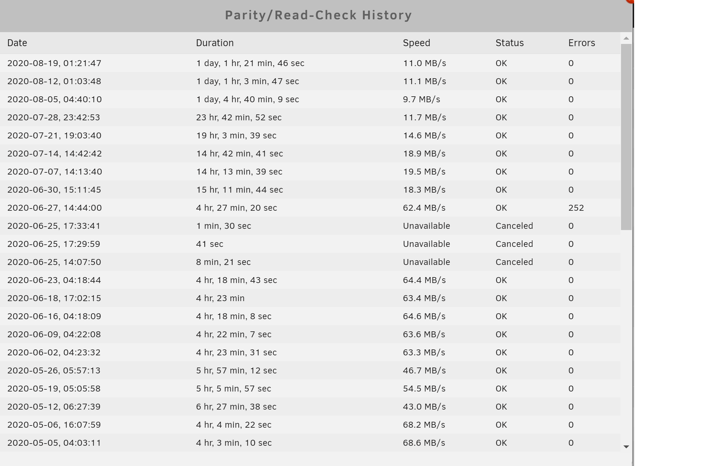

First you can see on parity check history the problem. On june 25, I had a power cut. I was out of the town and tried mulitple times to fix it remotely. On june 27 I was finally home and restarted my server and fix the issue.  My server was off between june 25 and june 27.
After the fix (array off, automatic fix by unraid), the speed of parity check suddenly felt down. And I don't know why.

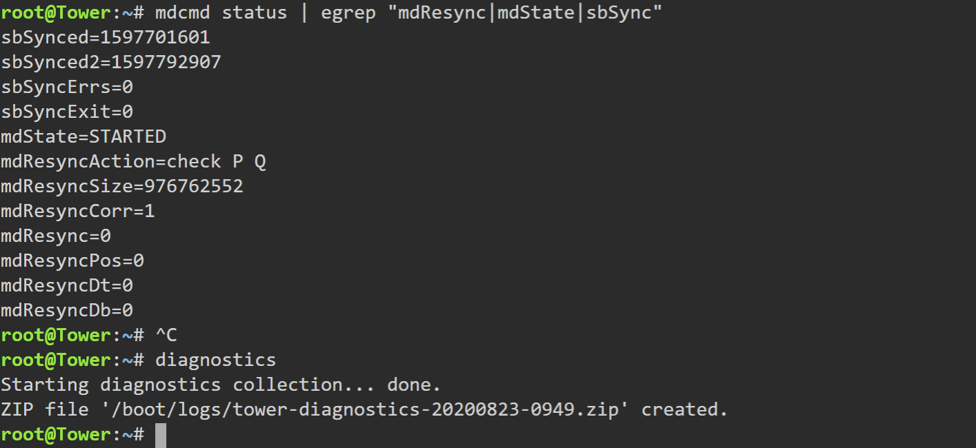

Now I try to investigate mdadm command but it looks different to what I see on posts and cannot understand it correctly.
For example:
do you know what is sbsynced2 and mdResyncAction status 'Q'... ?
Not that it is likely to be of any use to you, but my investigations suggest that sbsynced2 is a timestamp for the last completed sync, and the mdResyncAction value says that the action (last one if not one currently running) was checking both parity1 and parity2.

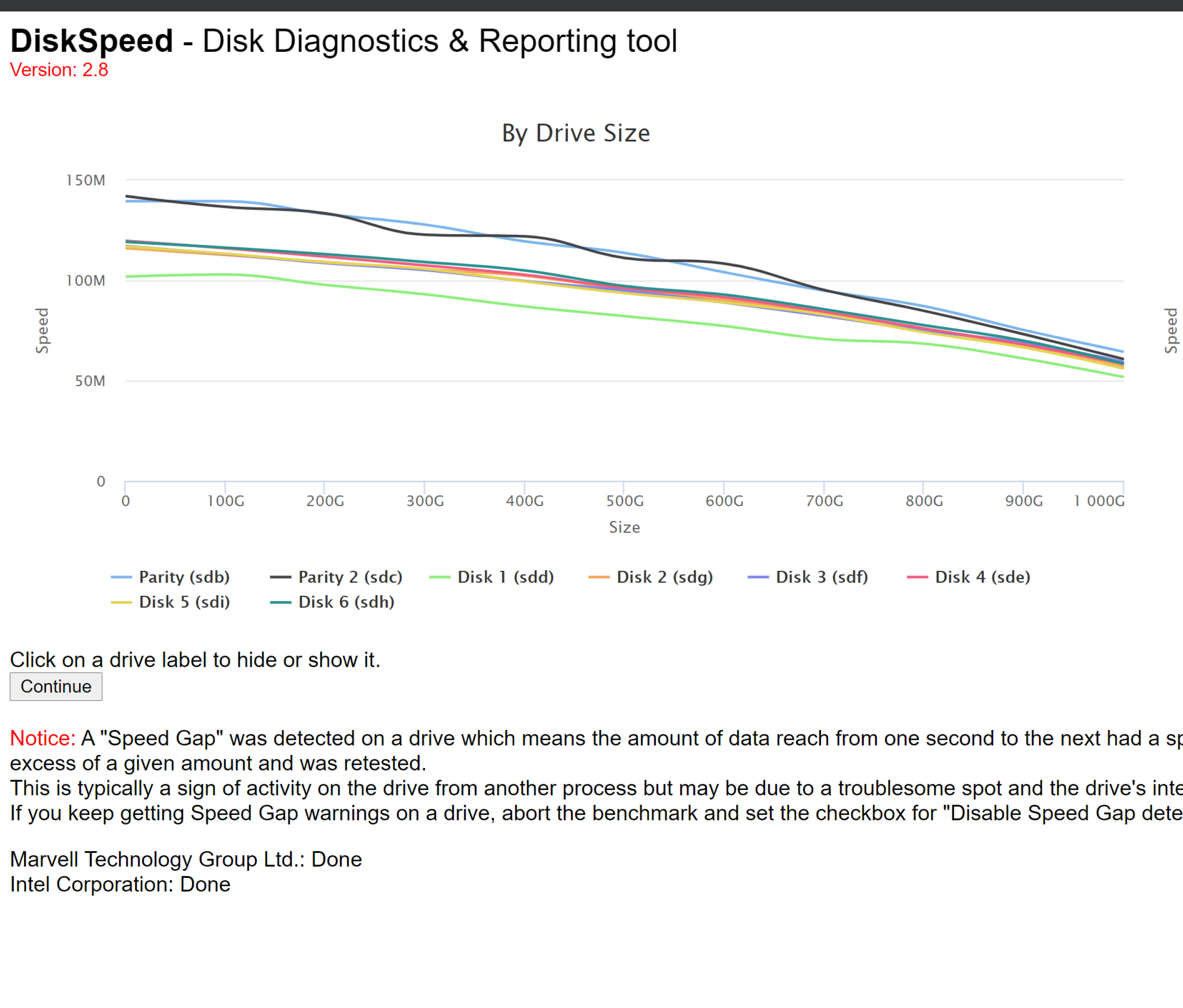

I have just run a diskspeed... nothing really interesting. All dockers were running during the test but with no a really few activity.
The 2 parity disk looks slower than others..... but at least 45M in read and write.
I am not sure disk are really the sourvce of this issue.

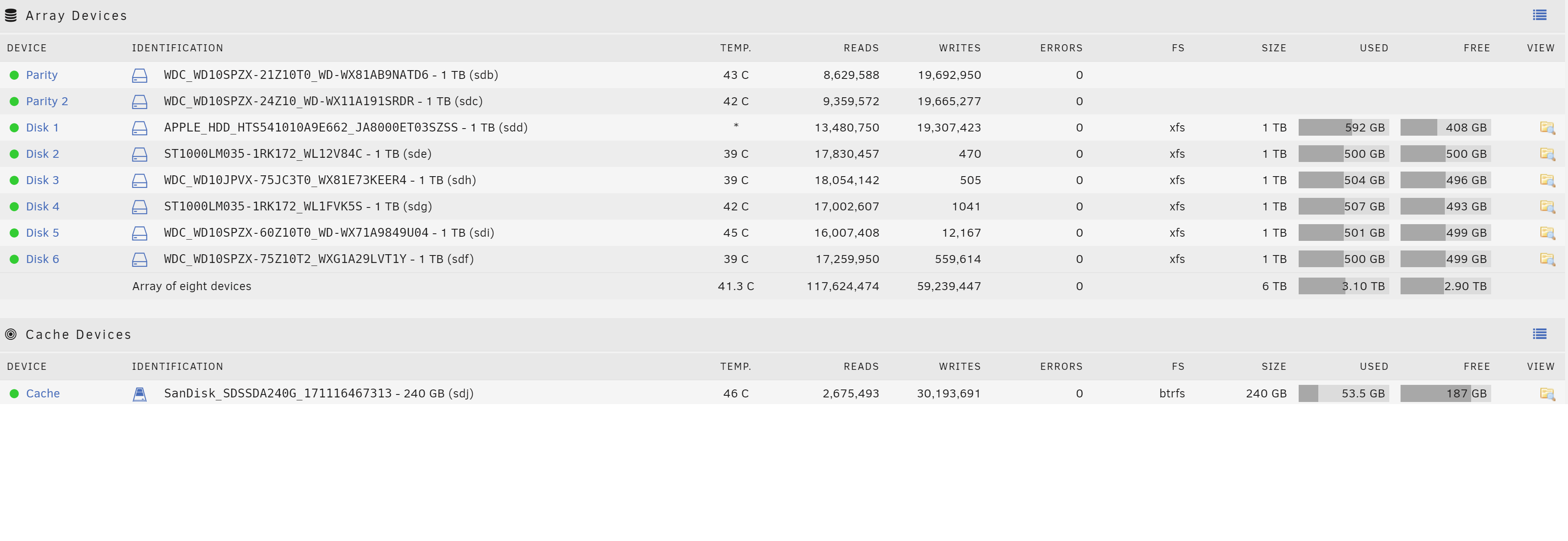

Those WD SMR disks (WS10SPZX) are known to be bad performers, especially on writes but also on reads, and that's visible in the graphs where they are reading on average about 3x slower then they should, diskspeed test only reads a few sectors from the disks so first thing would be to run a complete surface test on each of those disks so see how they are really performing.
I totally agree and red tons of documentations about it. BUT,  if you pay attention to the first image displaying check history dates and durations, you can notice that suddenly, after fixing errors, speed fall down. No disk were changed, the array is exactly the same than before. This is why I doubt my problem is related to hardware. But i might be possible that an hardware error suddenly raised during the xfs repair.
That cannot be the reason.

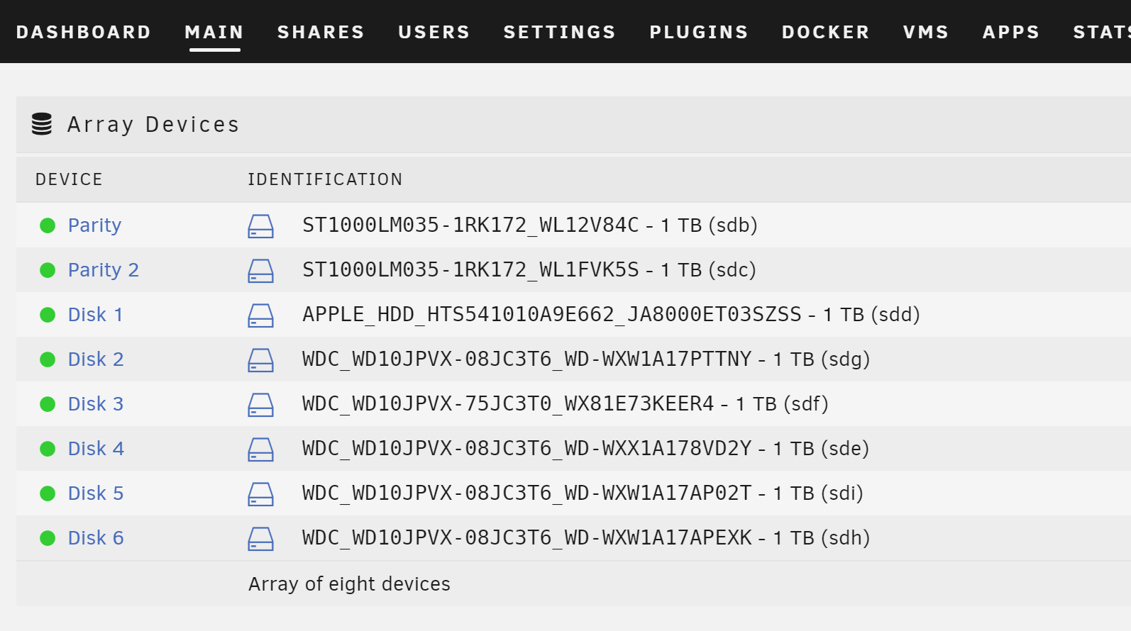

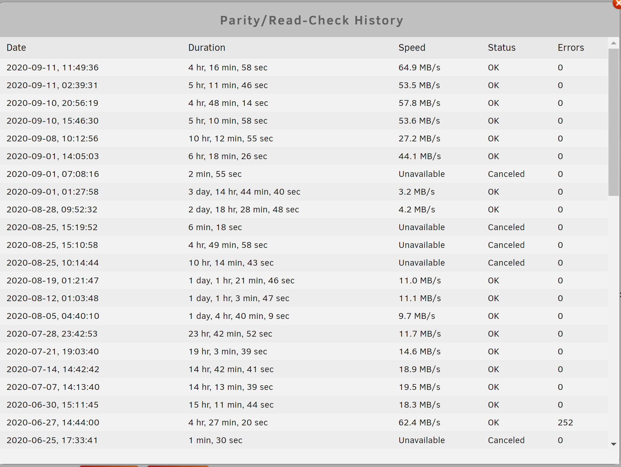

It took me 3-4 days per parity disk to replace my 2 parity disk (wd blue SMR) by Seagate CMR. Around 3-4 Mb/s..... OMG so long. Almost a week for 2 disks !!!!
BUT, I am now back on "regular" performance, around 65MB/s for parity check.
Conclusion: NEVER USE SMR DISK FOR PARITY !!!
SMR disks for parity with SMR disks for data... 15Mb/s
CMR disks for parity with SMR disks for data... 65MB/s

1 hour ago, tapodufeu said:
Seagate CMR
On 8/25/2020 at 11:01 PM, tapodufeu said:
ST1000LM035
If you mean these they are also SMR, but in my experience Seagate SMR perform much better with Unraid than Toshiba and especially WD SMR, usually you don't even notice they are SMR.
are you sure about it?
They perform better than my other CMR drives I have and based on list provided by seagate, LM015, LM024 and LM048 are confirmed SMR. LM035 are manufactured in 2016, apparently CMR.
Do you know any tips to check the technology used?
Yes, any single platter 1TB 2.5" disk is SMR.
You can't use just that part of the model, e.g.:
ST1000LM015 -> CMR
ST2000LM015 -> SMR
2 x ST1000LM035
Yes, those are both single 1TB platter disks, and they are SMR, but like mentioned and in my experience Seagate has the best firmware for SMR disks, I have used several SMR disks with Unraid, 2.5 and 3.5", and Seagate disks perform usually much better, most times about the same as CMR, I also have Toshiba SMR (and had some WD in the past) and those perform much worse.
So, now I removed all WD smr disk and change the controller to use a 6 ports sata controller (3 sata + 3 sata multiplex).
Bad performances disappeared and I am back on regular performance.

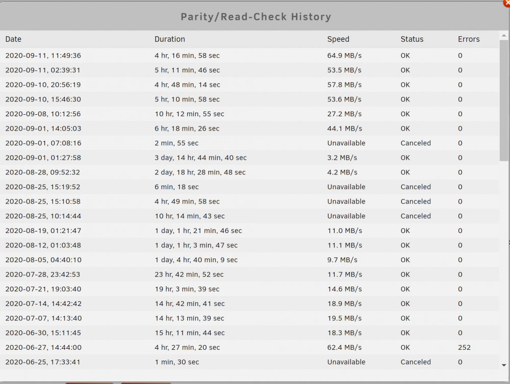

replacing my 2 parity disk from wd smr to seagate were 2 very slow operations... 3 to 4 MB/s (see check history). I was not just only a replacement but a switch data/parity disk to use seagate disks for parity.

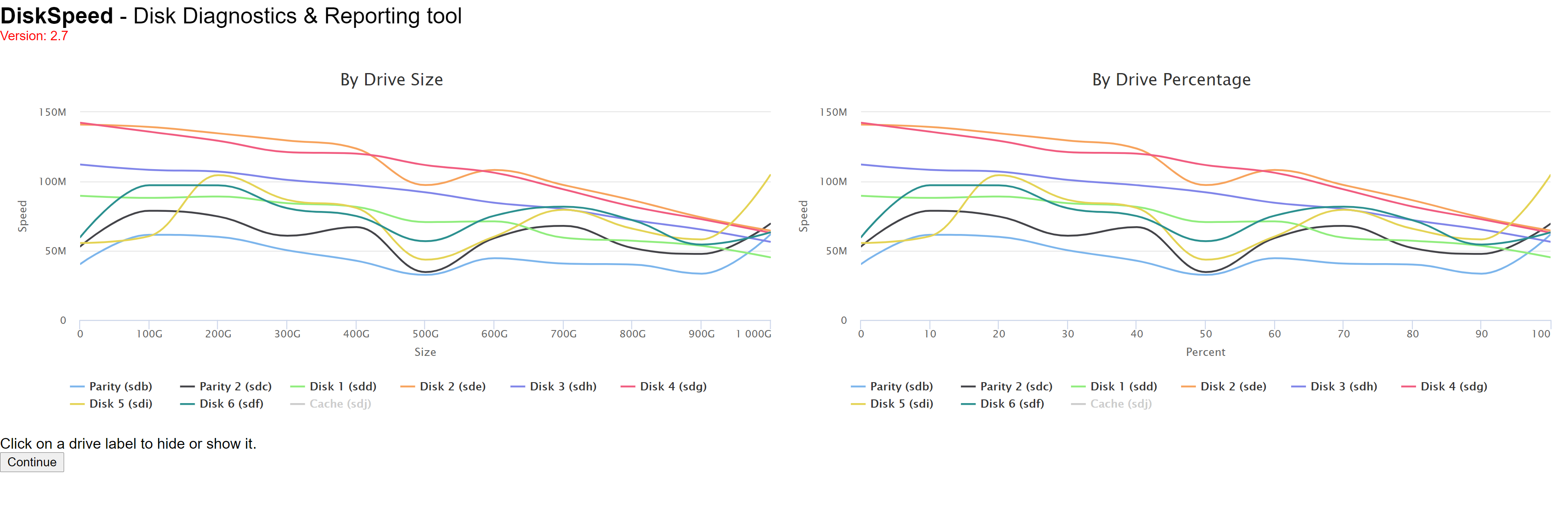

then I replaced one by one all my WD SMR disk by WD CMR disk. You can see that slowly, the speed increase at each replacement (4 disks). all WD10SPZX replaced by WD10JPVX (I was lucky to find a guy selling 4 of them, completely new and cheap)
the last graph is the speed disk test which also demonstrate the speed gap between old CMR and new SMR disk with western digital. Expect 30 to 40% more just during the speed test and 5 to 6 times better with unraid (12Mb/s compared to 65Mb/s during parity check).
to conclude, for all unraid users, try to avoid as much as possible all SMR disk, especially in 2.5 format, performance are even worst in 2,5 compared to 3.5.
