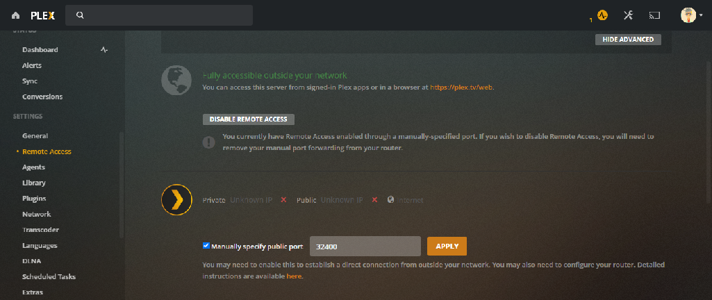

Plex - works fine and can connect remotely == but has IP issue as per attached screeenshot.

edit edit - plex screenshot - showing no IP
