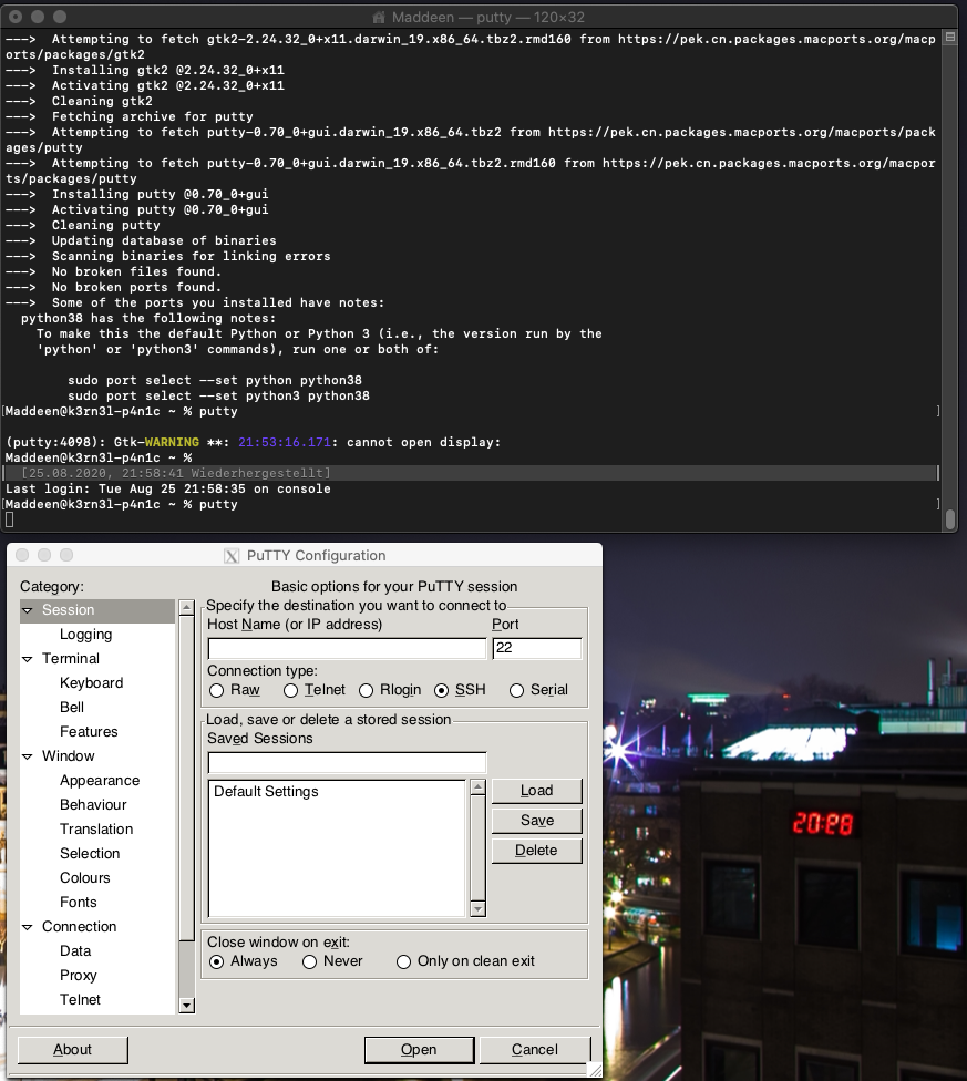

@jonathanm - thanks. The good news - I managed to install it.
But know I need your assistance again hoping that the linux adaption is likely the macport.
After installation I can run the command "putty" .. but it just opens the typical putty GUI :( (see Screen)
But how about using the command plink as you described above?
Does the plink file not exist in the same spot as putty?
In the linux distribution, both files are put into /usr/bin
In the windows version, putty.exe and plink.exe are both in the program files/putty folder.
Not having a mac, I'm going to be of limited help here.

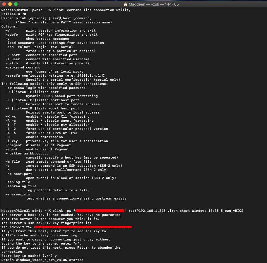

I got it  ... just need to enter "plink" in the cli instead of "putty" - the typical ?help information appeared :)
If I match your commands
plink -pw <unraid root password> root@<unraid IP> virsh start <Name of VM>
with my credentials .... magic happens :)
