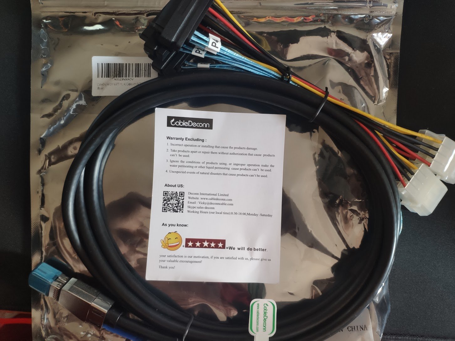

September 9, 20206 yr Author Ordered new cables, thanks. I hope I'll be able to try new card in couple of days (it's in shipping)
September 15, 20206 yr Author and still nothing... 1 cables are sas - sata, it can't be to long (I hope) but disks are not there new_cables_1_unraid-diagnostics-20200915-1525.zip 2 cables are sas-sas but are the same length as the first ones, drives are not there new_cables_2_unraid-diagnostics-20200915-2155.zip I'm running out of ideas

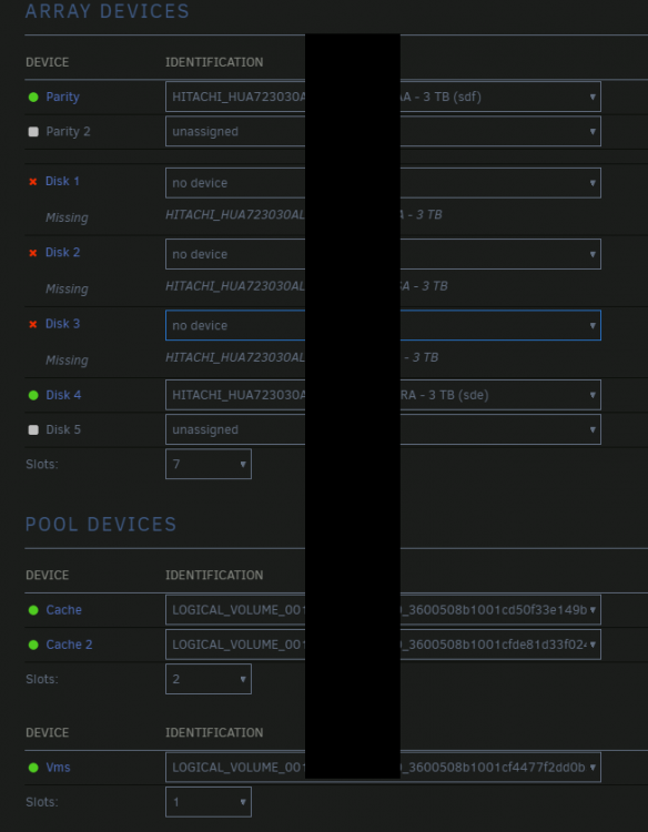

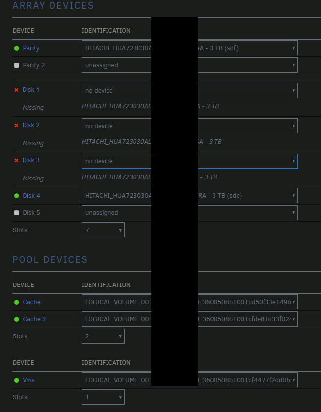

September 16, 20206 yr Author Only configuration I was able to make it work... both 9206 are not working, with sas to 4x sata and sas to 4x sas cables unraid-diagnostics-20200916-2144.zip
