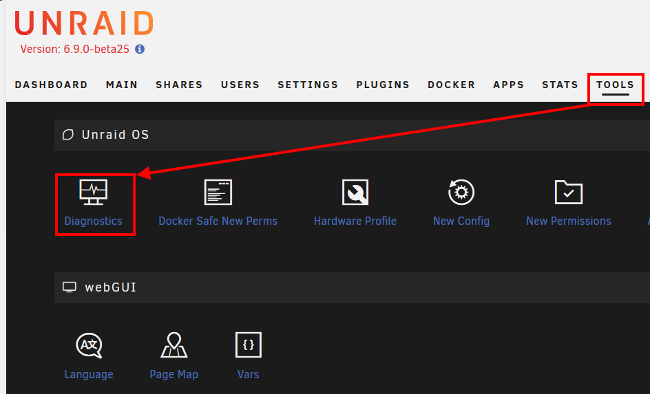

Tools -> Diagnostics then attach the complete zip.

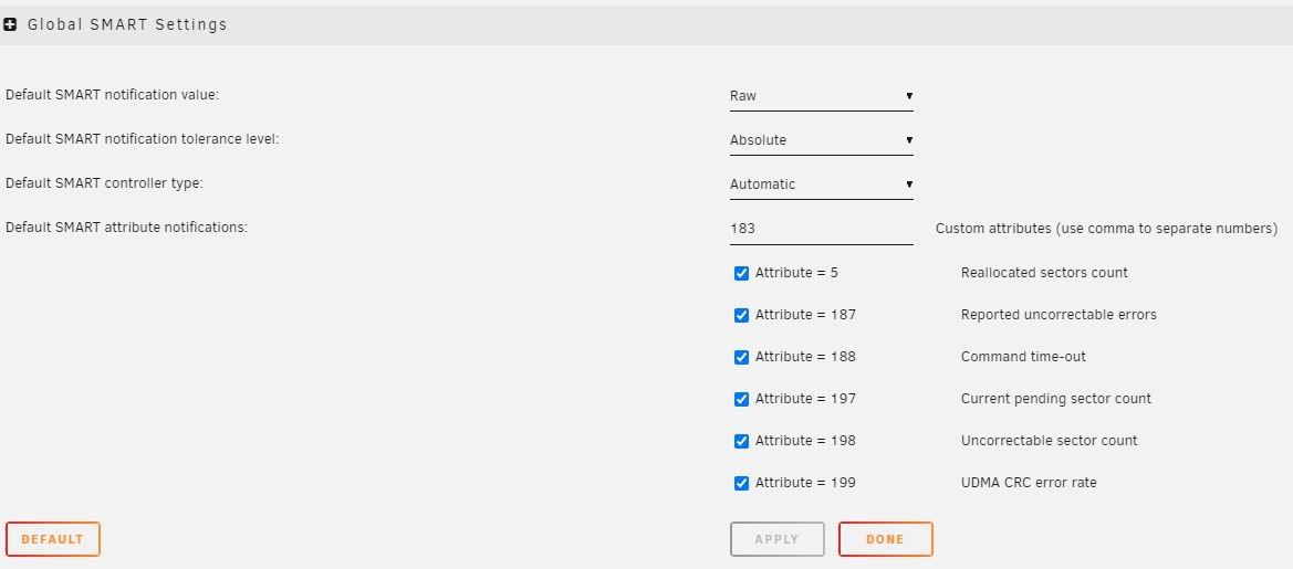

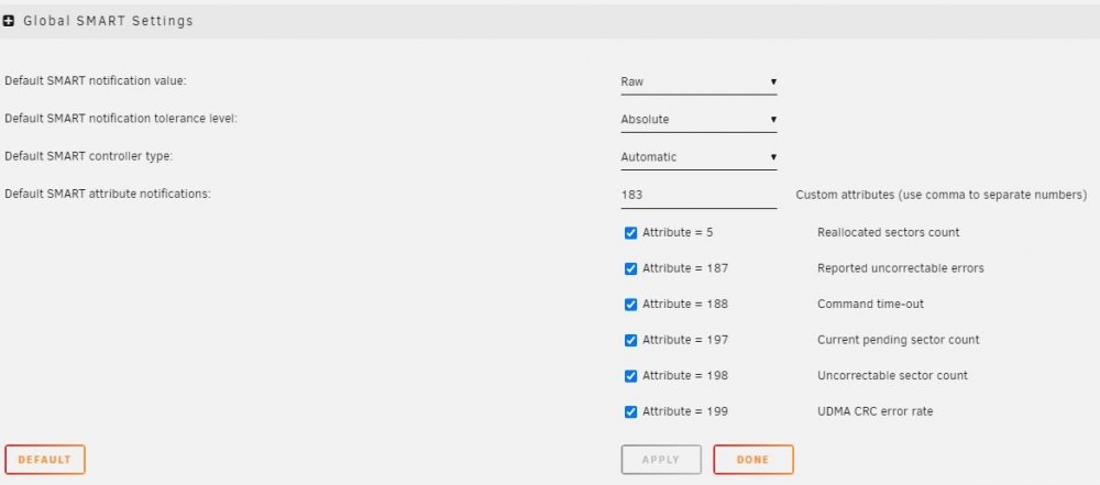

7 hours ago, SPOautos said:
orange thumbs down
The orange mark comes from the setting shown below. The global SMART settings under Settings/Disk settings allow to define what SMART values lead to this orange mark. 198 Offline_Uncorrectable belongs to them:
