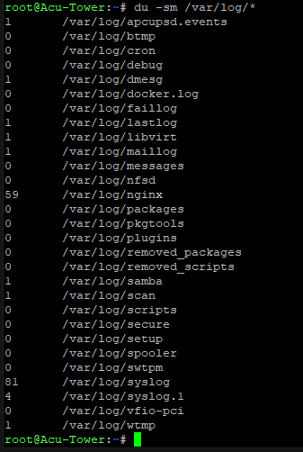

I have a problem with the log it always gets 100%.

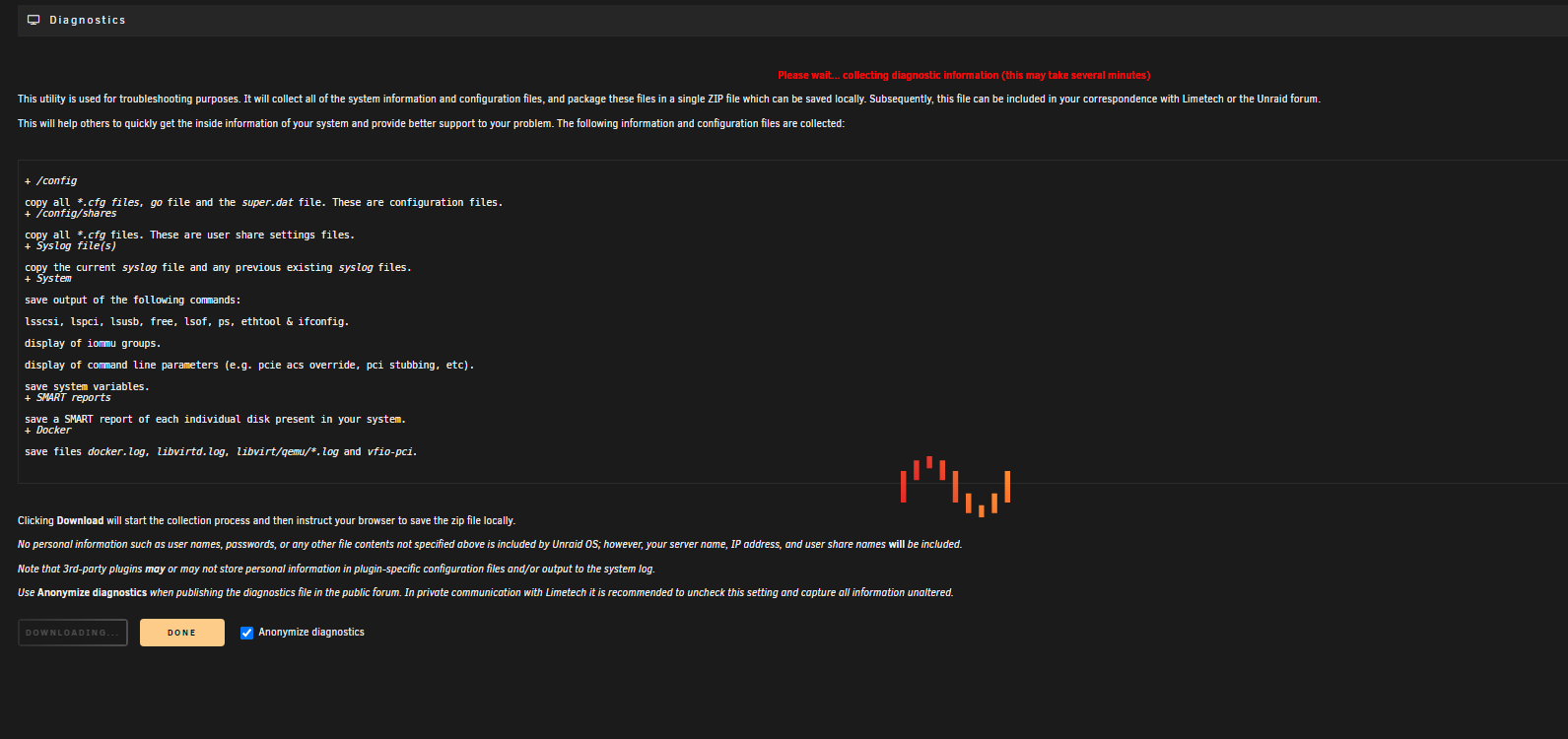

I tried to download the diagnostics, but even after a long time, nothing downloads.
I am sending a photo where the files are added:
/ var / log / nginx
/ var / log / syslog
From the terminal window, enter in
diagnostics
The zip file will get saved to the flash drive (logs folder).  The GUI has a limitation that any operation exceeding 120 seconds will fail.

Once the log starts to fill, the diagnostics cannot be downloaded.
What now?
I would suggest waiting a while to give the issue a chance to manifest itself and then try downloading the diagnostics before the log actually gets full.
Now I have 73% in the morning I tried at 43% and also failed to download the diagnostics
Get the diags on the console by typing "diagnostics"
It's nginx spamming the log, and I've seen it before, but no idea what causes it or the solution, does it do the same if you boot in safe mode?
I restart to safe mode and wait.
So far, the log has 1%, but mostly began to fill after a few hours
So even in safe mode the log is still growing.
At the moment I have 70% and started to grow around midnight.
Post new diags just to confirm it's the same issue.
Yep, it's nginx again, but like mentioned I have no idea what causes these, maybe someone else has.

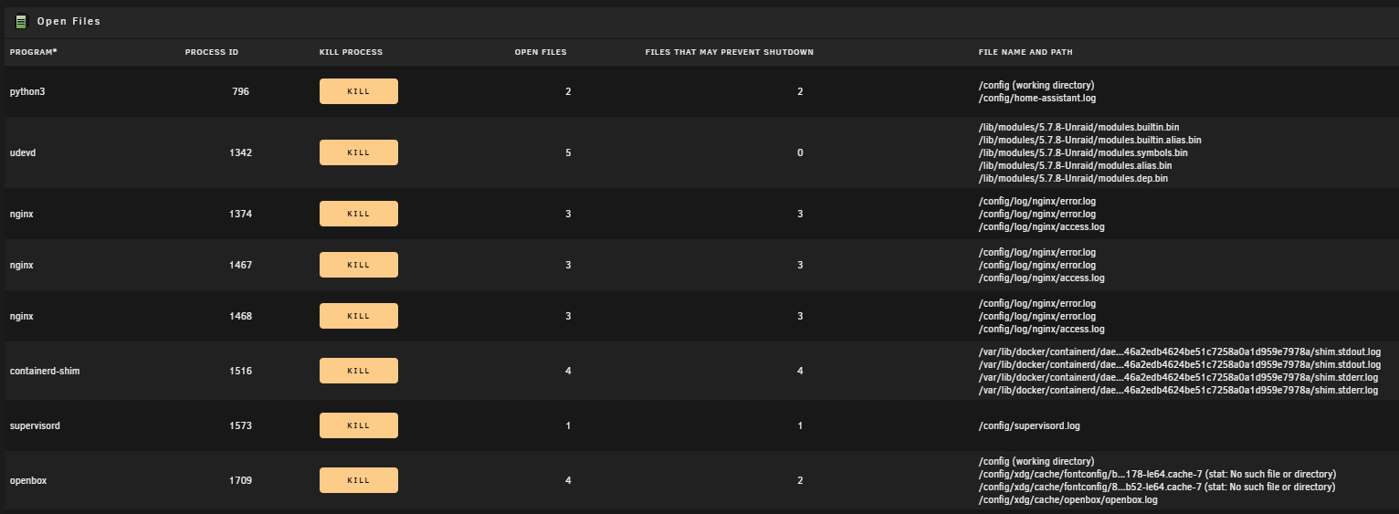

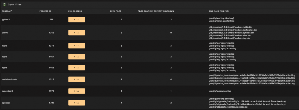

Am I still sending a photo from open files and nginx which is run three times?
