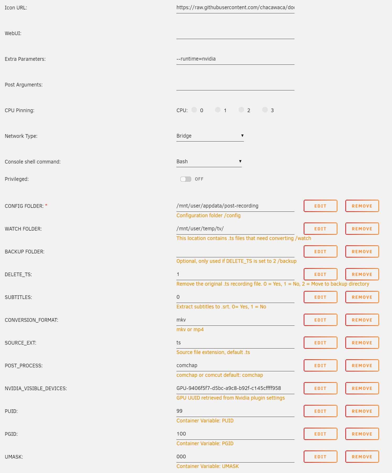

Hello,
after some weeks of waiting, I updated the container to the latest alpha build and tried again to convert a file with your docker container.
Because of the previous errors I removed the umlauts in the file name.
After a few seconds I get a "Conversion failed" error message without any exact reason why the conversion failed.
The ccextractor still seems to be running, after that it doesn't jump to the next point and comskip already has no logfile anymore.
My appdate-folder again in the attachment.
I don't know where I can start at the moment.
If you need more information or files, I will post it.

Do you have subtitles in your source file ?
"No captions were found in input." at the end of ccextractor log file.
Try to go to stable branch, and change subtitles to 1.
i use the exact same setup the only thing that isnt the same is our source file.

Did that, appdata attached.

Stream mapping:
  Stream #0:0 (h264_cuvid) -> hwdownload
  format -> Stream #0:0 (hevc_nvenc)
  Stream #0:1 -> #0:1 (copy)
  Stream #0:5 -> #0:2 (? (?) -> ass (ssa))
Decoder (codec dvb_teletext) not found for input stream #0:5
your ffmpeg command dont fit with your source file, im not a ffmpeg expert i cant help you more, sorry

I used the nvidia-hq preset, I don't know why it does not fit.
I will have a look on it. But could you say, where to find the error message?
post-recording\log\ffmpeg
at the end of this log file
