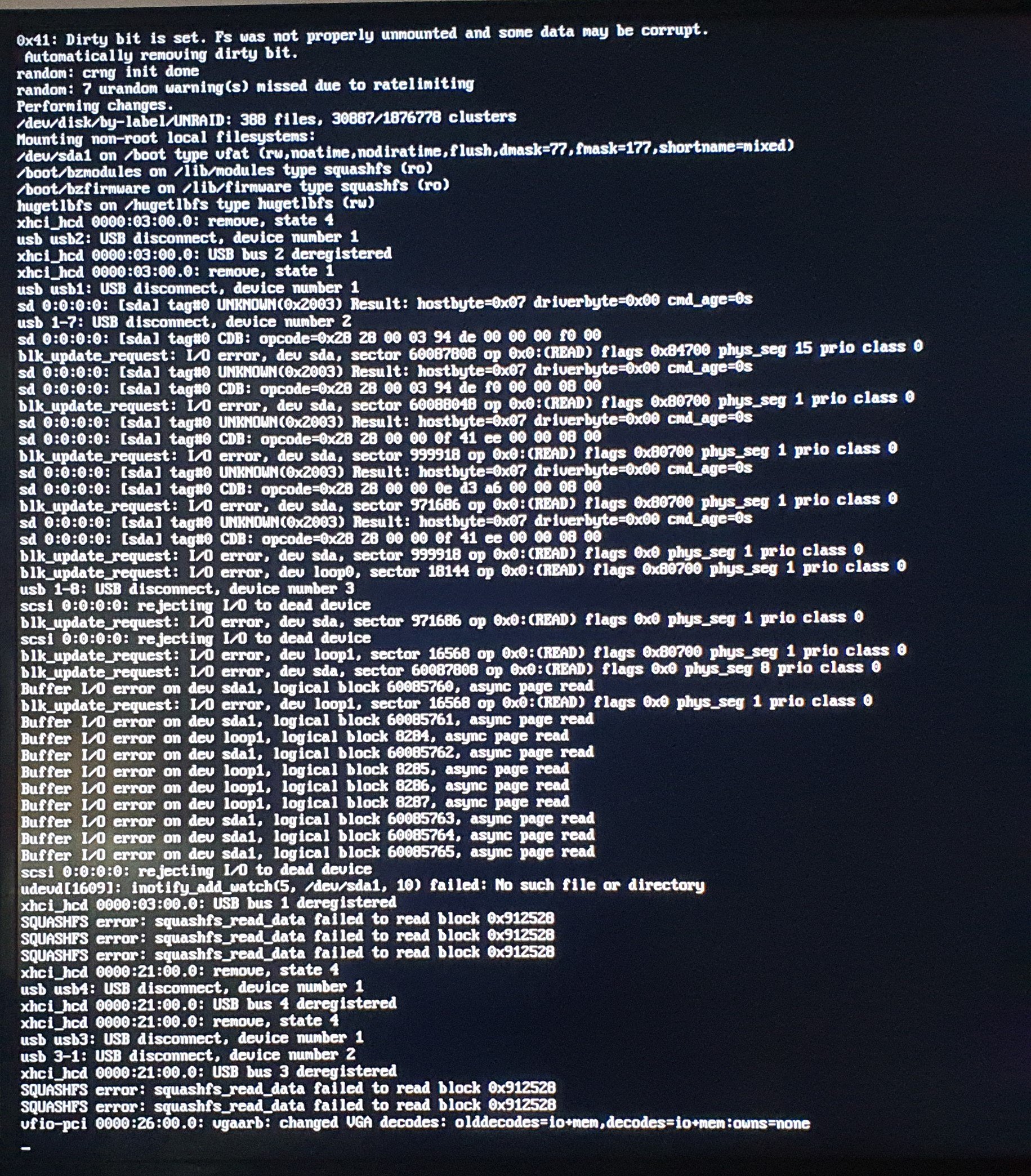

I had been using the VFIO-PCI Config plugin to remap some of my IOMMU groups to make the passthrough easier and as the current config was giving me problems I decided to switch the mode from "both" back to "downstream".
I did this - rebooted the server and then that was it... I can't get it to boot in normal mode, GUI mode, safe mode with GUI, or safe mode (no plugins no gui)....I'm kind of at a loss as to what to try from here. Everything was fine up untill that reboot, no indication of prior issues.
Attaching a screenshot of the boot screen that I get to from booting in safe mode (no plugins no gui).
