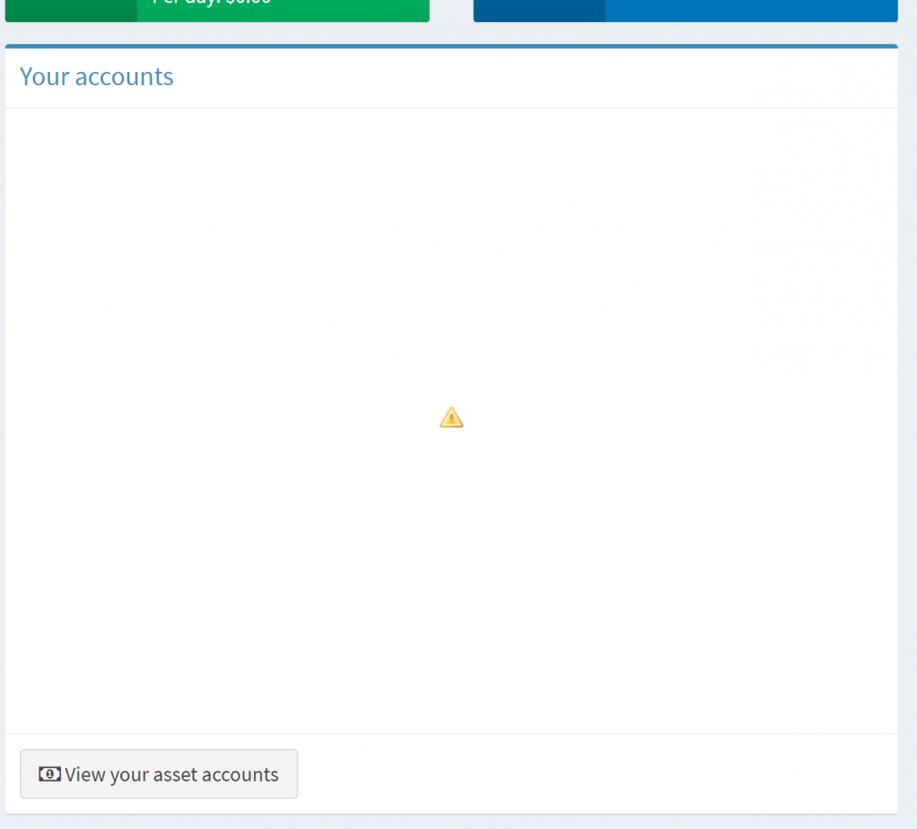

  • d3fc0n0wltraps
    d3fc0n0wltraps

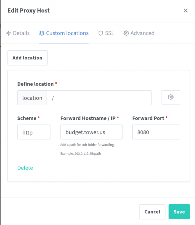

    Have you had any luck finding a solution? I'm having a similar issue since the update. I'm using nginx proxy manager and when I don't give it :8080 after the reverse proxied URL I get failure to rende

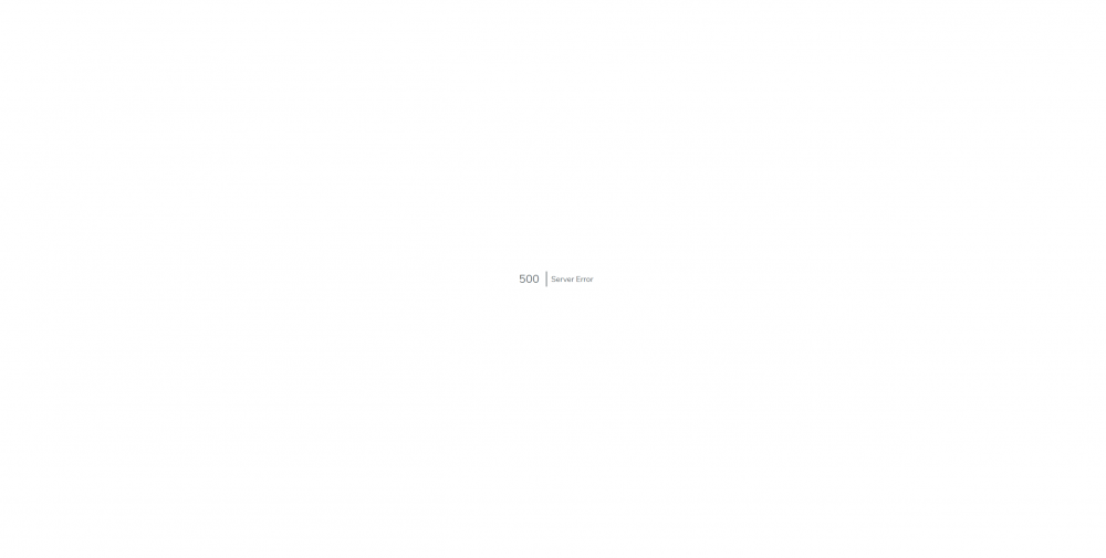

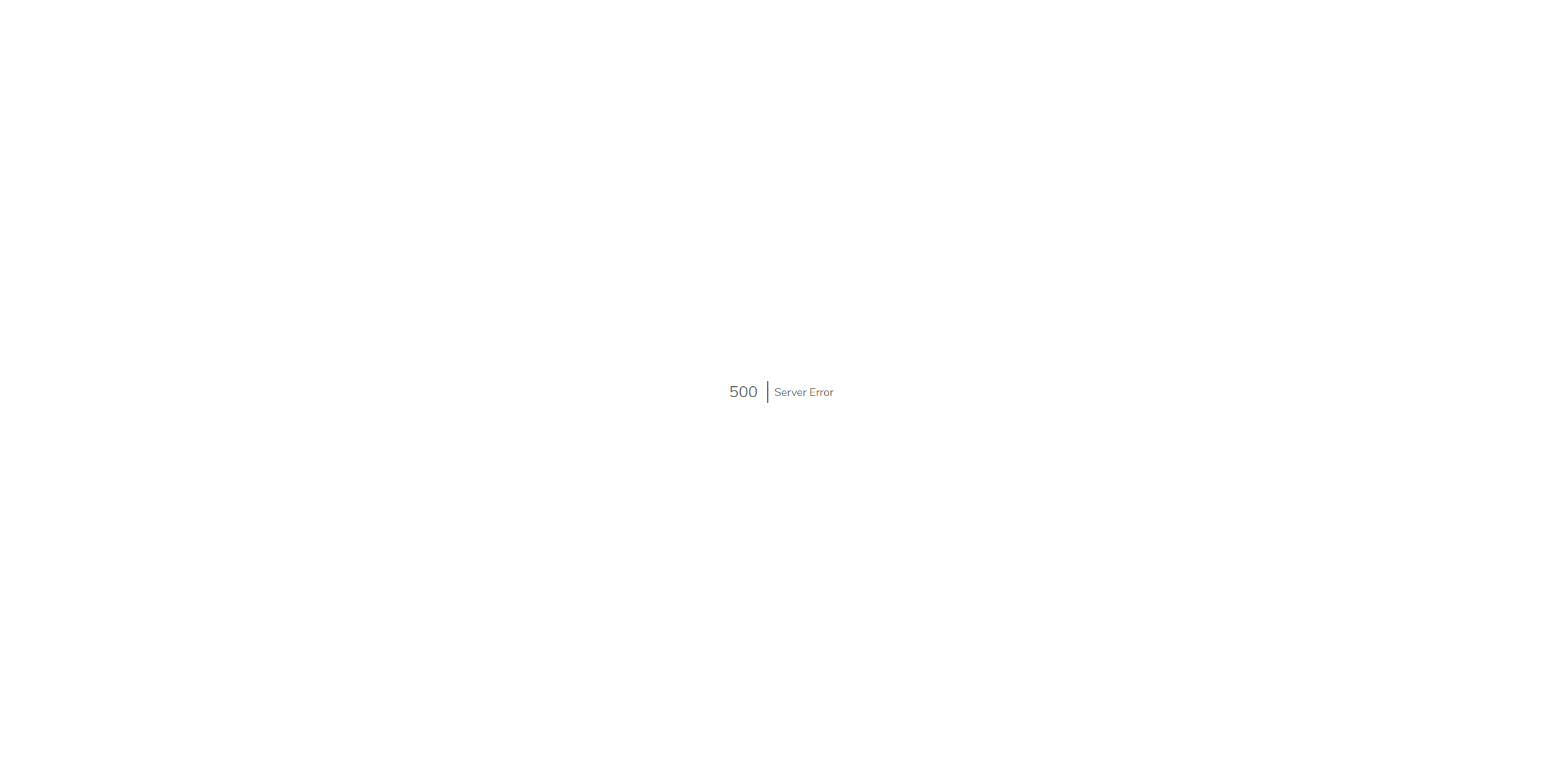

Hi I am having trouble with the Firefly-III-ynab-Importer. I set everything up and every time I click to open the web ui I get this.
@krabbyboy Like in the Firefly-III container, you also need to set the APP_KEY environment variable in the ynab importer. For some reason they didn't include that in the documentation.
Edit: No longer needed in ynab-importer 2.0.3

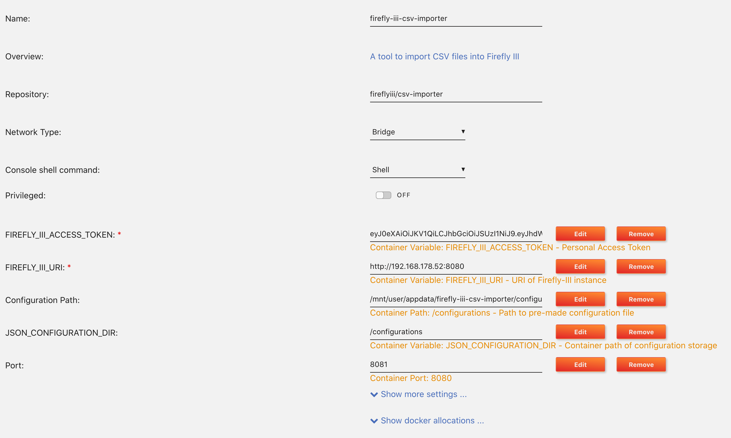

Hi! I am having trouble setting up the CSV Importer. No matter which FIREFLY_III_URI I set, it is not being used in the container. When starting the WEBUI, i get this error message:
Tried "http://192.168.0.10:8080/api/v1/about" 5 times but failed: cURL error 28: Connection timed out after 31415 milliseconds (see https://curl.haxx.se/libcurl/c/libcurl-errors.html) for http://192.168.0.10:8080/api/v1/about
Any ideas?
@meinnamehier I assume Firefly doesn't run on port 8080?
What did you set FIREFLY_III_URI to, can you send a screenshot of your config?
It could also be that you have tried to install the CSV Importer multiple times and are now stuck with multiple templates. Check if /boot/config/plugins/dockerMan/templates-user lists more than one CSV Importer and if so, you can remove the template that you don't want.
Yes, i tried installing several times; I used the  "CA Cleanup AppData" plugin and manually erased files in appdata/ inbetween. I checked the folder you mentioned, but there is only one CSV importer listed there.

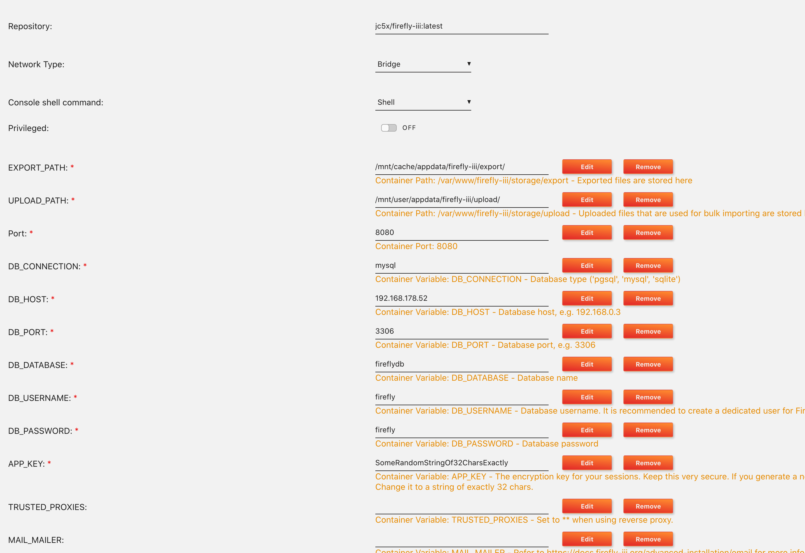

Attached you can find the screenshot of the configs for FireflyIII and the CSV importer.
Thanks for your help!

Hm, I have only ever experienced this behaviour when I had duplicate containers that were using different templates.
Go to the console of the CSV importer and execute printenv, that shows you the environment variables of the container. Does the variable FIREFLY_III_ACCESS_TOKEN show up? Is the FIREFLY_III_URI correct?
Edited by FunnyPocketBook
Yes, the token is present and this also: FIREFLY_III_URI=http://192.168.178.52:8080
It appears that the Firefly-III CSV Importer saves the URI somewhere internally and doesn't look at the environment variable anymore once it's set. When I changed the URI to something invalid, it still pointed to the old, correct URI.
In the CSV Importer WebUI, have you already clicked "Reauthenticate"? Clicking that fixed the issue for me.
