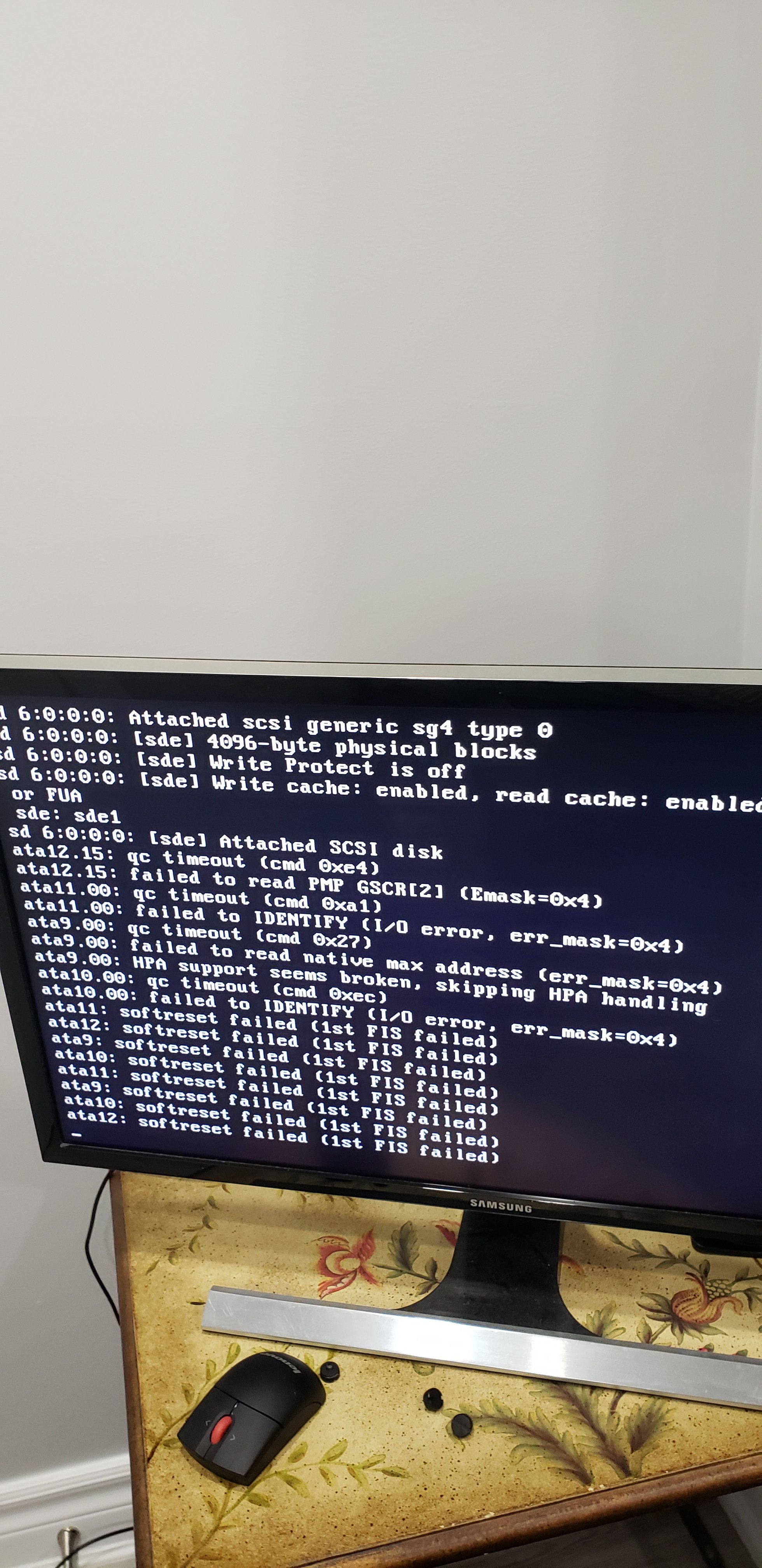

I rebuilt/cleaned my computer today cause I got a more fitting case. Once I booted I noticed the usual splash screen id get from the Sata controller didn't show and now my server doesn't see any of the drives I have connected to it. Its reading the four I have connected to my motherboard.
I've read a popular post that suggested that Marvell controllers have common issue which is solved by disabling csm but that has not worked for me. Any help would be appreciated!

Thank you for the reply.  Funny enough, I felt that my sata card wasn't seated right in this new case for some reason.  But surely it must be seated / working if the blue LED is on.  Also in my System device I've got this. Unless.. thats my motherboard ports but I'm terribly lost
04:00.0 SATA controller: Marvell Technology Group Ltd. Device 9215 (rev 11)
EDIT: For reference my Motherboard is the B450M Pro4 and its on the top slot while the bottom two are my graphics cards
