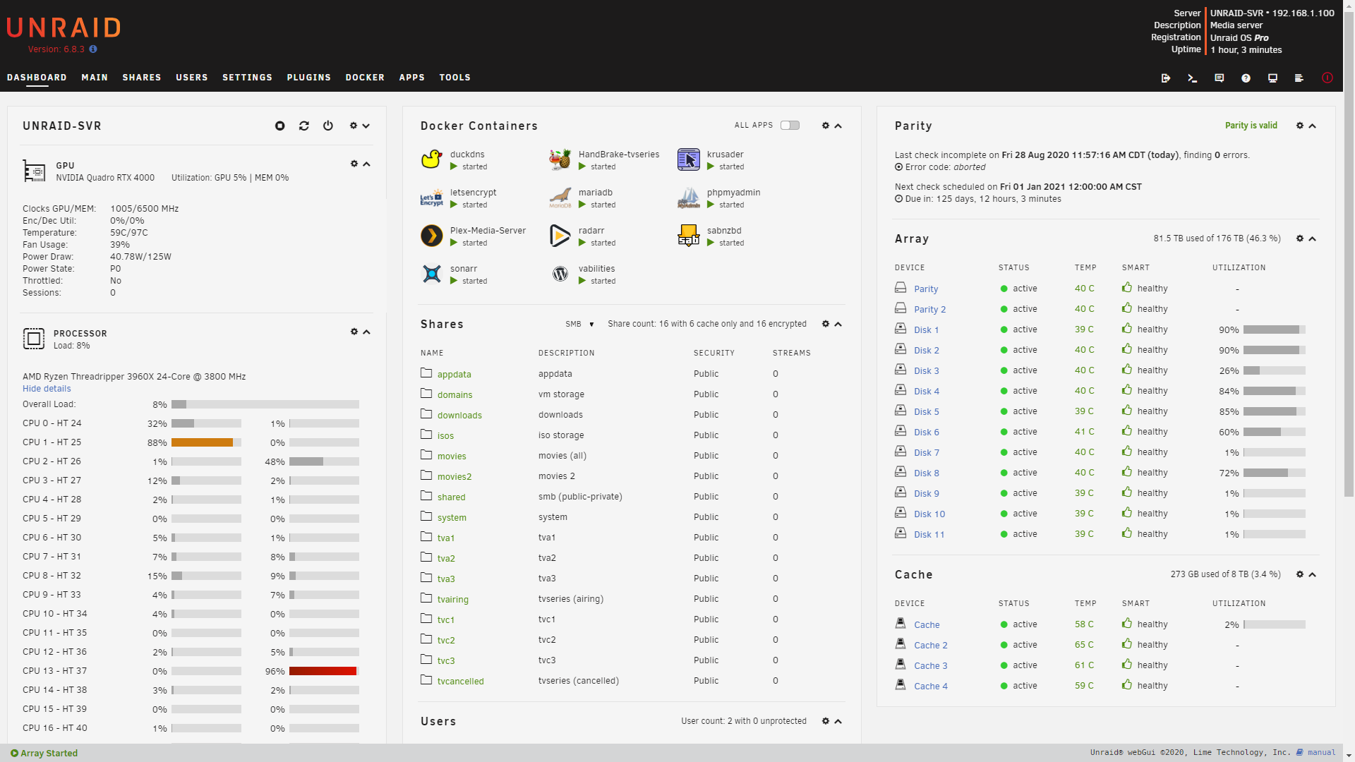

Specs:
TRipper 3960x 24/48
256GB DDR4
Parity: 2- 16TB Seagate Exos
Array: 11- 16TB Seagate Exos
Cache: 4- 2TB Firecuda 520 Raid0 -8tb
GPU0: RTX 4000
GPU1: RADEON PRO W5700

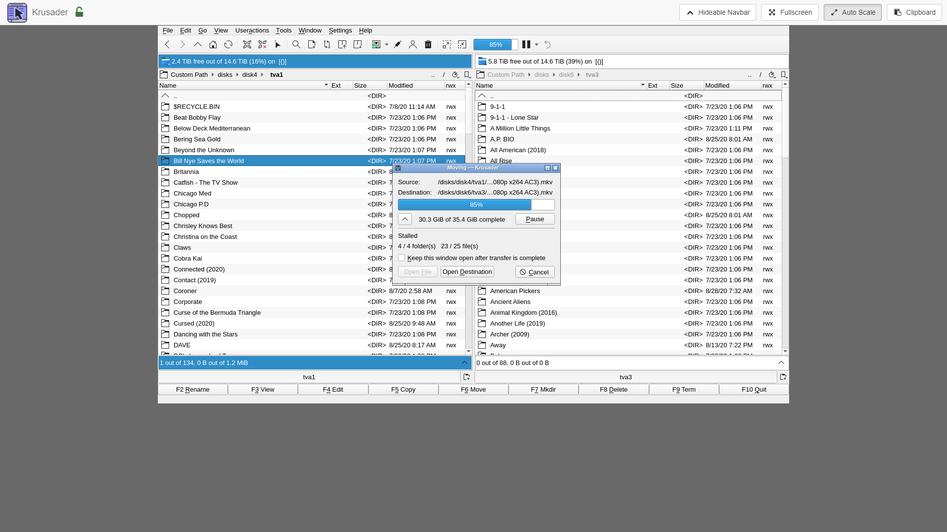

I am trying to move files from one hard drive to the other and it works for like 10 to 25gb and then Krusader says "stalled".
I have even tried creating a VM with virtio everything enabled, with Redhat LAN showing 100gb/s and itll start at 250mb/s and then go back to 30mb/s occasionally it will go to 200 again and then stay at 30mb/s for like 80% of the time. To transfer 100gb it starts at saying 7 minutes and then sometime after 10gb to 25gb it slows down, and it changes the estimated time to 1 1/2 hours, and then shows stalled as the message in Krusader.

Now that the data is on the drives UNRAID itself works. Sonarr/Radarr/Sab/Plex/Handbrake all work. No issues with speed. Its only when I want to physically move the data around.
