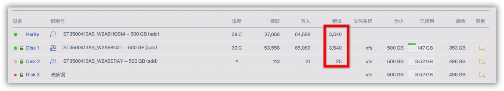

Recently, I find that when I copy big file (like 4G+) via SMB, about 10 minutes later , it failed to write. I open the control panel and find the error is rising fastly.
I have tried many ways to restore to normal (like spin up/down), but they all failed. And I can't halt or reboot it gracefully! If I reboot the computer violently, it restores to normal. If I try the same thing, I will get the same result.
