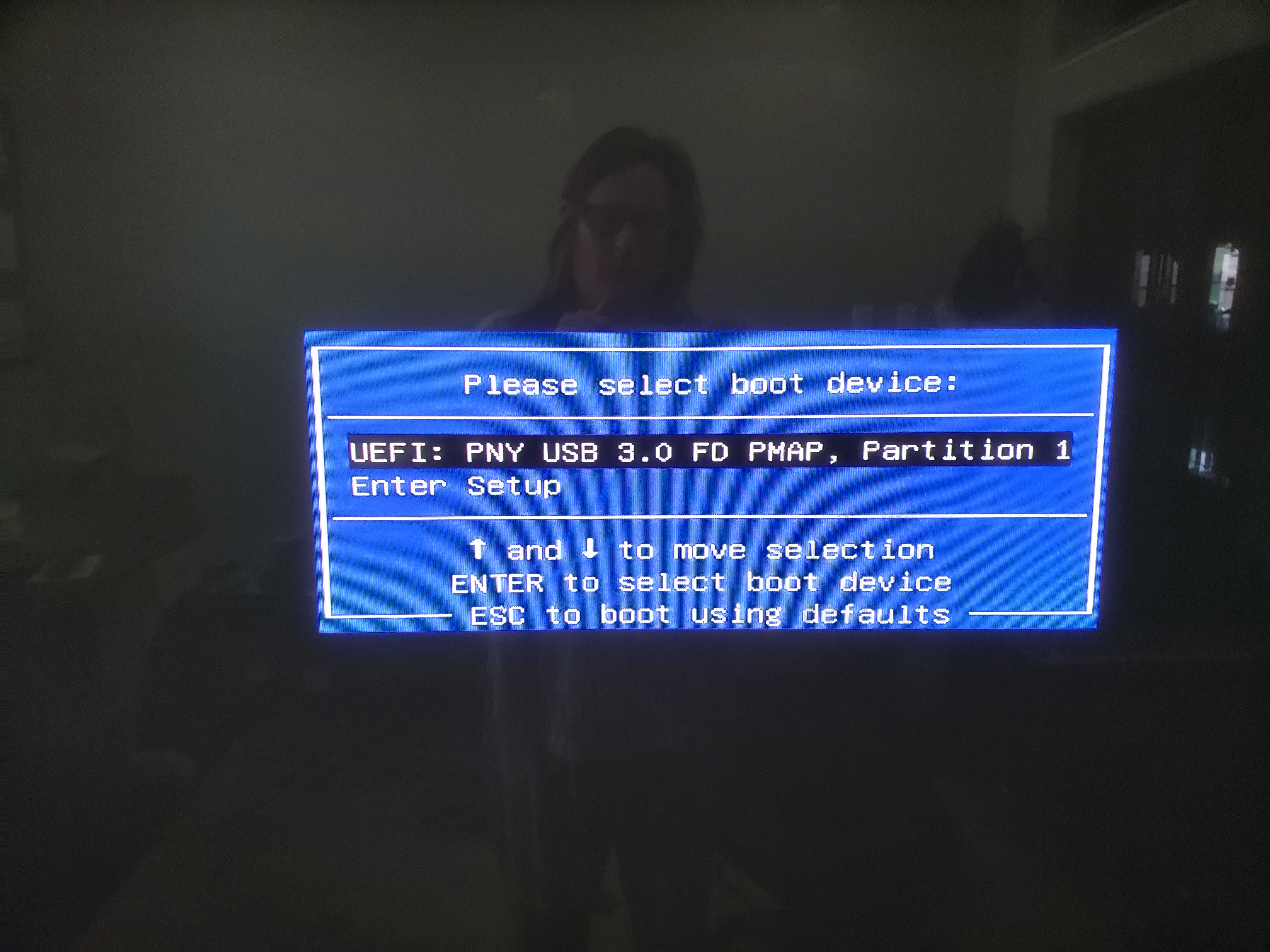

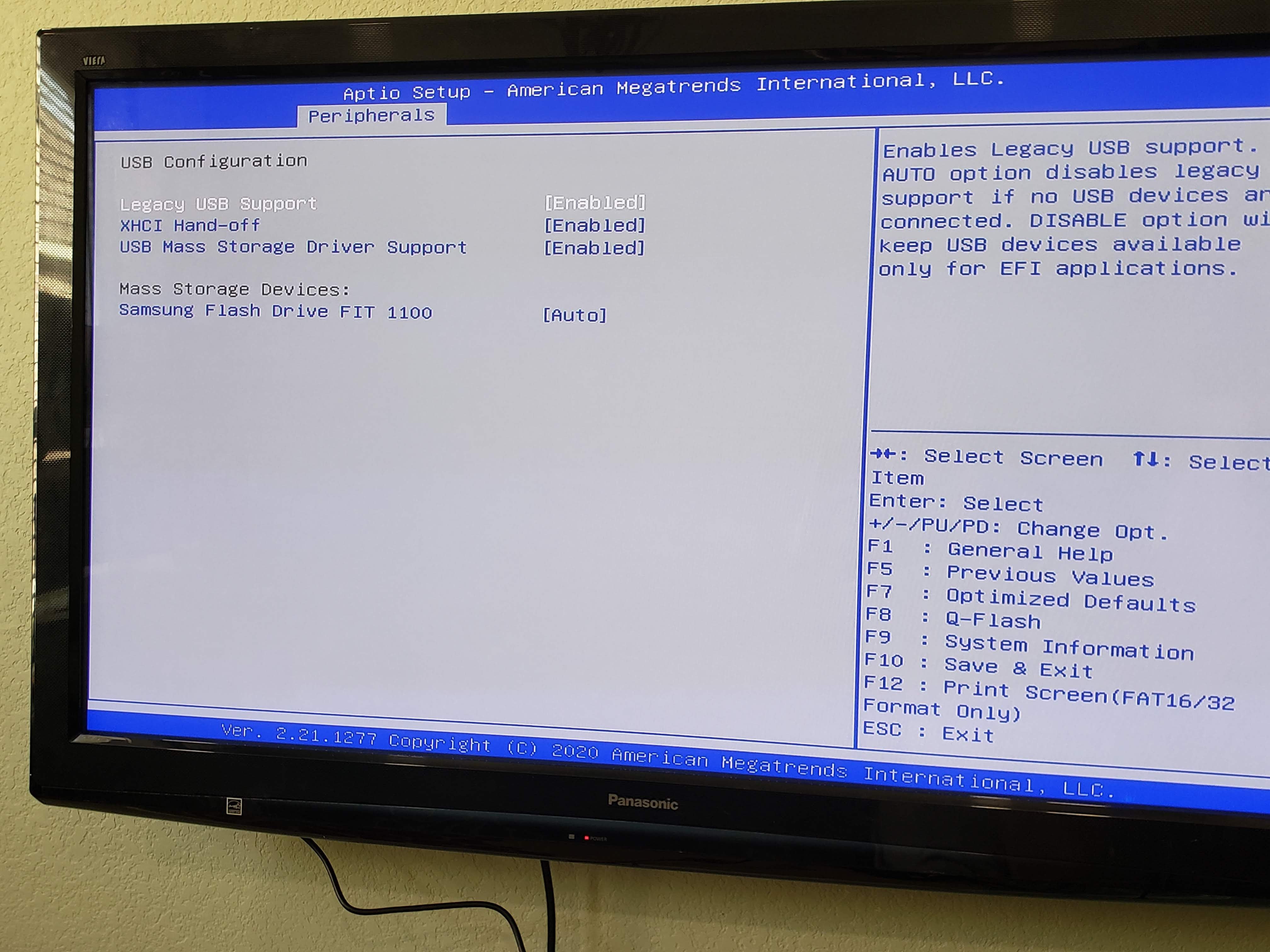

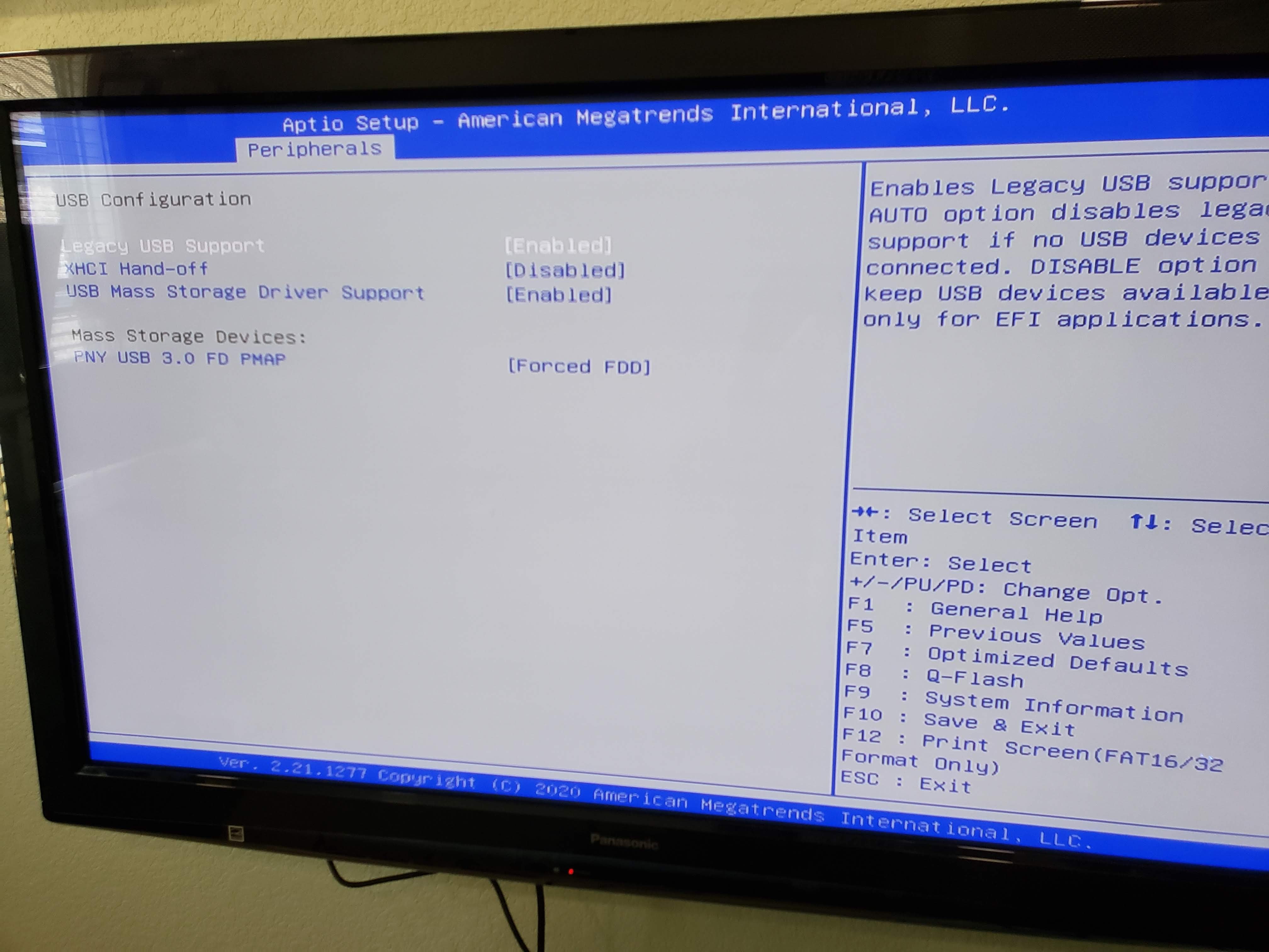

When creating the USB drive using the automatic method on a PNY USB 3 drive, it shows up as UEFI (see attached image) If I do nothin at the POST screen it will either reloop back around to the POST screen or boot into Windows 10 instead. If I choose BOOT ORDER (F9) it will only show me the USB drive, that is the first image below. I choose it and it goes right back into the same loop. I have no idea what I am doing wrong. I really need help getting this issue resolved. I am posting images of the BIOS options for the Gigabyte W480 Vision W so that someone might see something I am missing. Also, I use Run as Administrator to create the bootble option for the drive with the .bat file. I did this on my laptop, my workstation and even on the server I am using while booted into Windows. I still get the same exact problem. If I can resolve the problems and magage to actually get into Unraid, will it be a big deal to change whatever needs to be changed when I switch from the free trial to the paid license? I just hate spending money on something that may or may not work. A big reason I want to use Unraid is for Plex. I have never used Plex or Unraid, this is all new to me. I ended up choosing to use Unraid due to the high number of recomendations from the Plex forums. I am very familiar with Windows and would like to use Windows as much as possible. How do I use Unraid and Windows together. Do I have to run Windows in a VM in Unraid or can Unraid work with Windows? I need someone to hold my hand and walk me through this process as I am extremly frustrated by everything so far. I really appreciate the help.

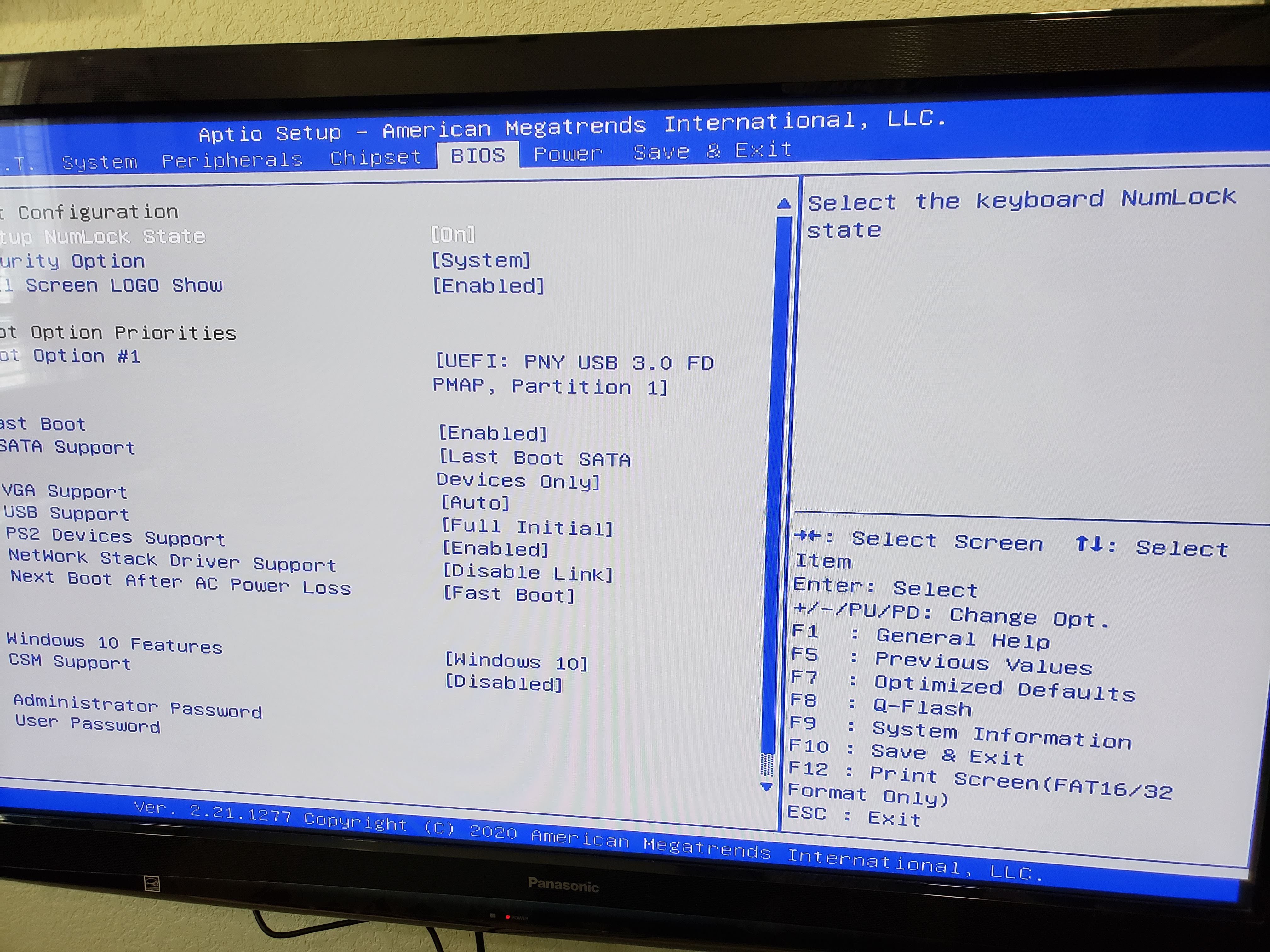

As for the BIOS, probably makes no difference but where it said you're using the USB as a Forced FDD (floppy), see if you can change that to USB/HDD.  And in the second to last image where it says CSM Support, set that to Enabled and then see if there's any new options to change.  CSM Support is related to UEFI booting.

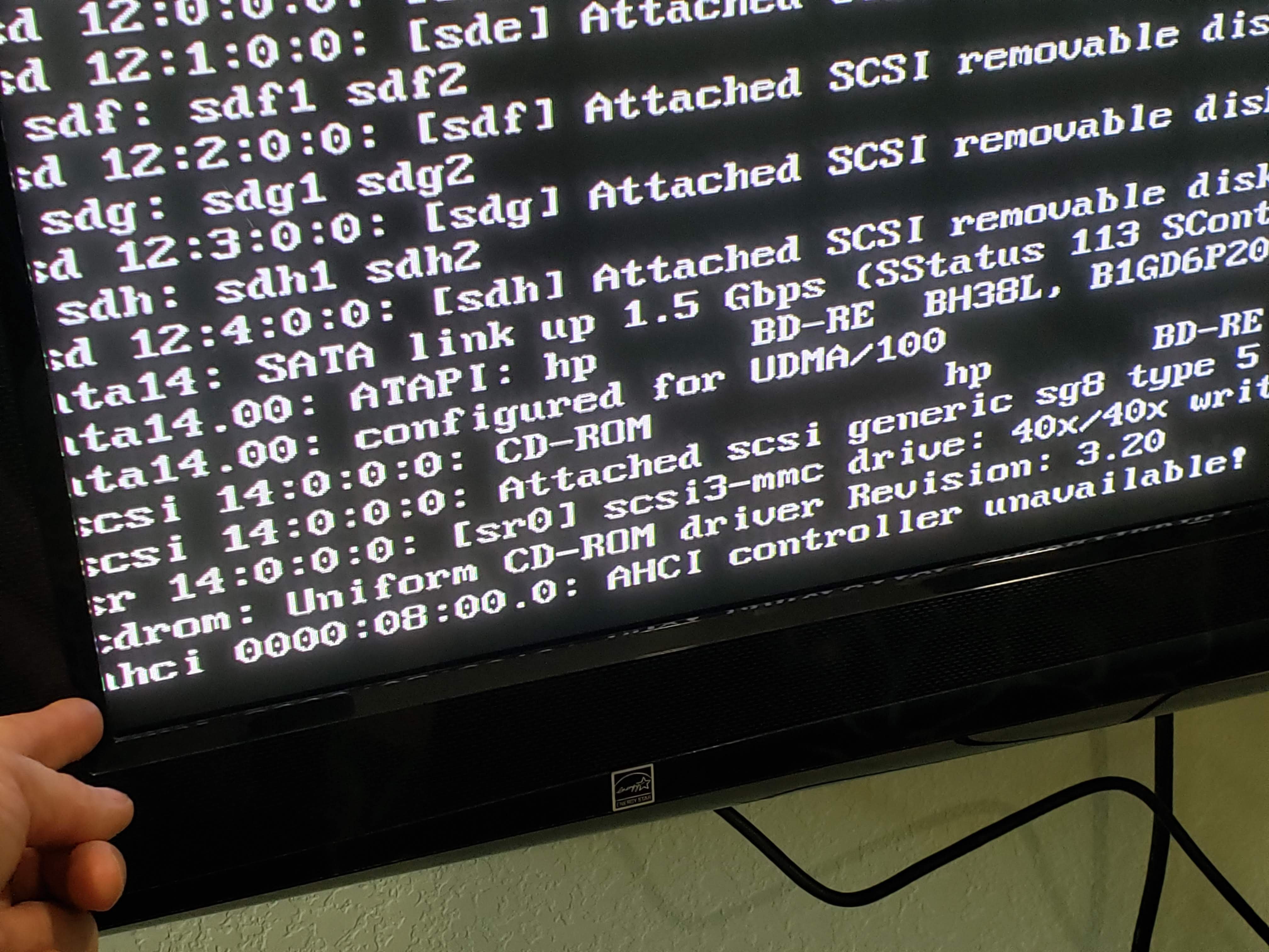

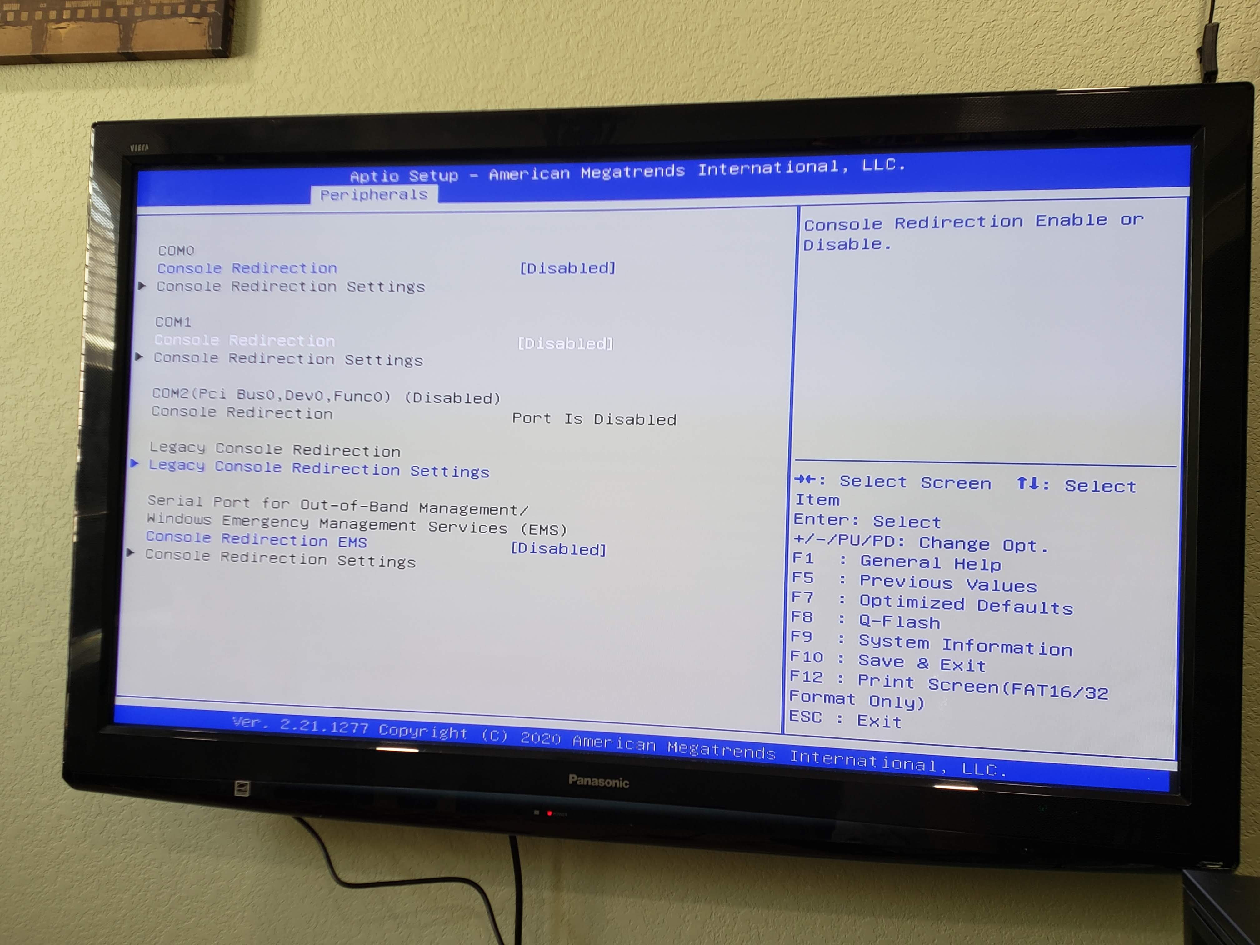

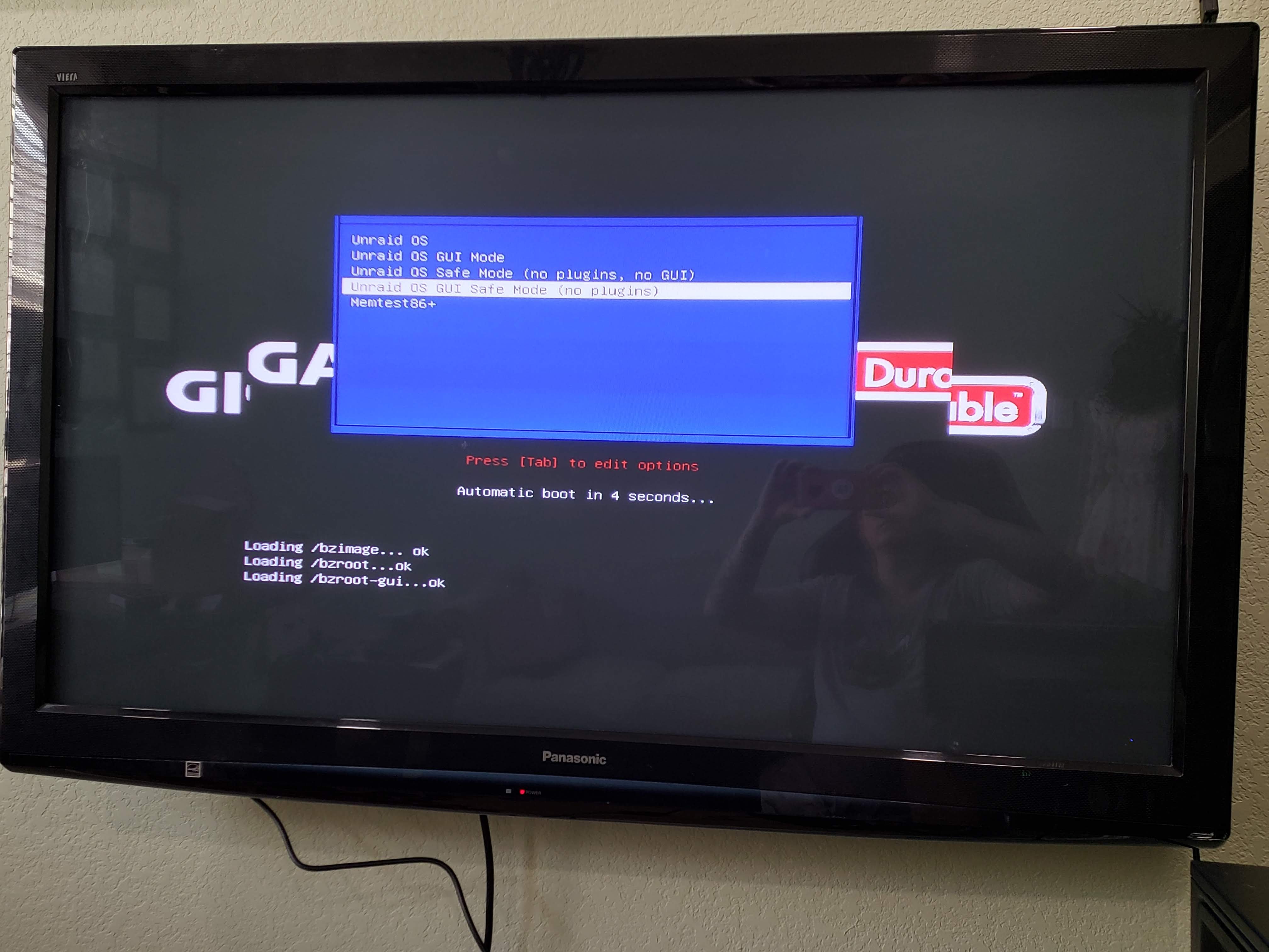

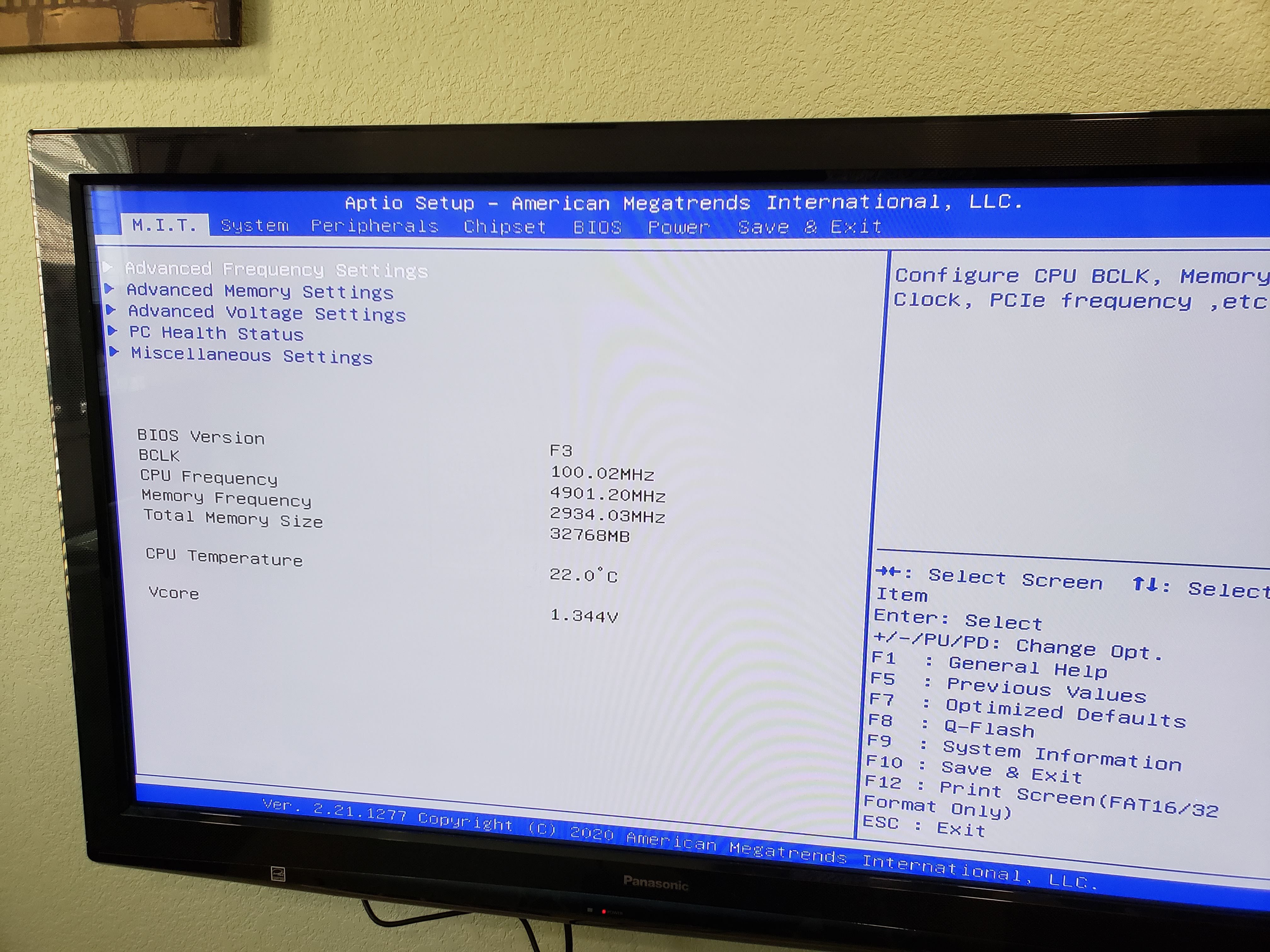

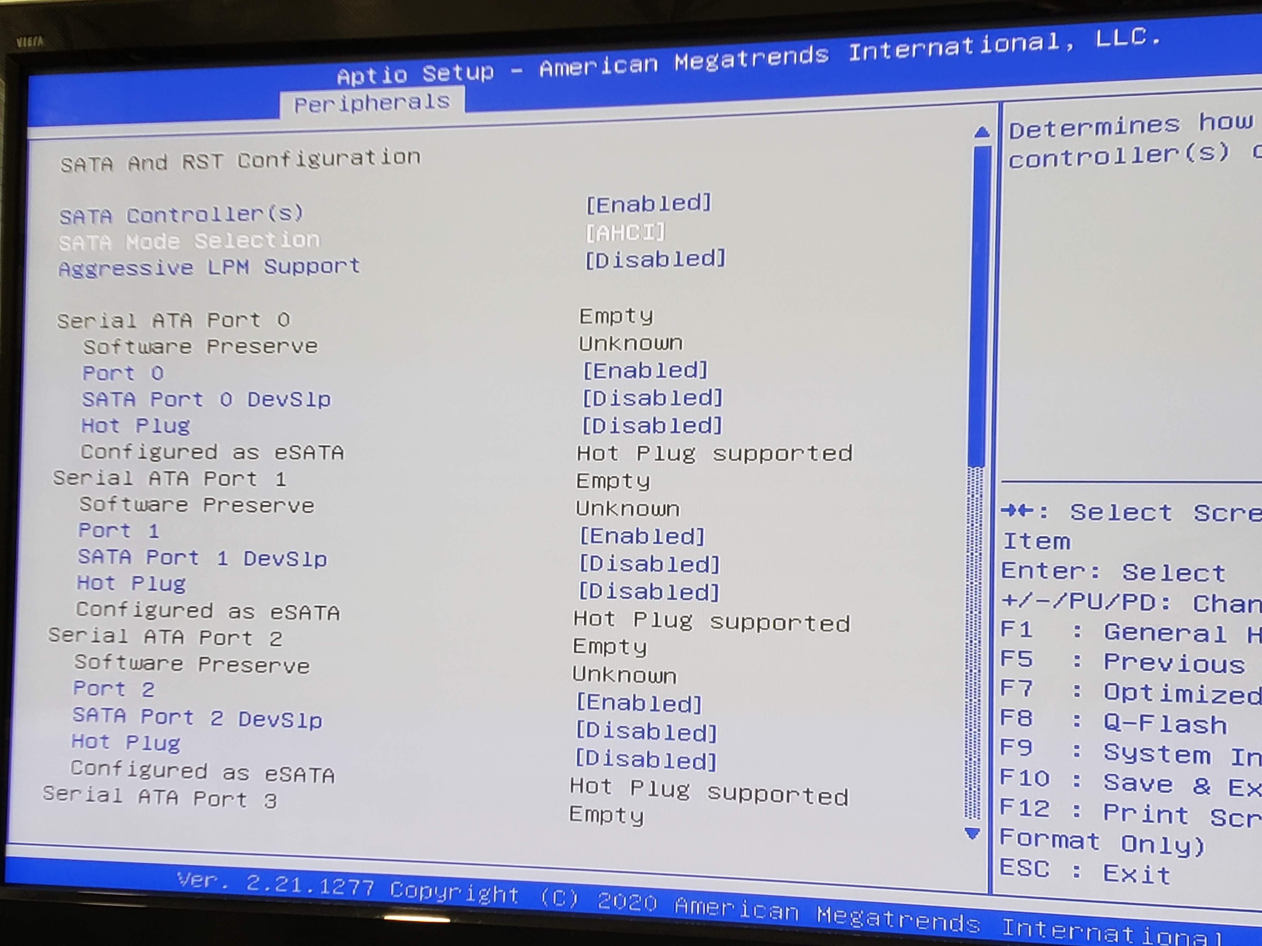

    I was finally able to get Unraid to boot…YAY!!!...and then…………. “ACHI Controller Unavailable” See 1st image below. I went back into BIOS and tried making changes that I found on various websites talking about this issue. Nothing has worked so far. I disabled VT-d Virtualization as recommended, this did not change anything.

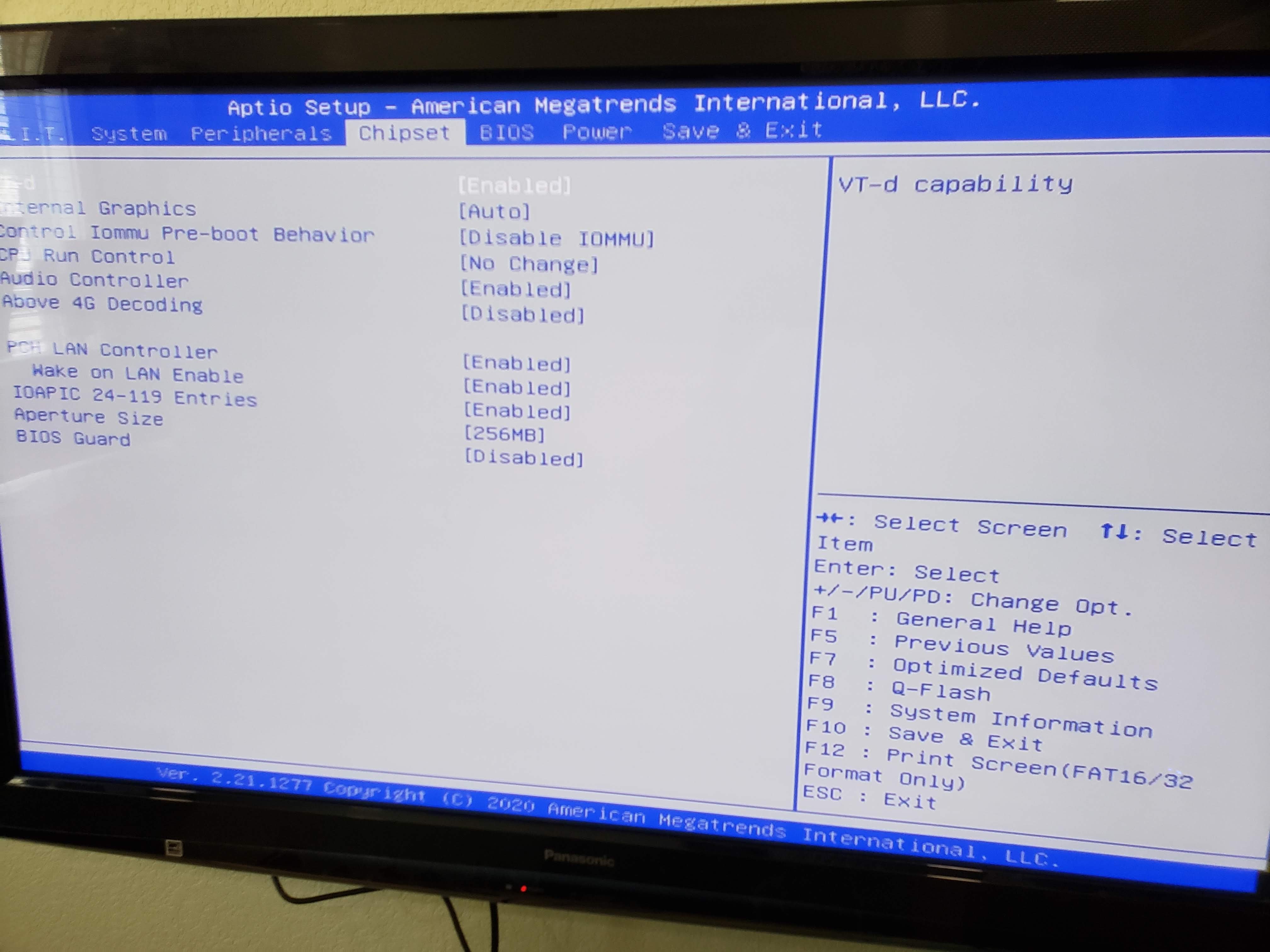

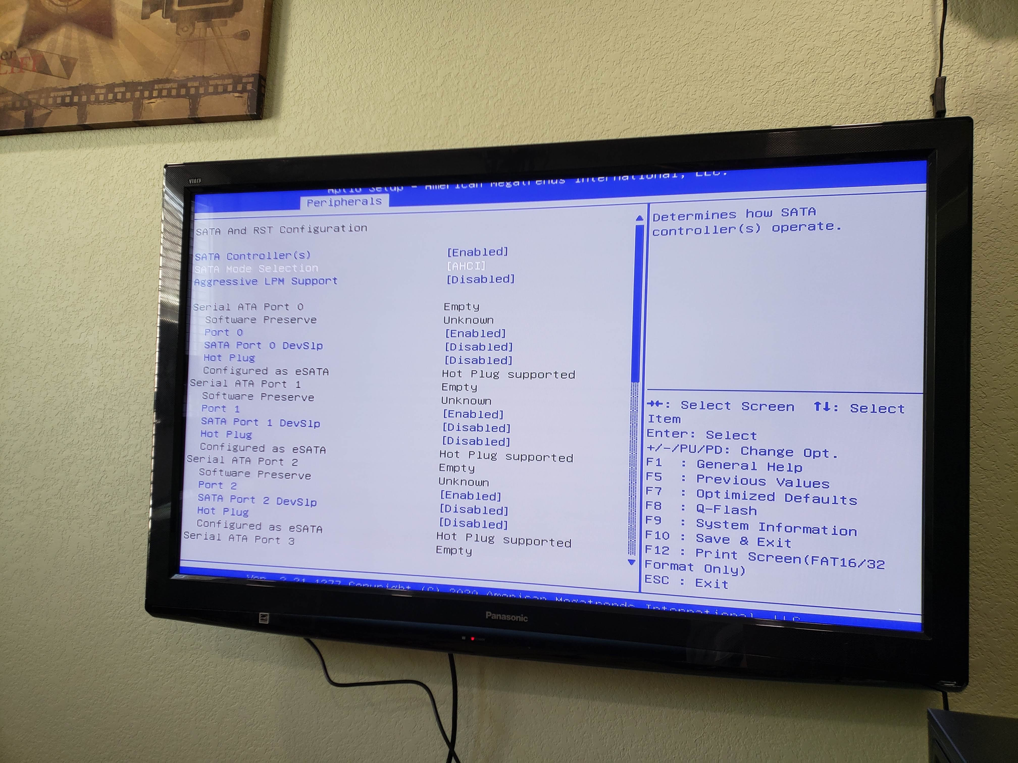

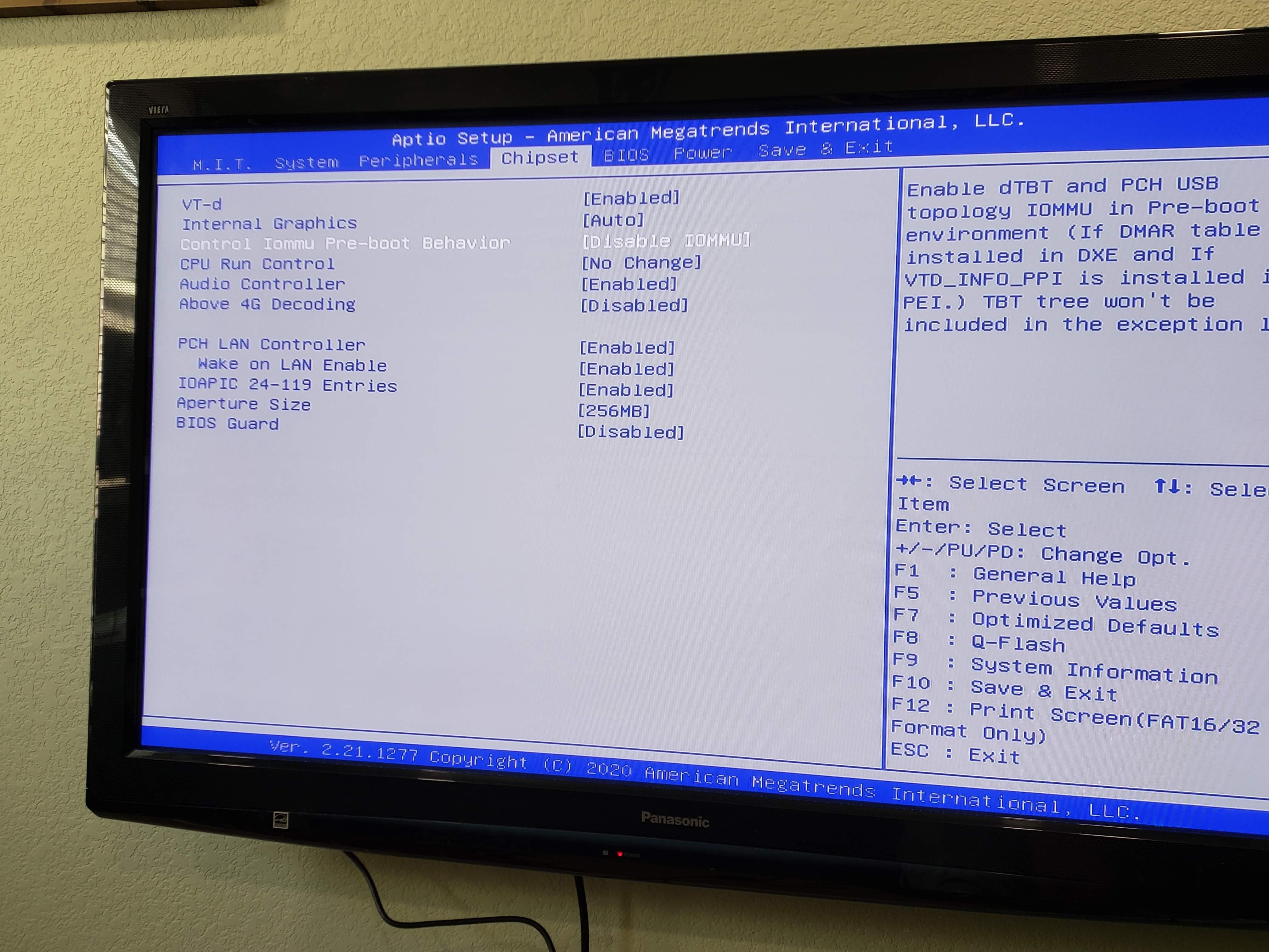

    I disabled IOMMU, see image below. Again, this did not help. I am not using the onboard SATA ports, for any drives, except for the DVD writer. I set the SATA Mode Selection to ACHI, as seen in the next image.

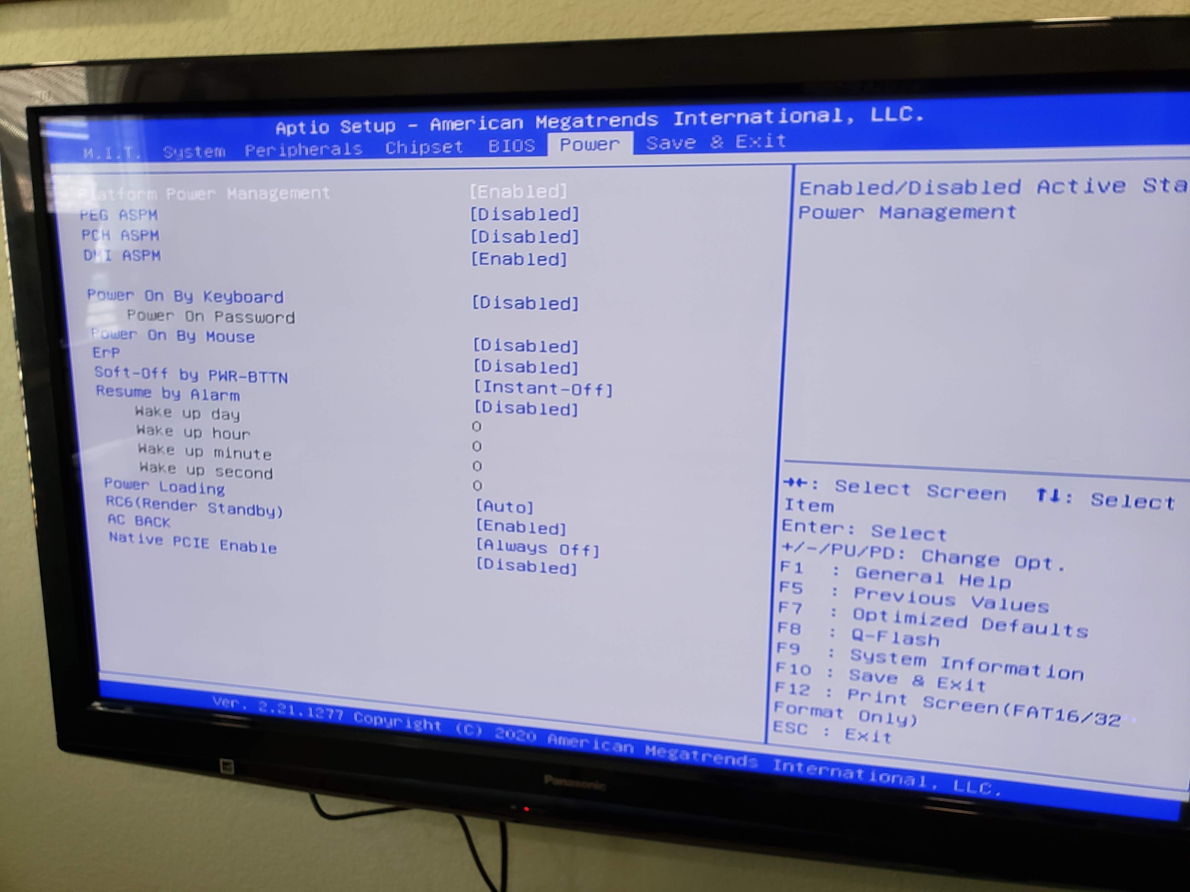

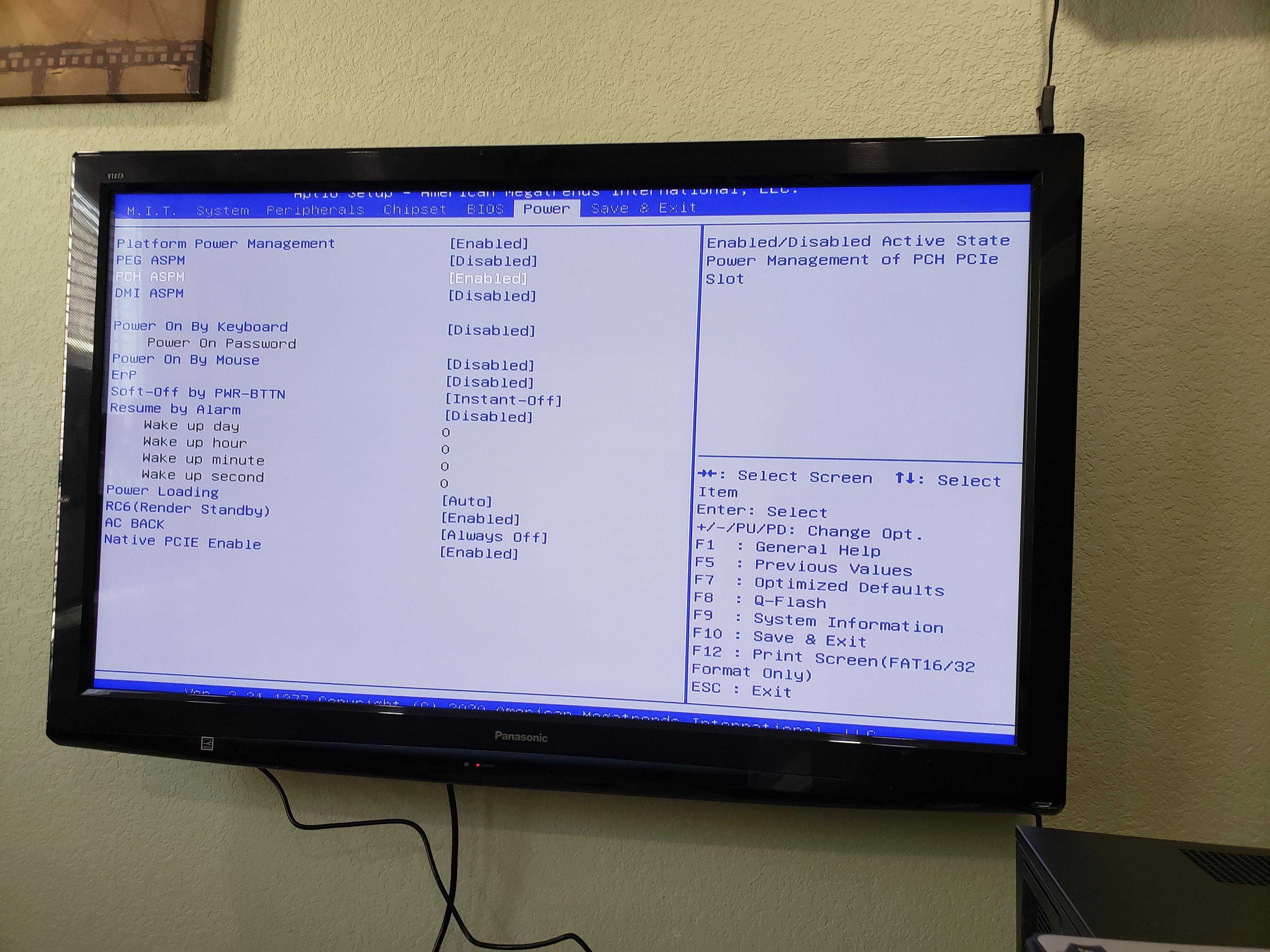

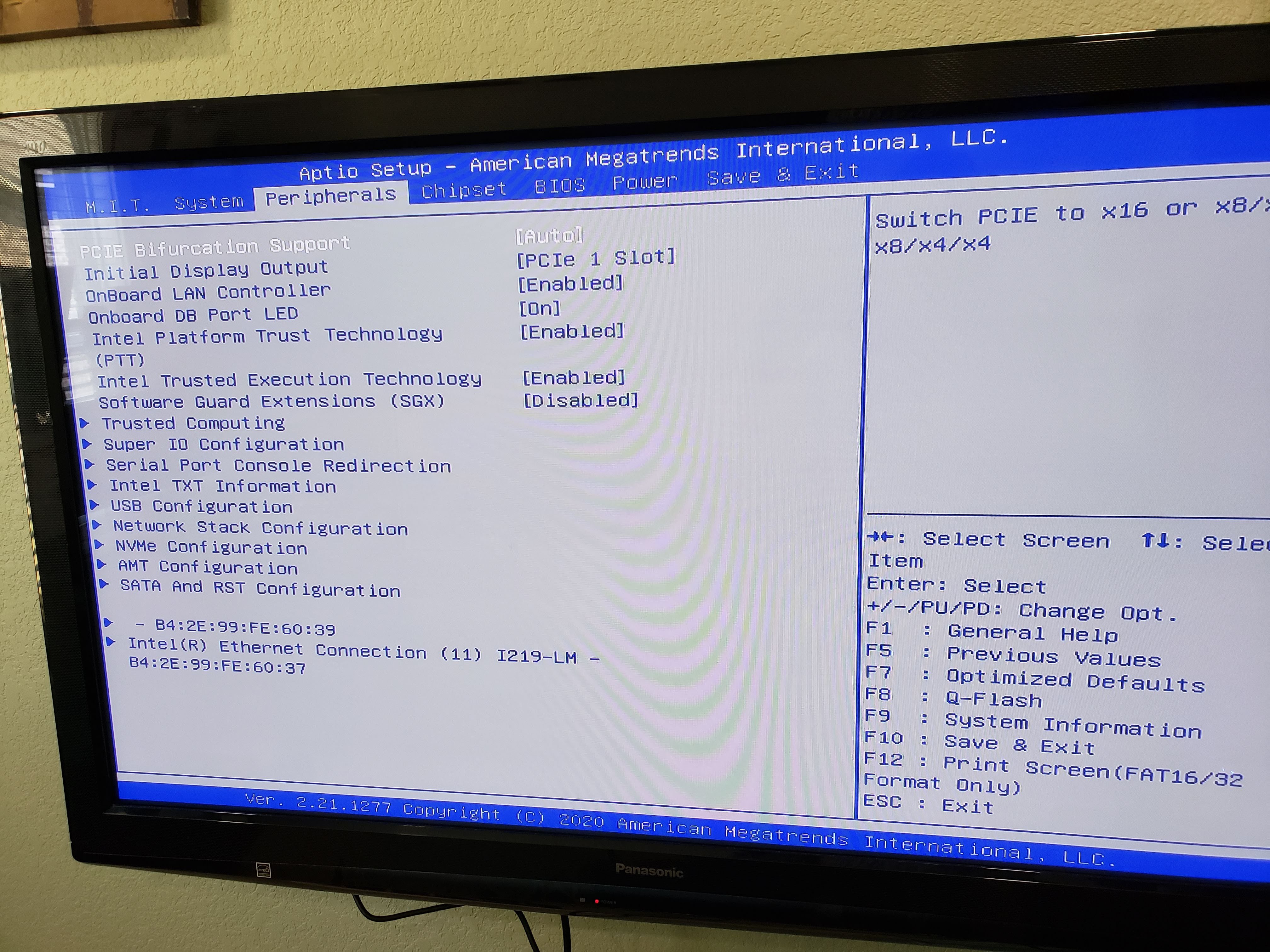

    I tried changing the Fast Boot options and enabled CSM support, same issue. Other PCI Devices and Storage Boot Option Controller set to UEFI. Same issue. I have attached the images of the BIOS Options and the screen shots of what is occurring. IT does not matter if I try with or without GUI, Safe Mode etc. The hardware I am using is:

     The PCIe card uses the Marvell 88SE9215 + JMicron JMB5xx chip and all the hard drives show up in Windows. This is a non-raid card that I was told would work with Unraid and there are reviews on Amazon where people have used this card for Unraid. It does Support AHCI1.0 mode and IDE mode Could the card be the problem or is there something else that is causing these issues? I am going to try to move it to a different PCIe slot on my motherboard, but I don’t have high hopes. If you have any advice, please let me know.
Edited by Mistress_Mistie
It might work but it's not recommended, we don't recommend using Marvell controllers and same goes for SATA port multipliers, that one has both.
What PCIe Sata card is recomended?
Any LSI with a SAS2008/2308/3008/3408 chipset in IT mode, e.g., 9201-8i, 9211-8i, 9207-8i, 9300-8i, 9400-8i, etc and clones, like the Dell H200/H310 and IBM M1015, these latter ones need to be crossflashed.
Note that it's not clear to me that the controller is what's causing the boot problem, but still not recommended.
I can try a new controller, but like you said, it may not be the problem. I have tried so many different things in BIOS that I am about to just get a new controller card and try it anyway. I found a Dell H310 LSI 9211-8i P20 that is already flashed to IT Mode for $59.00. Perhaps it is best to just go for it at this point. This is a SAS controller so will it work on SATA drives? What cables do I use to conntect SATA drives to a SAS controller card?

When you have booted Unraid (you're at that Unraid login prompt) you then open your web browser (on another computer) and go to the IP of the Unraid server.  <<< This is your GUI.  A website.  Basically.  At that point your Unraid server is done doing all it's going to be doing, until you do stuff from the Unraid WebUI on another computer.
Unraid OS (Headless)
The standard boot mode for Unraid Server OS, headless mode utilizes less memory than desktop mode, but relies on the use of another device capable of running a web browser to access the webGui for management.
If a monitor is attached then a console login will be displayed that can be used to access the Linux command line on the server.
Unraid OS GUI Mode
Loads a lightweight desktop interface on a directly attached monitor with a quick-launch menu for accessing the webGui, product documentation, and useful Linux utilities including a bash shell, midnight commander, and htop. This mode may be helpful for users trying to diagnose network connectivity problems or for users that don't have a separate device to use for connecting to the webGui.
The management interface presented in this mode is the same one that is displayed when running the system in headless mode and accessing the server remotely using a web browser.
Unraid OS Safe Mode (no plugins, no GUI)
In this mode Unraid suppresses loading any plugins that the user may have installed. Use this boot mode to diagnose if plugins are causing stability issues on your system.
Unraid OS GUI Safe Mode (no plugins)

I see that your board has a 1Gb and a 2.5Gb Intel NICs.
Since you are running 6.8.3, the 2.5Gb will probably not work, try the 1Gb port (I think it is the black one).
No driver is being loaded for either NIC, @Mistress_Mistietry the latest beta, it should have the driver for both.
