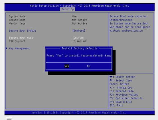

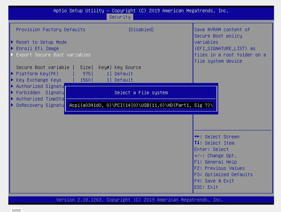

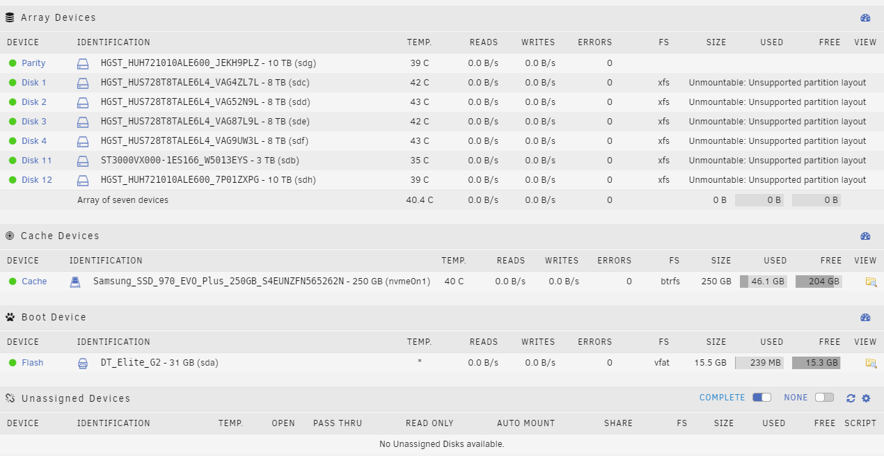

Im new to unraid. today, i was trying to set up the secure boot function in my supermicro motherboard, and was trying to "install factory default keys" and "export secure boot variables", the latter one popup the windows shows "the select a file system", like "acpi(a0341d0, 0)\PCI(14|0)\USB(11,0)\HD(Part1, sig ?)\", something like this, and I just clicked ok, maybe select them all. Finally, when I boot up unraid, my array was started, but the data disks are all "unmountable: unsupported partition layout", and lost all the share folders.
Im wondering if I have already lost all the partition tables or something like that, can I recover all the shares? can anyone please help me out, thanks a lot!

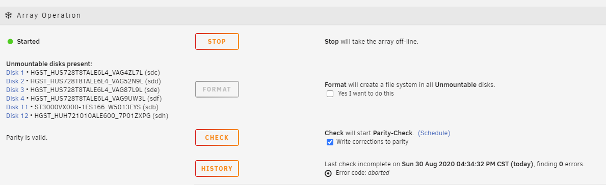

my diagnostics file was attached with this thread, and some screenshot are as follows:

Since the partition info is outside parity and can be recreated by Unraid, rebuilding one disk at a time should work, assuming only the partition info was damaged, try this, stop the array, unassign one of the data disks, start the array, if the emulated disk mounts and contents look correct rebuild on top, when done repeat for the other disks, always one at a time.

Hi, I am trying to find a way to format a single disk but can't get the function, cos i got this situation as below:
I am afraid of checking the "yes" and then the unraid will format all the unmountable disks directly. is there any way to format a single one? thanks a lot!

Post a screenshot of main to see the current array status.
