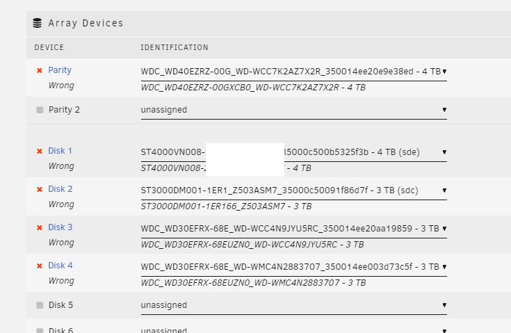

Migrating whole system from a Workstation machine with a LSI Dell H310 to a HP ML350p with a onboard P620i
I have set the card to HBA mode expecting it to pass thru with no issues but on boot and to initialize the array it is showing wrong on every disk.
What are my best steps

We don't recommend using RAID controllers, this is one of the reasons, doing a new config and re-assigning all the disks should solve the problem, but note that some RAID controllers also interfere with the MBR/partitions, in that case you'll get all unmountable disks, if that happens it can usually be resolved by rebuilding one disk at a time so Unraid can recreate the partitions but you'll run into the same issue if you replace the controller with a different one in the future.

How else am I meant to hook it up not many boards have more than 6 Sata ports in this case 2 and a couple SAS ports
The ideal method is to cross-flash the controllers into IT mode so that they won't interfere with the drives being passed-through.
If you want to know how to cross flash, google  cross flash dell h310 it mode
You also want to use  FirmWare Version(20.00.07.00)  on your card.
I am not using the Dell card as it's an HP system and it causes issue with the cooling managagement. HP card is set to HBA mode same as the Dell card
What I recall seeing when many RAID cards are operated in the HBA mode is that they modify the serial number that the card reports to the server's OS.  Unraid uses the serial number to identify the disk slot each drive is assigned in the array.  Each different RAID card has it own algorithm to do this serial number modification.  So when you swap cards the drives serial numbers are different and Unraid 'thinks' that it has missing drives.  If you have a printout of the old drive assignments and their serial numbers, you can often figure out which disks go where.
LSI cards in the IT-MODE pass the serial number through without modification.

Yeah its modified it slightly but i can identify them all is there a way to make the system go OH that is the correct array and i can then manually verify it with the parity
EDIT: Did a new config then mounted all disks and parity drive is now rebuilding
You can use true HBAs like the LSI, that HP is a raid controller, even when in HBA mode, and those can have issues, one of them you just experienced, changing the disks identification, that doesn't mean you can't use it, just should be aware of the implications.
Should be fine now it actually is a bit faster than before. Yes i do accept its not optimal but it certainly works just fine here but if i did have to migrate again it would have to do the same thing, My data pool is not that big right now so im not fussed
