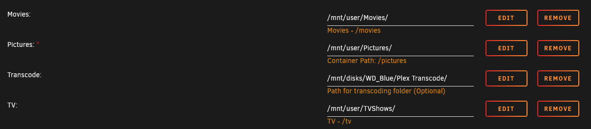

  1. I have a Movies share and a TV share but when setting up Plex there is only 1 host path for data which I set up in my Movies share so I can only access the movies share in Plex to add movies. Do I need to add a second host path for a second /data/ container path in the TV share?
  2. How do I configure Plex such that my main account (the admin one with Plex Pass) is shown as a name rather than an email address? Are you meant to use your admin account for watching content?
Edited by smush
Depends on how you have your shares setup.  If you only have a parent media share with subdirectories for different content types (movies, tv shows, photos, etc.) you only need one volume mapping, e.g. /data to /mnt/user/media.  In plex you would then browse to /data/movies, /data/tvshows, /data/photos for the respective media libraries.
If you have separate unRAID shares for each media type, then you need to create a volume mapping in the Plex docker container for each media type.  This is how I have mine system configured and here is an example of my volume mappings:
With a separate mapping for each media type, I just browse to /movies, /pictures, /tv, etc. in Plex when setting up the libraries.
