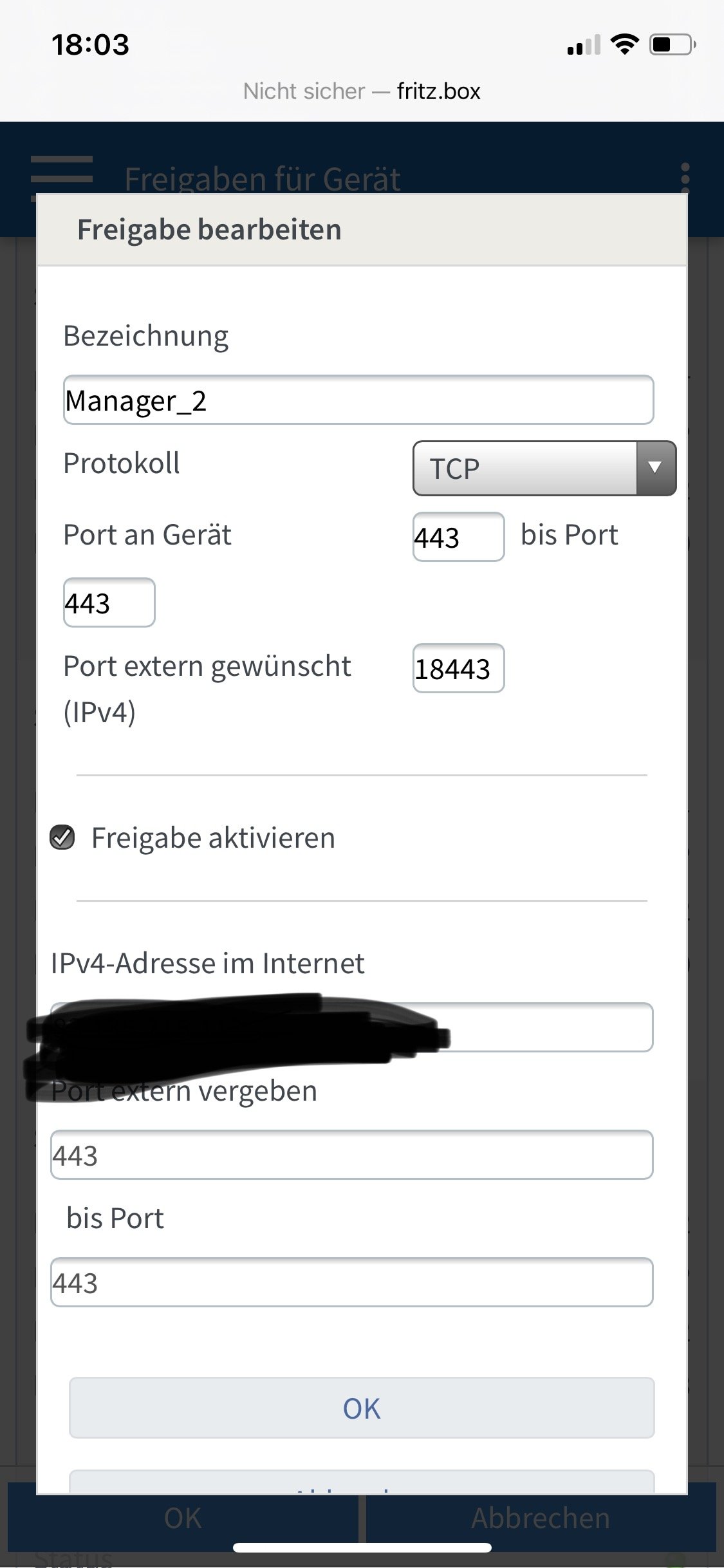

I use a FritzBox
On the Port Tab i have set the Internel Port 80 to extern 1880 and
port 443 to 18443 (I Add a Screenshot)
and After That, the Same Problem.
The docker use Bridge Mode as Network.
maybe that could be the problem?
I am not too familiar with Fritz box but I think you have the ports mixed up. You need the external port (WAN side) to be 443 and the internal port (the one pointing to NPM, LAN side) to be 18443
.... ok .. this fix my problem .. xD
THX U ❤️❤️
