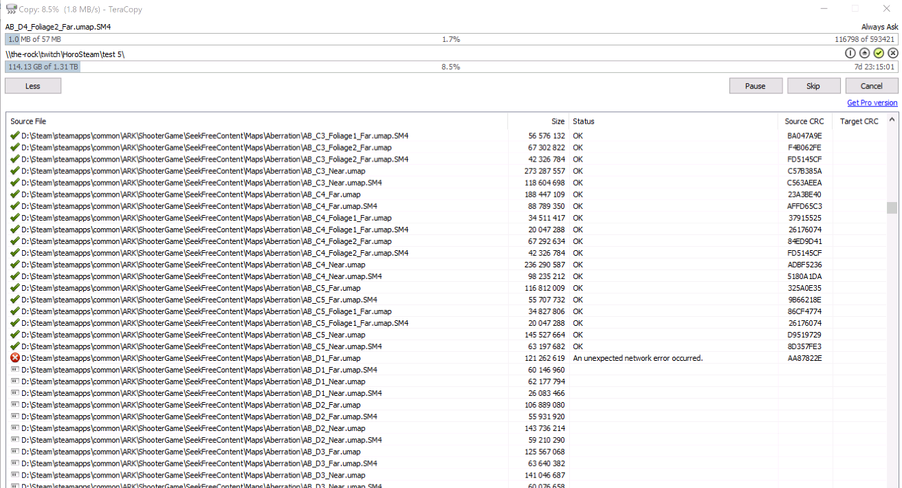

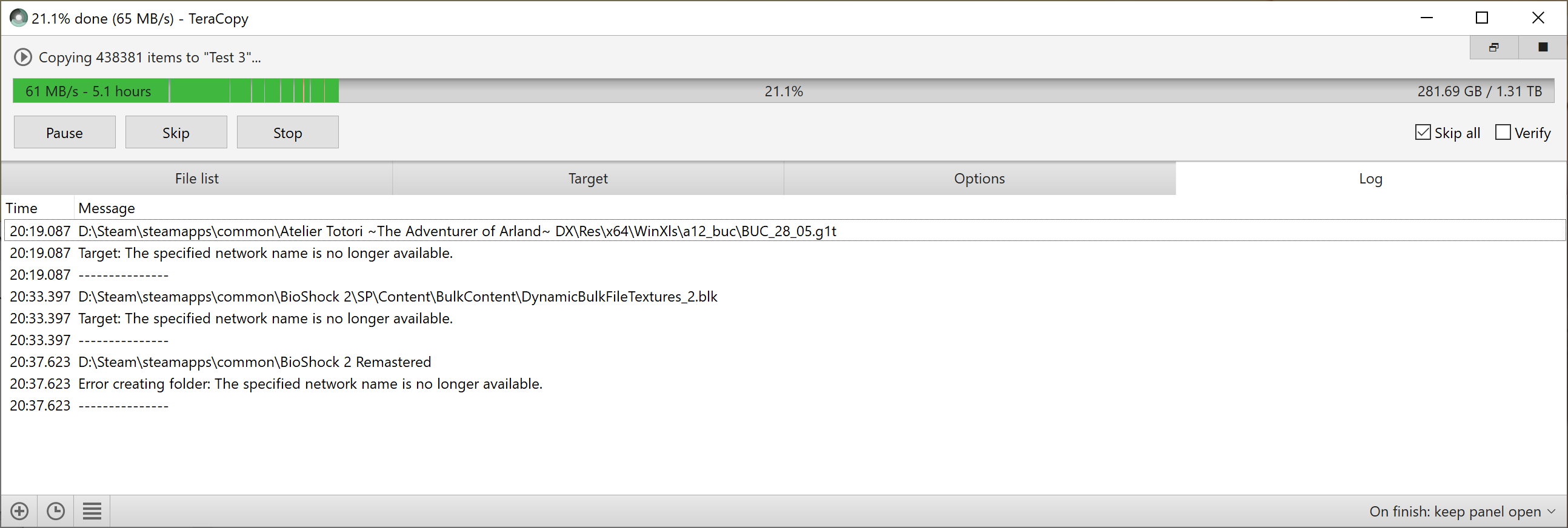

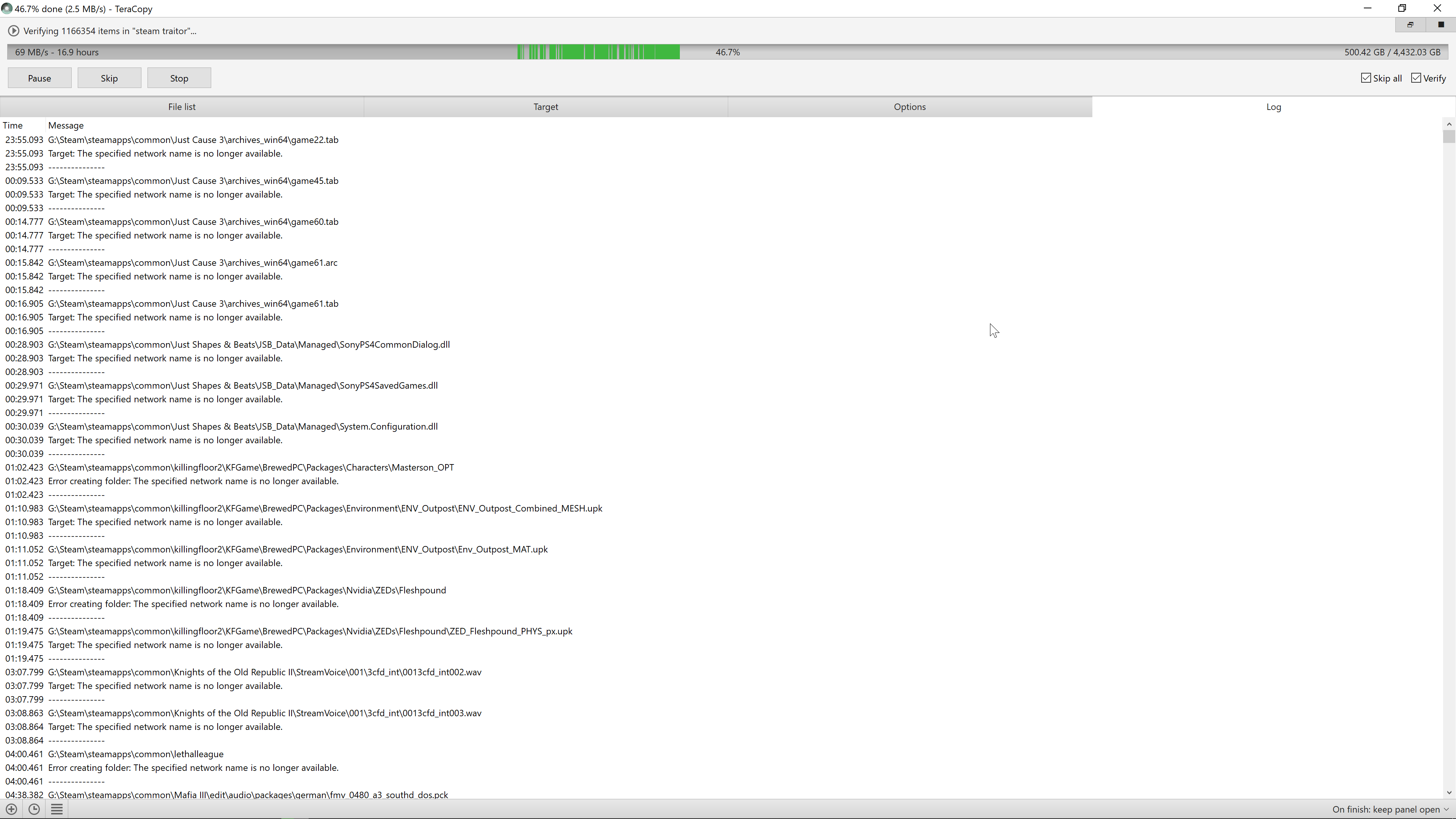

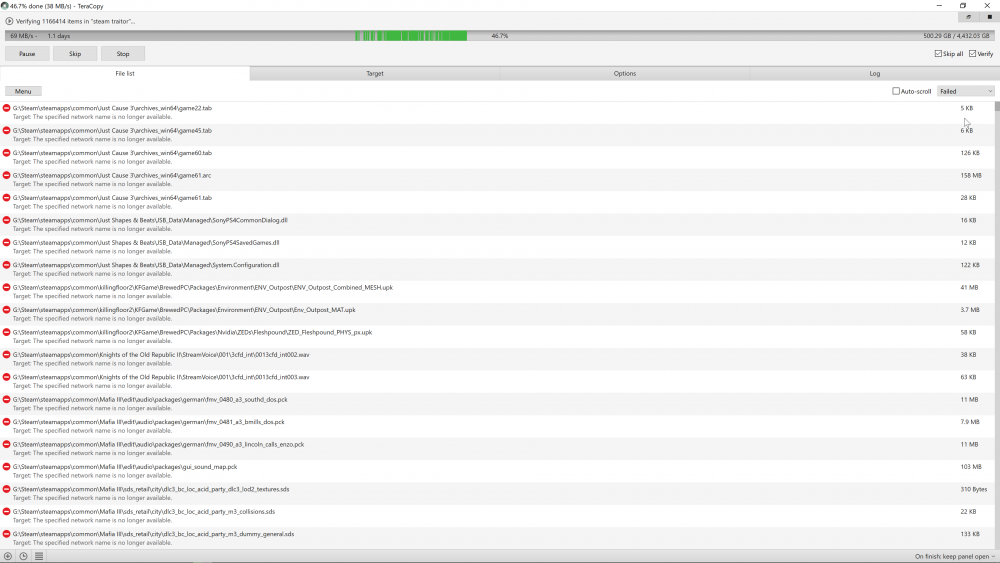

windows file copy will just stop after a while.
I normally use I use teracopy to transfer and verify files.

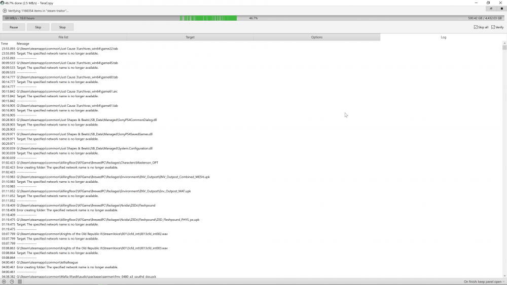

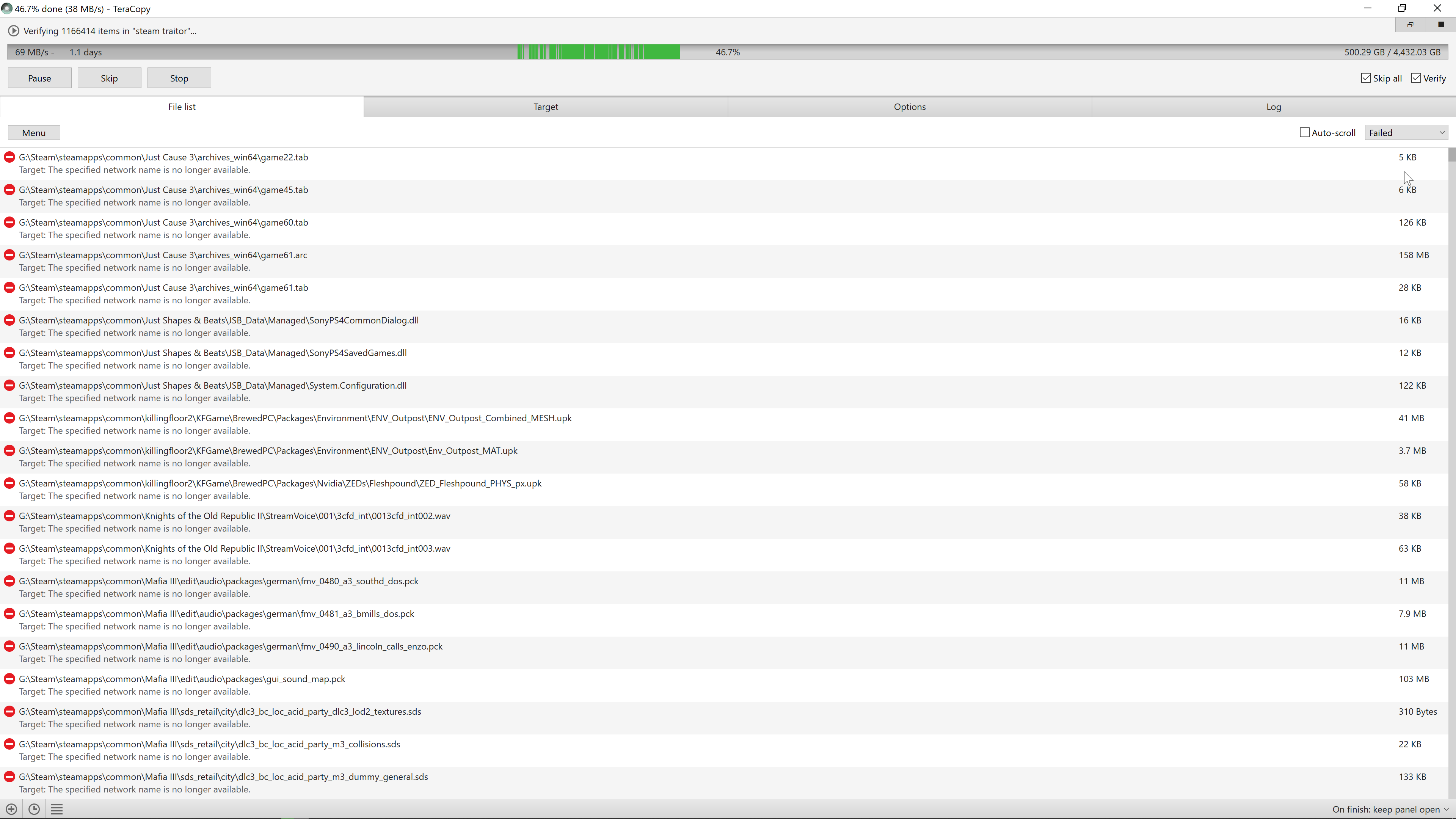

I have attached some screenshots from an attempted copy of a steam library
I also have attached the unraid diagnostics file.
-thank you

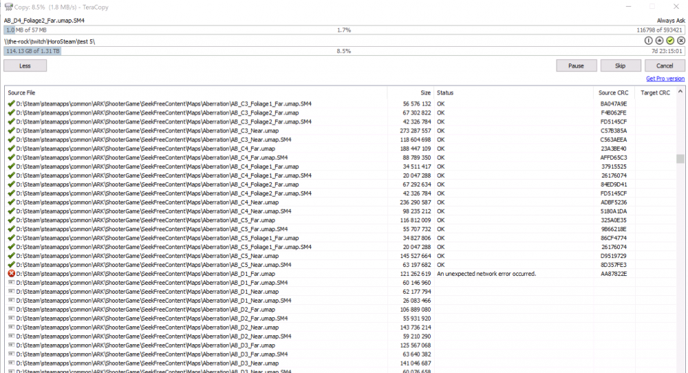

I did a copy to a normal windows share from same computer.

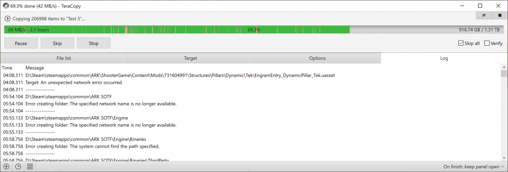

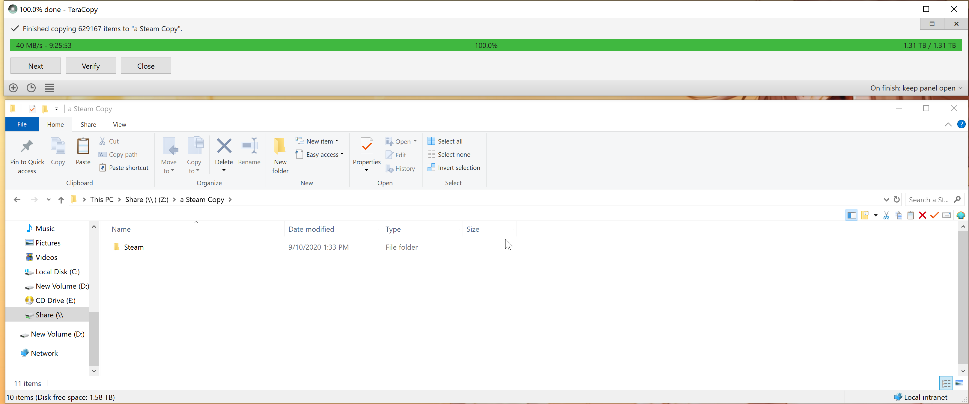

here's screenshots of the unraid vs the normal share, the unraid is continuing to exhibit the same behavior.

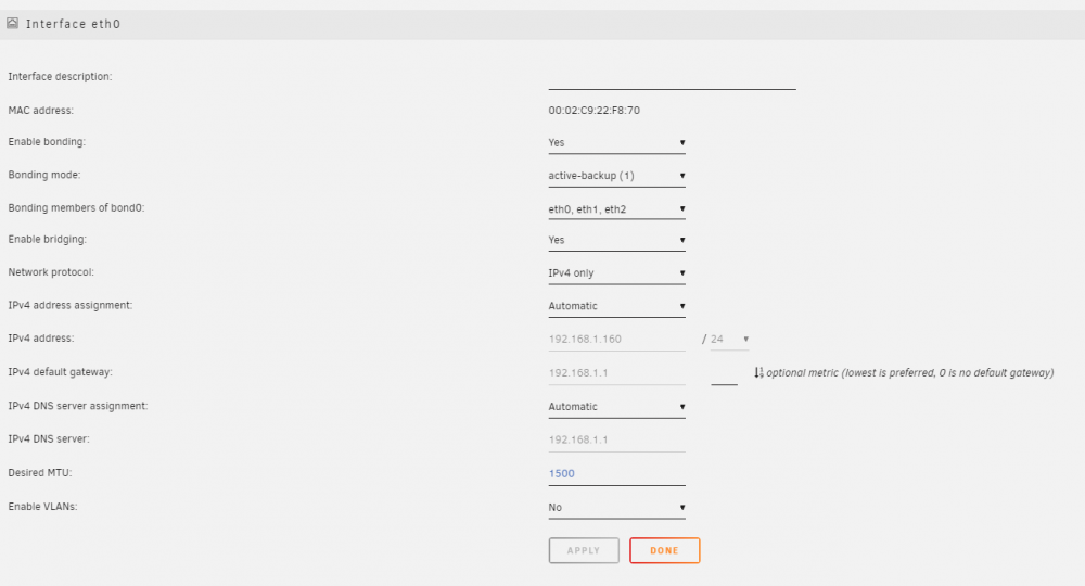

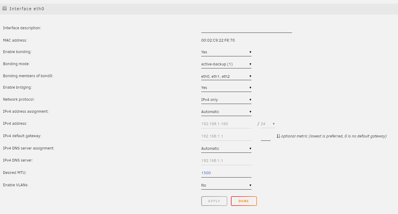

Try disabling NIC bonding, sometimes causes issues.
disabling nic bonding, running another test... this is how it was set
Edited by Holo

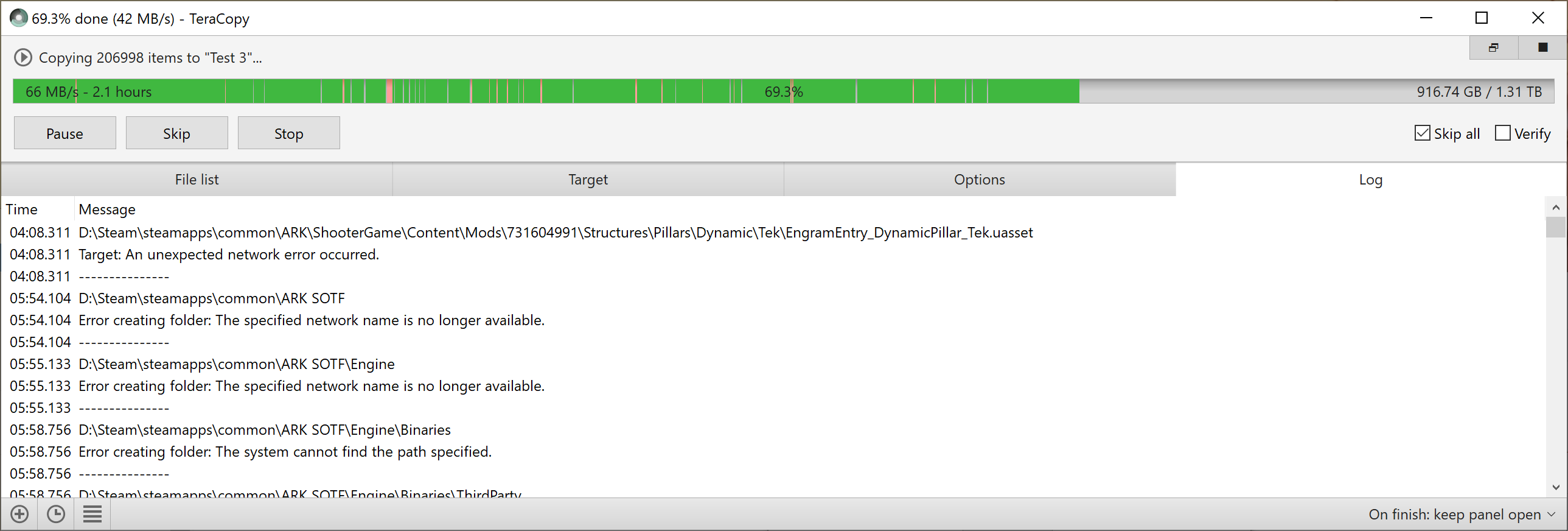

results are in. I ran 2 tests.
1. the 10gb fiber nic -bonding disabled
2. the internal 1gb nic -bonding disabled
same results as before

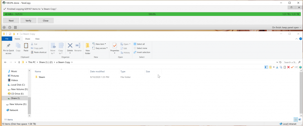

here's the screenshots

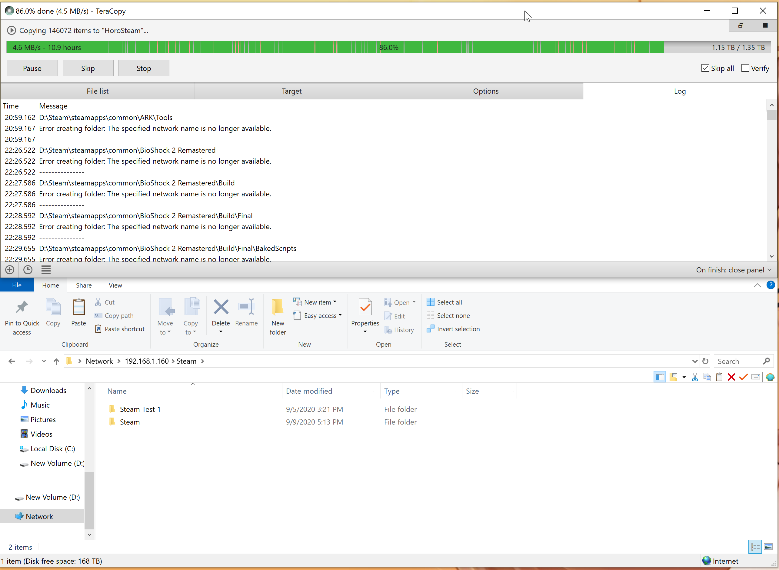

Do you have another source computer you could try with?

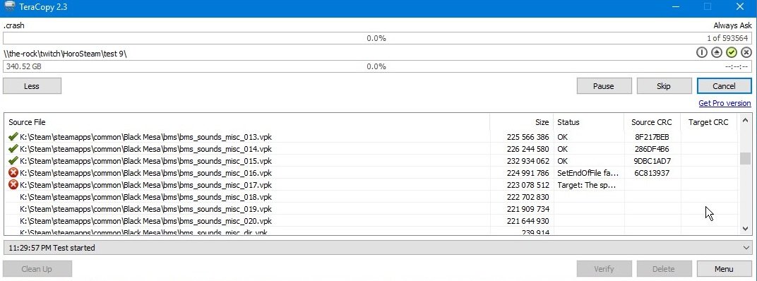

I ok I switched to a different computer, it has an older version of teracopy. I have copied over 100tb with this version. here's the results. same thing.
