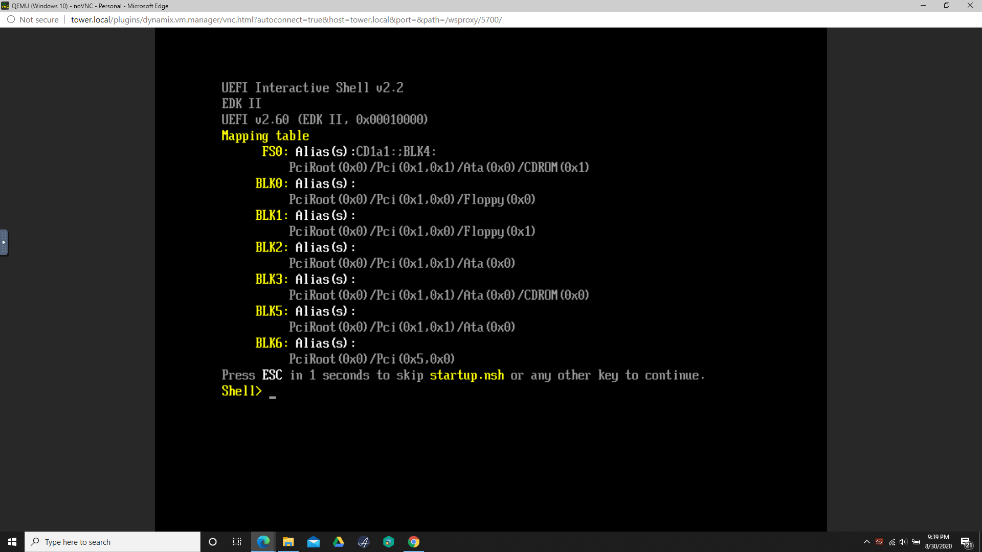

I have a Windows 10 VM setup following the SpaceInvader guide. Installed a ISO, etc. However when I click on it and select "VNC Remote" it brings up this pane and no Windows. I have no idea what any of that is or what its about. Is there something I have setup wrong or still need to add?  I should point out that I am accessing the Unraid server from my laptop on my LAN. I was logged in to Unraid with Google Chrome and well as tried in MS Edge with same results.
That is the bios screen on the vm. Had to find another windos iso when i had the problem
Edit. You get the screen aswell if you dont hit any key before xx sec to start installing

Try forcestop windows vm and start and connect to vnc fast and see if you get hit any key message.
Or type exit and choose boot somthing(at work so cant check the specific path). And click cdrom.
Sent fra min SM-G965F via Tapatalk
If you mean that you are trying to install a Windows VM, then you probably are not starting the VNC viewer quick enough to "press any key to start installation".
As soon as you start the VM and you can click on the VM to get the popup menu for VNC you need to get in there and press a key... like quick.
GOT IT GOING! THANKS!  I didnt realize that when I select start I need to start clicking for the drop down to select VNC remote the moment its available.  I was actually selecting start and giving it probably half a minute or so thinking it might need to go through a process or something.
