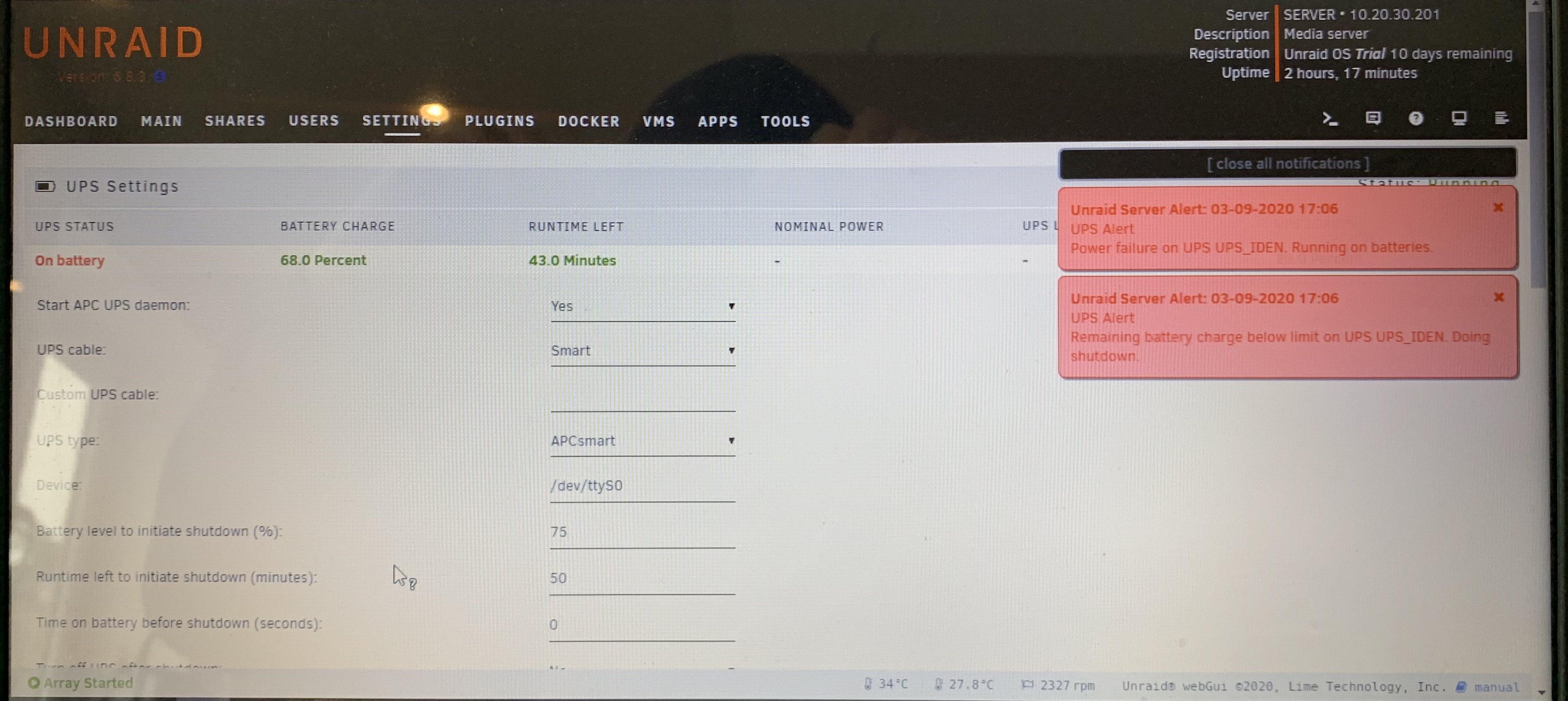

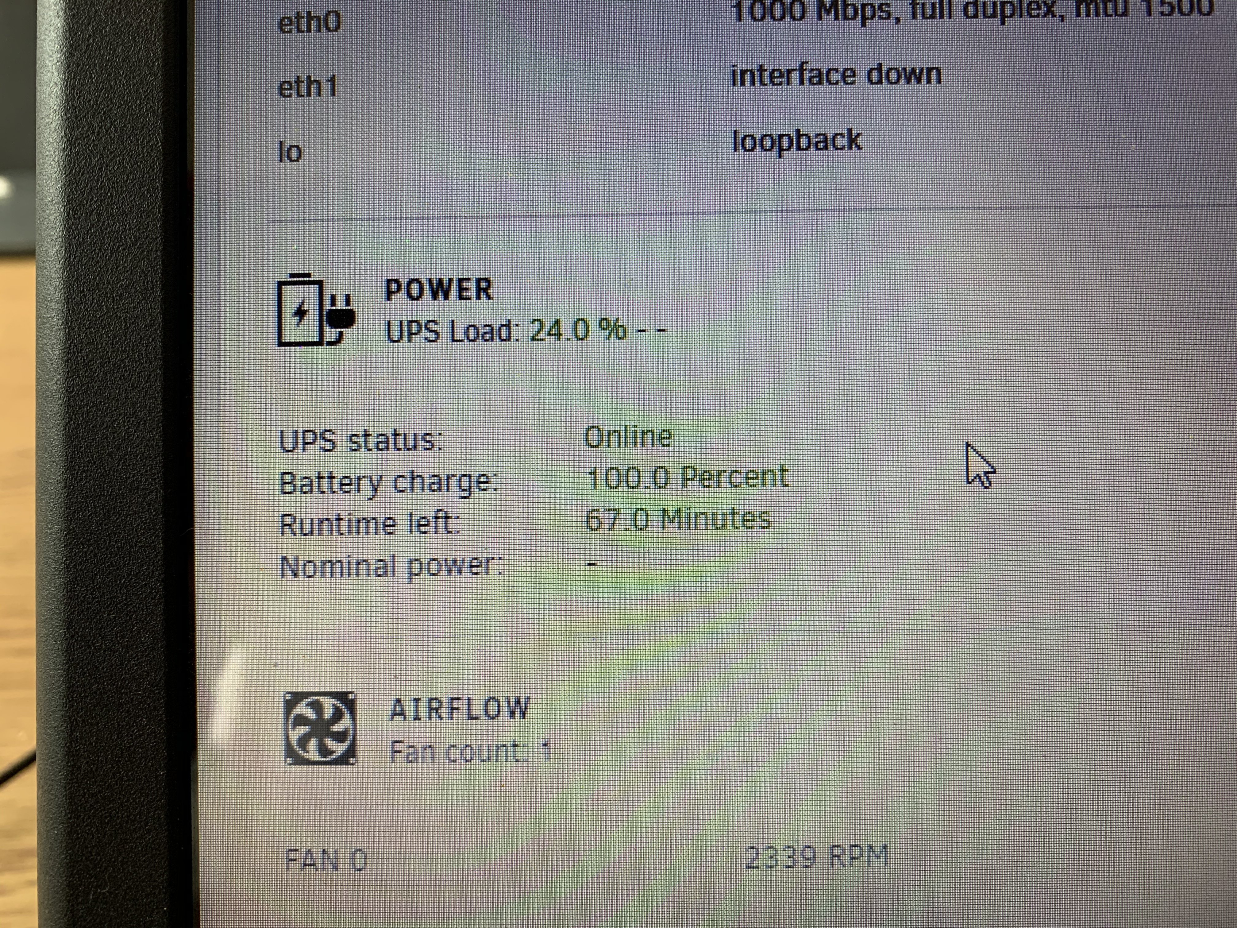

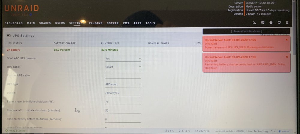

Just setup my old acquired APC UPS.
connected via serial straight onto my motherboard header. Used the APC manual link on the UPS settings page to guide me on pin outs.
works perfectly and does a clean shutdown based on my settings.
