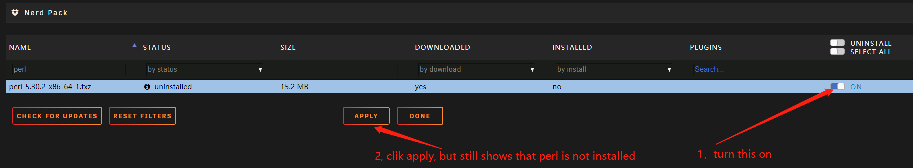

can't install perl to nerdpack
hi guys, everytime I click apply button, and it turns out the perl is still not installed.
see picture below.
Any help?

Hi buddy,
Im having the exact same issue, how did you solve it?
  • 11 months later...
I had this same issue.  I couldn't solve it though the plugin, but I was able to get perl installed manually.  I used the slackware installer (upgradepkg) to install perl. After manually installing it shows up as installed and has an update ready, I can't get the update done with the plugin but perl is installed and is working.
https://slackware.pkgs.org/14.2/slackware-x86_64/perl-5.22.2-x86_64-1.txz.html
