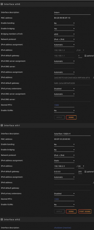

My setup is a motherboard with an internal NIC connected to the internet and a Solarflare Card with 2 NICs, one connected to just a single host on the other side.
Consider the network configuration on the screenshot
eth0 is pretty straightforward with DHCP setting, however, eth1 has assigned a static route, no gateway (0.0.0.0) and a metric of 255.

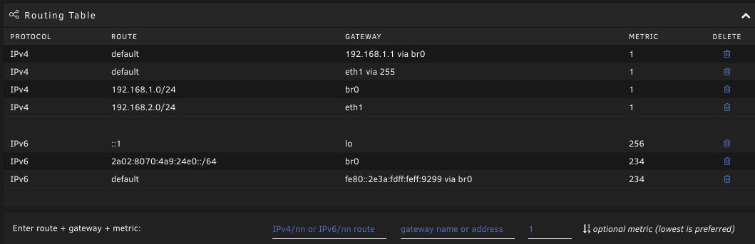

The issue now is how this seems to be interpreted in the routing (see 2nd screenshot).
The 1st probable bug  in "eth1 via 255" is that the metric "255" is somehow misinterpreted as an interface or an IP address.
The 2nd bug is that I cannot delete this route with the trash icon next to it. It asks for confirmation which I give, but nothing happens.
An "ip route" command yields
ip route
default via 192.168.1.1 dev br0 proto dhcp src 192.168.1.2 metric 1
default dev eth1 metric 255
192.168.1.0/24 dev br0 proto dhcp scope link src 192.168.1.2 metric 1
192.168.2.0/24 dev eth1 proto kernel scope link src 192.168.2.3
The command
ip route del default dev eth1
is able to delete the route indeed.
