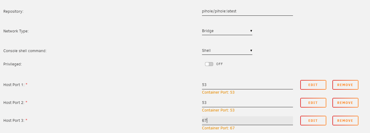

September 2, 20206 yr Hello all: I am trying to install a pihole-template docker with ports 53 (TCP/UDP) and 67 (UDP). If I look into the port allocations, 53 and 67 are not used in other dockers. When I try to use the ports 53 and 67 in bridge mode like below: I get error: But if I change the ports to 533 and 677, it works but DNS port needs to be 53 to send DNS query from clients. Not sure what I am doing wrong. Can someone help me please? Thank you.

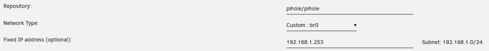

December 17, 20241 yr On 9/2/2020 at 8:38 PM, Squid said: Set up pi hole to be on it's own dedicated IP address Excuse me for replying to this 4 years later, but, how would one do this? I am having the same issue as the OP, and your suggestion seems to have solved their problem, but I'm not seeing any obvious way to do this. Nevermind this for now, I figured it out. In case anyone finds this in the future, just set Network Type to Custom and then you can set a Fixed IP address. Edited December 17, 20241 yr by Th3Element05
