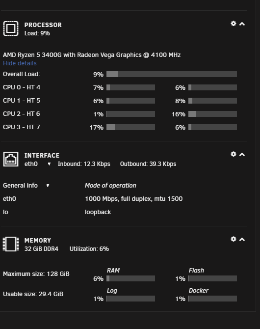

Forgive my noob-ness but where can I find the port connection speed in Unraid?
In GUI main page left bottom will show the port speed.
The new CAT6 cable have quality problem.
Edited by Benson
Ah, thank you. Its at 1Gbps, see below.
This CAT6 cable I got is a 50ft roll. I guess the cable is just bad?? or somehow not compatible with my motherboard?
