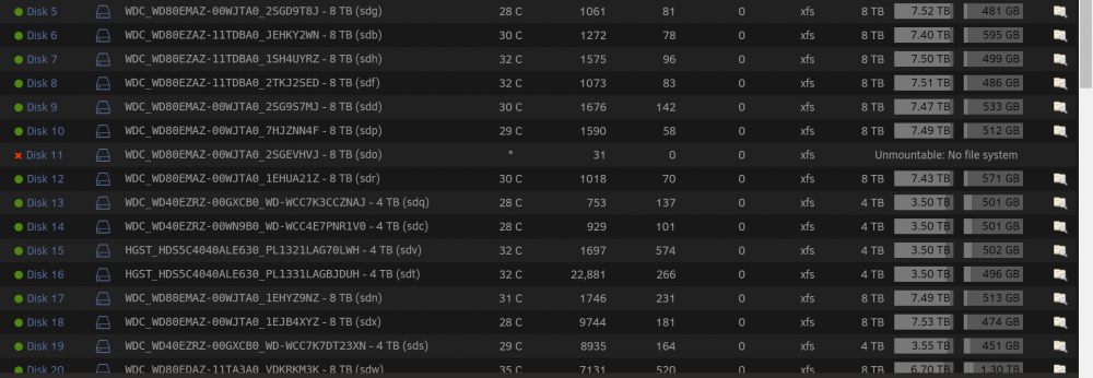

@itimpi @trurl I apologize but it still says "unmountable: no file system" after running the repair? I am sorry I am not understanding I thought that after I started it in normal mode it would rebuild from the emulated disk. I know I should never format but why would the file system still be missing. I attached a screenshot. Thank you both for taking a look at my issue.
Best-
GTP

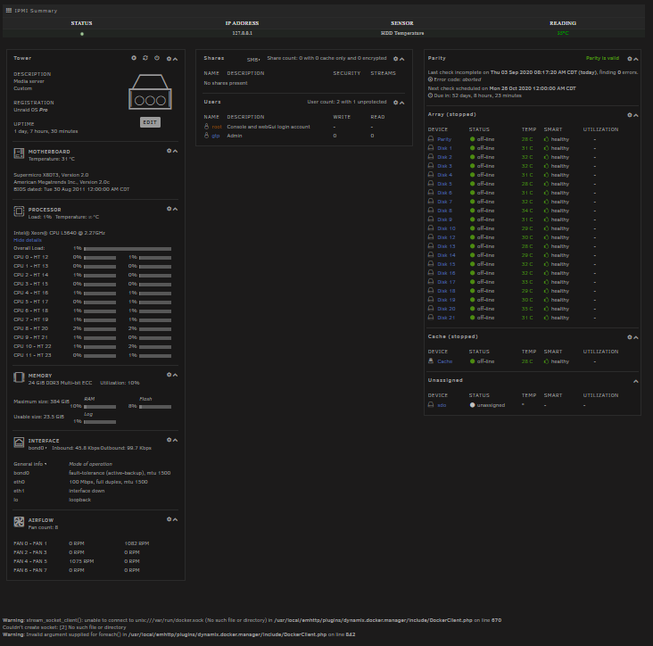

You have a lot of disks, and I haven't examined SMART for each of them. Do any of the disks show SMART warnings on the Dashboard? Post a screenshot of the Array section on the Dashboard page.
2 minutes ago, trurl said:
It is good because you still have the files. It is bad because we don't know the cause of the disk becoming disabled nor the reason the emulated disk was unmountable. Since you rebooted after you began to have problems, syslog from your diagnostics don't tell us anything about what may have happened.
Do you have any ideas about this? Do you have any reason to think your parity was invalid? Your screenshot didn't show all disks. Were any of them showing anything other than zero in the Errors column?
To get that disk back into the array will require New Config / Parity Sync. But before we proceed with that lets see if we can figure out what went wrong, or at least make sure there isn't something currently wrong that would prevent parity rebuild.
@trurl I had just finished a parity check the day before and it showed no errors. Then when I came down the next day to the red x it showed 4 errors on disk 11. No other drives showed any errors. I have not seen a SMART warnings and will post the screenshot below.
Best,
GTP
That looks good. Have you checked the files on the disk with it mounted Unassigned?

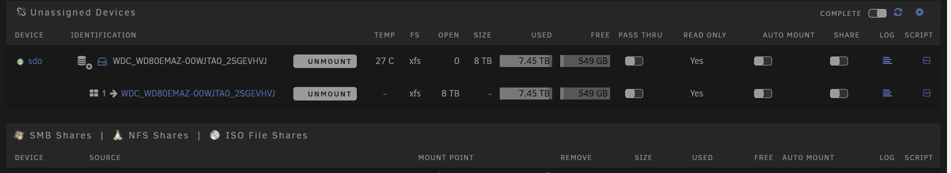

Post a screenshot of Main - Unassigned Devices
Don't worry @trurl  I am not doing anything without your explicit instruction. I have attached the screenshot as requested. I will not touch anything unless you tell me to.
Thank you,
GTP
The slider under "Share" will let you share it on the network so you can look at it from your PC. Maybe you will have to unmount it before it will let you change that, I'm not sure.
