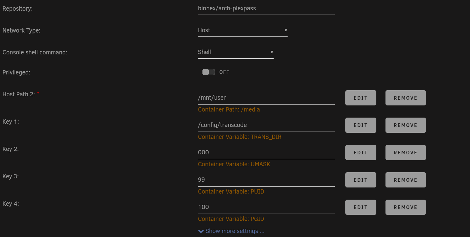

24 minutes ago, GTP said:
run Plex and I was worried about it running out of room to do conversions and all the metadata it stares on the library.
Plex metadata (library) is in appdata assuming you have it configured correctly. Plex doesn't normally write a lot of data unless you use DVR or transcode. Those paths would need to be in mapped storage of course.
You have some dockers I don't use, and I use a different Plex docker.

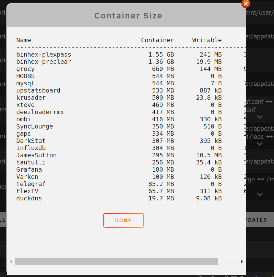

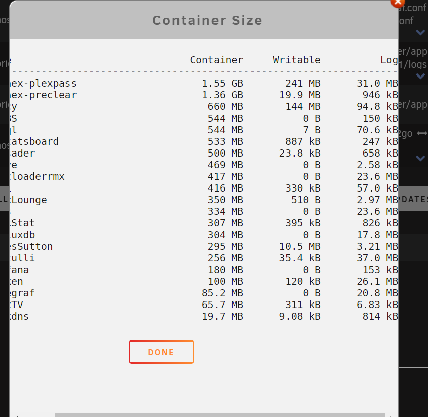

Go to Docker page, click Container Size at the bottom, and post a screenshot of the result.
18 minutes ago, trurl said:
That is the correct setting for those, but it won't be enough to get them moved to cache since mover can't move open files. We will deal with that after some more information.
I have attached the screenshots for the container and my plex container. I also have been playing around with xteve which is a DVR.
Edited by GTP
Clarification
Screenshots of Add / Edit Container page seldom show all the information. See this very first link at the Docker FAQ for a better way:
When I do Container Size I get a grand total at the bottom but I don't see it with yours. Doesn't matter but that doesn't always tell us everything anyway.
Maybe you need more than 20G but I am more concerned that it not grow. As mentioned you are already using 26G. I use less than 10G of 20G with my 17 dockers.

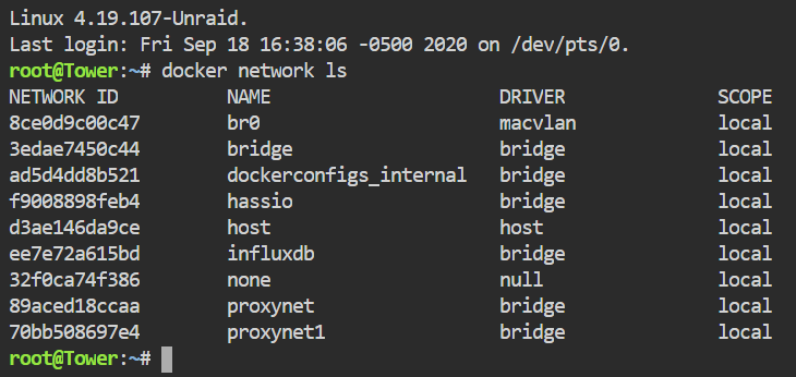

The reason I asked about custom docker networks is because you will have to recreate when you recreate docker.img at a smaller size.
What do you get from the command line with this?
docker network ls
docker network ls
Screenshot attached reading the FAQ

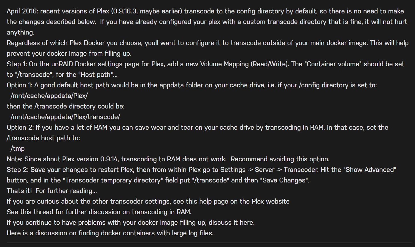

I found the attached information in the FAQ. Which option do you recommend I do?
2 hours ago, GTP said:
can I use the 8 and 12 together?
You can but no data drive can be larger than any parity drive.
The simplest is to just use the default, transcode into appdata, which will be on cache after we get things moved. That is good enough for starters and we can discuss other options after other things are done.

Are you actually using all of these?
Probably already asked somewhere on this thread, but do you have any VMs?

Br0 -unknknown
bridge - I think so
docker-configs - I don't even know what this one does
hassio - I don't think I am anymore if its for the hassio container because I deleted that. I changed my methodology and I do run a Hassio VM and that could be the bridge to the internet.
host - I think you need that one right
influxdb - this one I can say for sure "yes" I use Grafana dashboards and Varken
none - no idea what that is
proxynet - yes for reverse proxy
proxynet1 - yes for reverse proxy

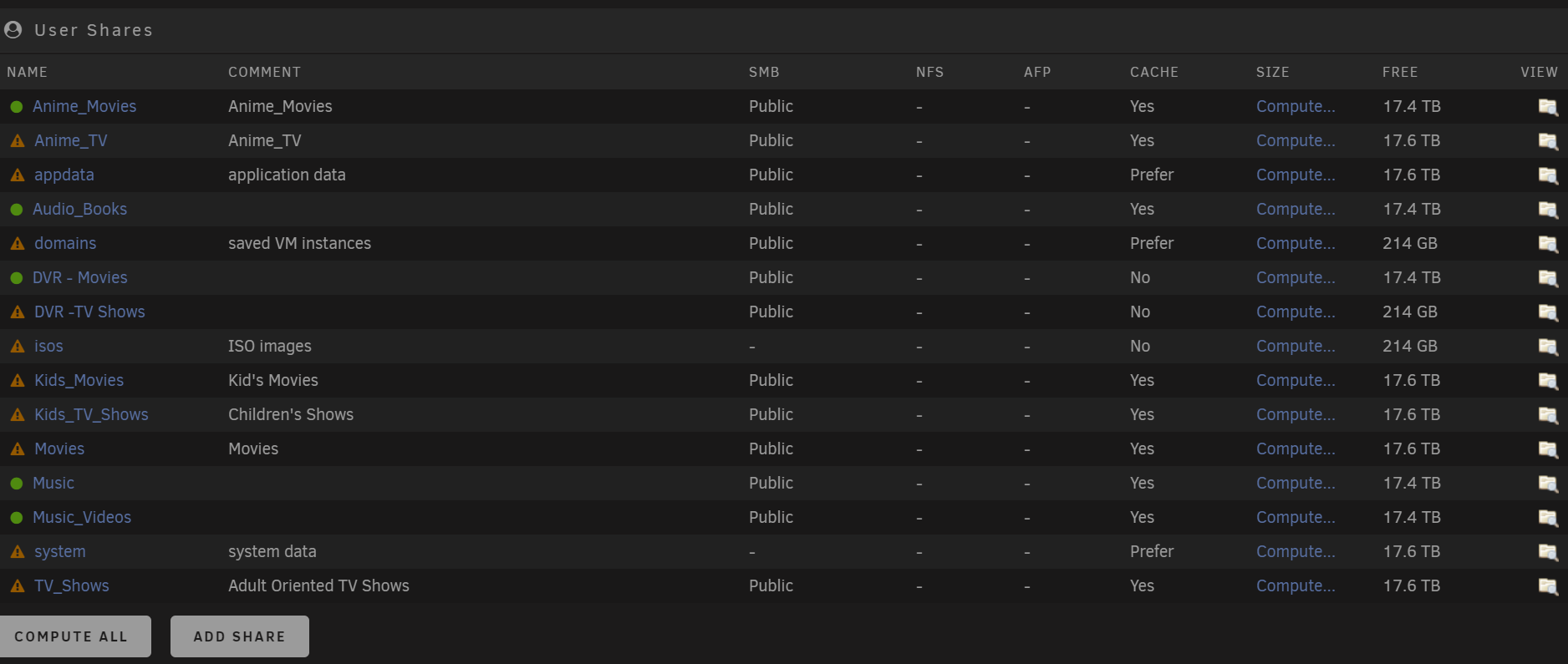

I set those shares to prefer and started the mover. Its been going for a while now and my cache drive is getting pretty full is that ok? Below is a screenshot of the shares and the cache drive.
Is your cache drive large enough to hold the contents of the shares set to Prefer?
Unless you also disabled docker and VM service, it won't be able to move everything, since it can't move open files. But that is unrelated to filling cache.
Probably should have made sure everything that didn't need to be on cache had already been moved off first before trying to move things to cache.

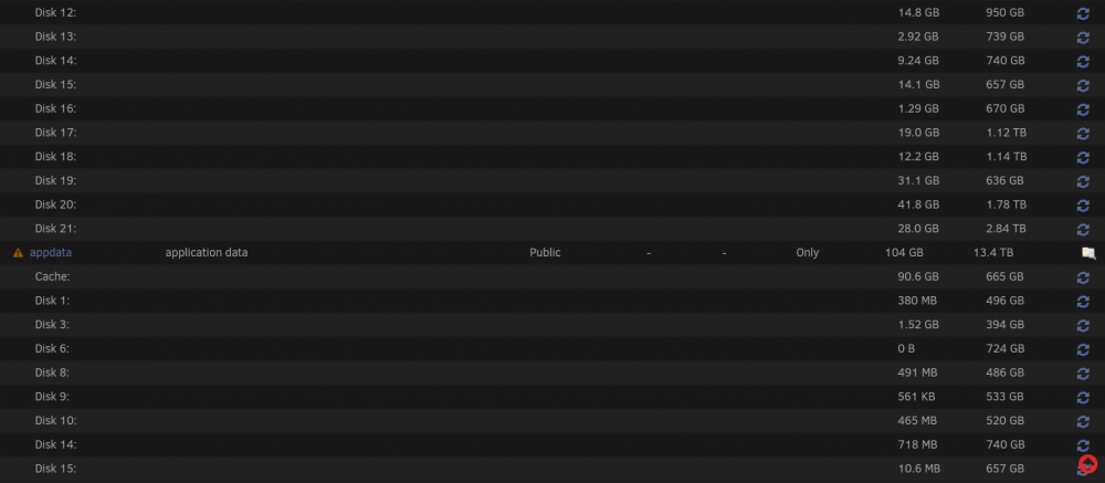

Set appdata, domains, system to cache-only for now. That will get them ignored by mover until we can make room for them.
You have some other shares with files on cache. You can see which shares have files on cache by going to Main - Cache Devices, click on the folder icon at the far right of Cache under View to see which folders (shares) are on cache.
Set each of those shares to cache-yes and run mover. Wait for it to complete then post new diagnostics.

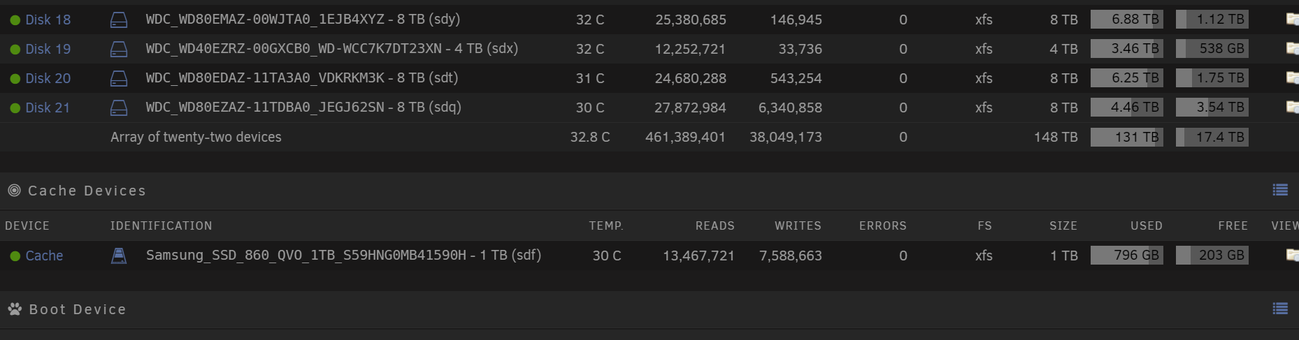

Just noticed your cache is completely full and your log is full of mover messages. If mover is still running try this
Mover logging can sometimes be useful if you need to debug something specific, but I don't think there is anything we don't already understand, at least for now. Go to Settings - Scheduler - Mover Settings and disable mover logging.
You can reboot to clear log space, or you could just do this to get rid of these older logs
rm /var/log/syslog.*

Cache is completely full I have posted two attached screenshots that should help thank you . I followed your instructions regarding stop and "only"
-GTP
Also do this
Mover ignores cache-no and cache-only shares. It moves cache-yes shares from cache to array (we will get to cache-prefer later). As you can see, you have some cache-no shares that have files on cache. To get those moved from cache, set each of them to cache-yes.
Then run mover, wait for it to complete, post new diagnostics.

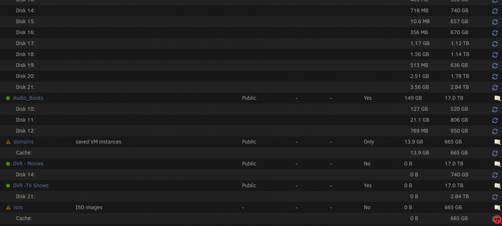

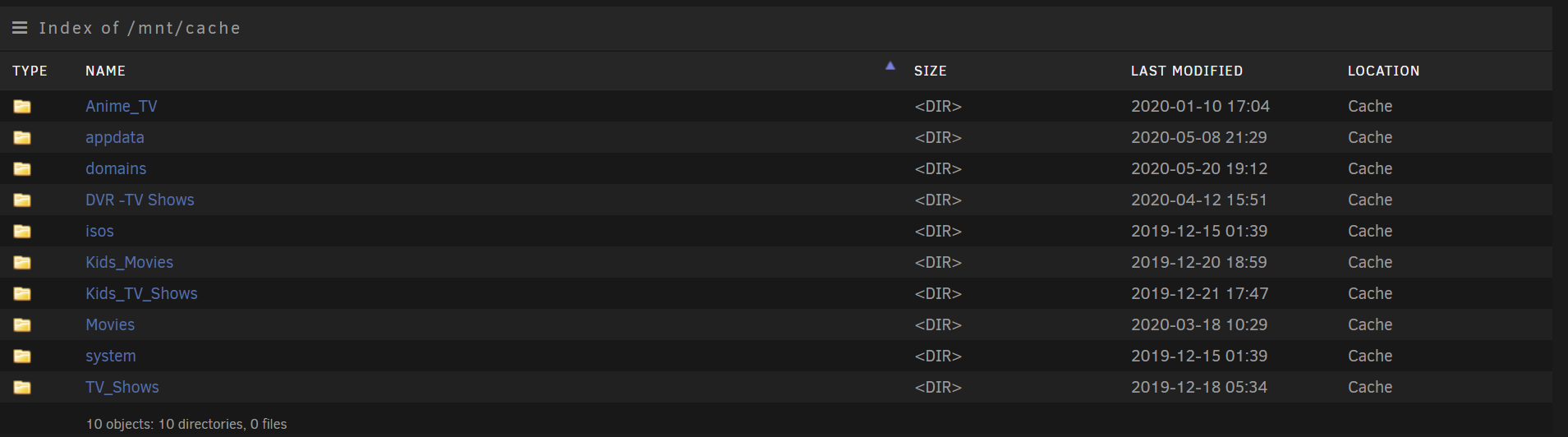

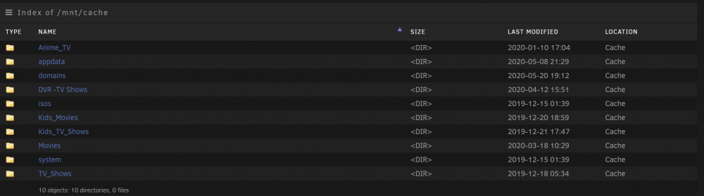

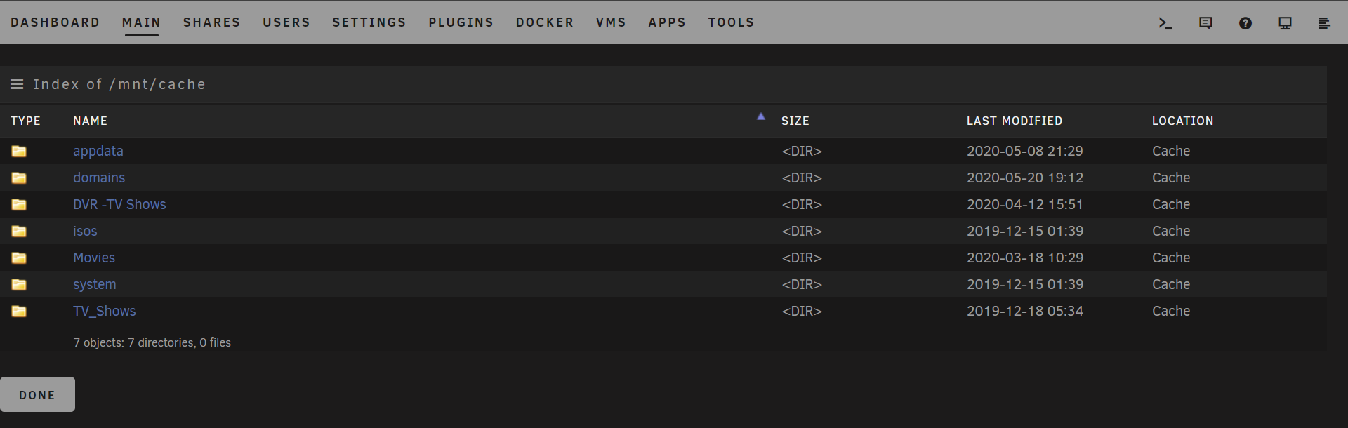

@trurl I followed your instructions and I moved everything off of cache that I could. Two directories seem to be sticking, one directory with one movie in movies. and one directory with one tv episode in TV Shows. Other than that it only has the files it should. What should we do next? Diagnostics have been posted below and a picture of the cache contents.
Best,
-GTP
tower-diagnostics-20200920-2010.zip

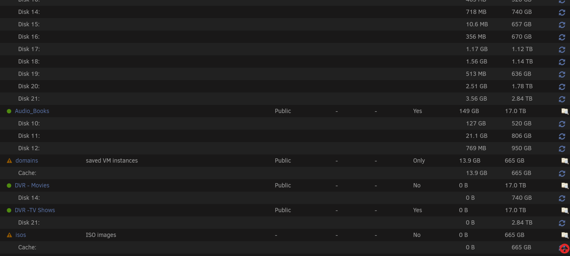

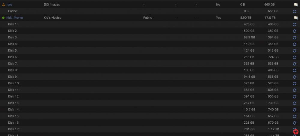

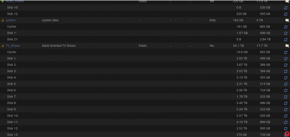

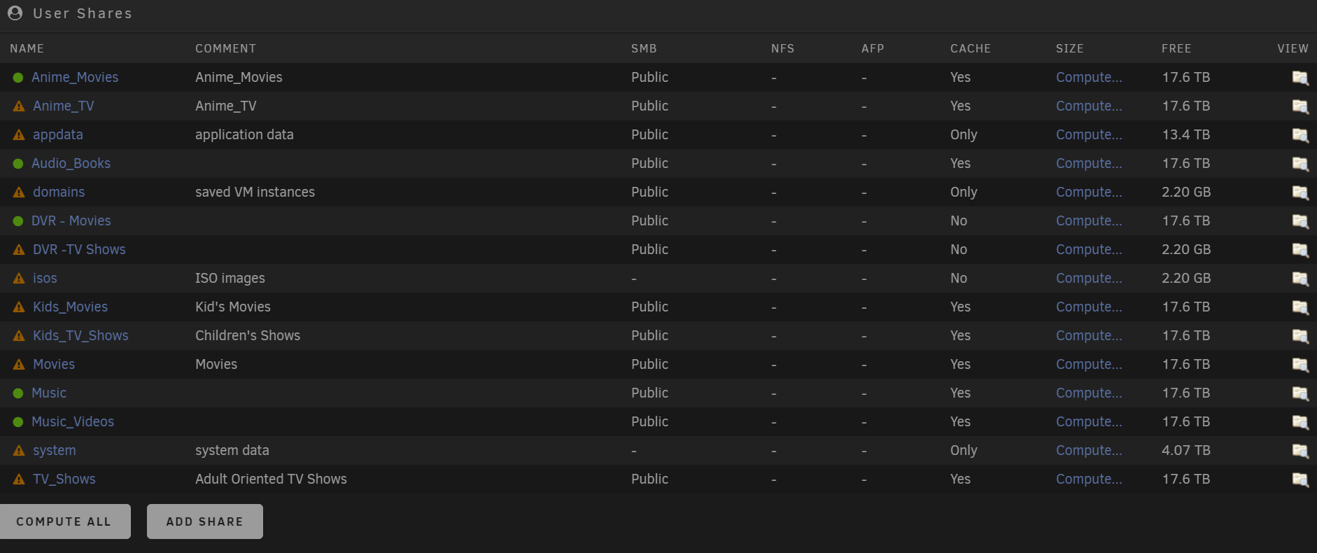

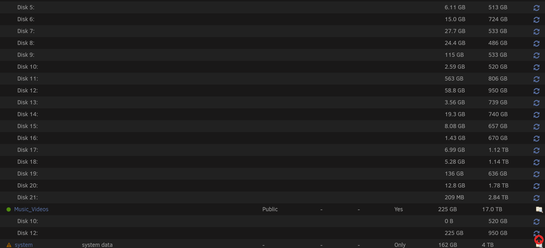

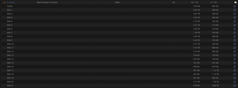

Are you sure something doesn't have those files open? Go to Settings - Docker and disable dockers, then try to move them again.
Looks like DVR TV Shows has all its files on cache.

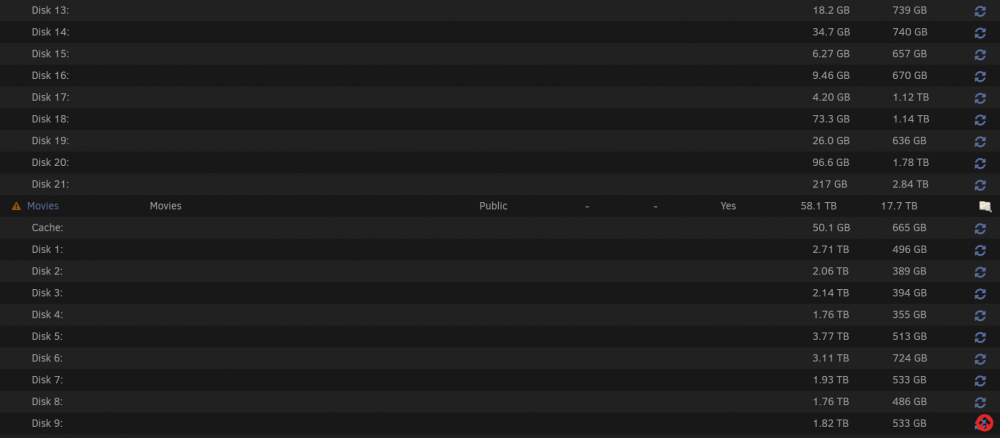

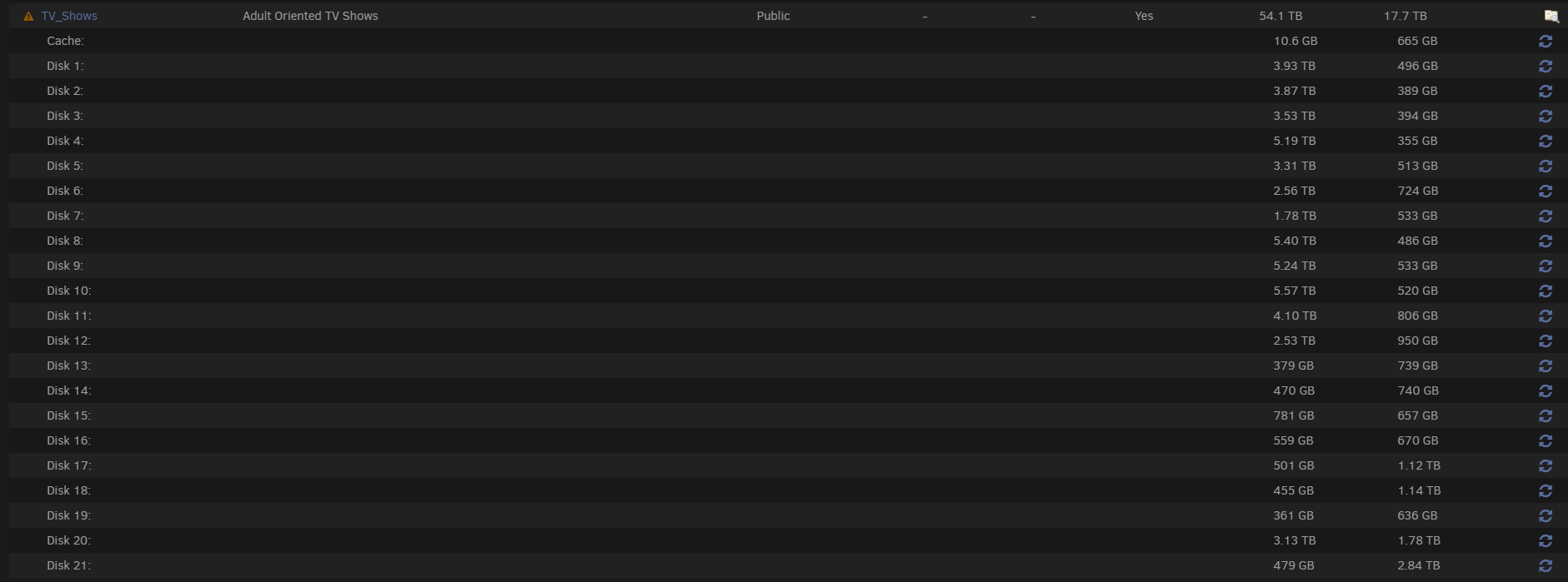

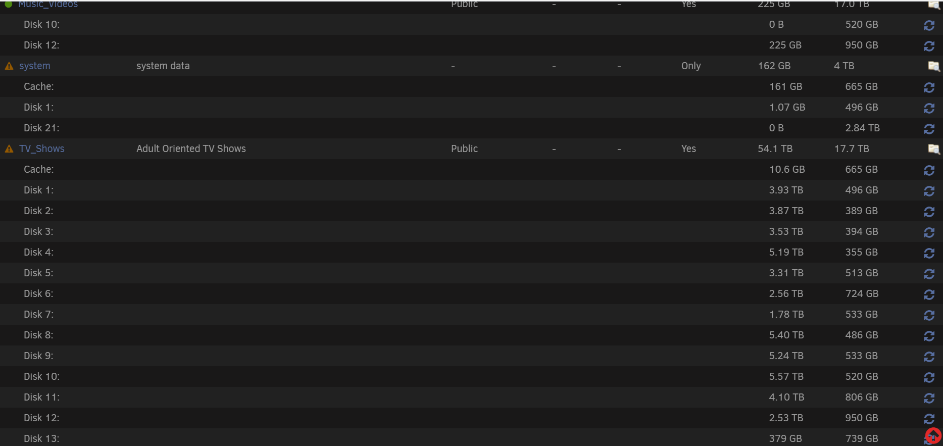

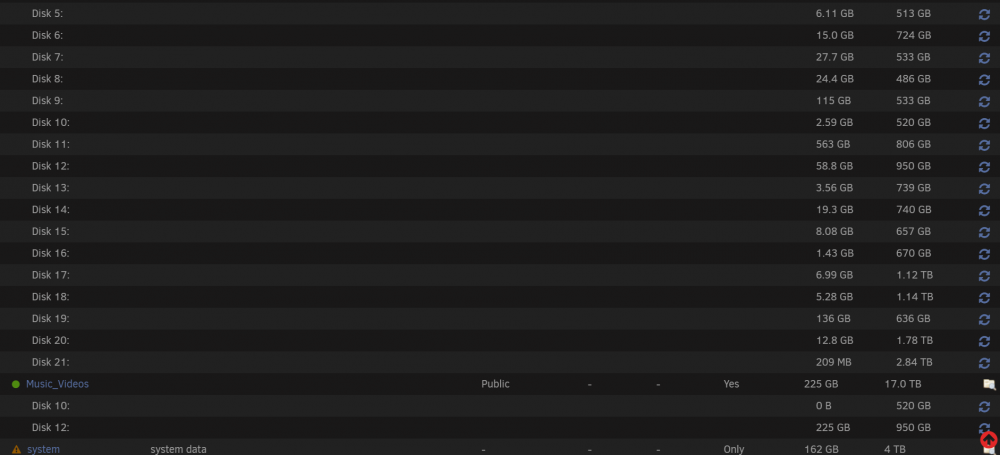

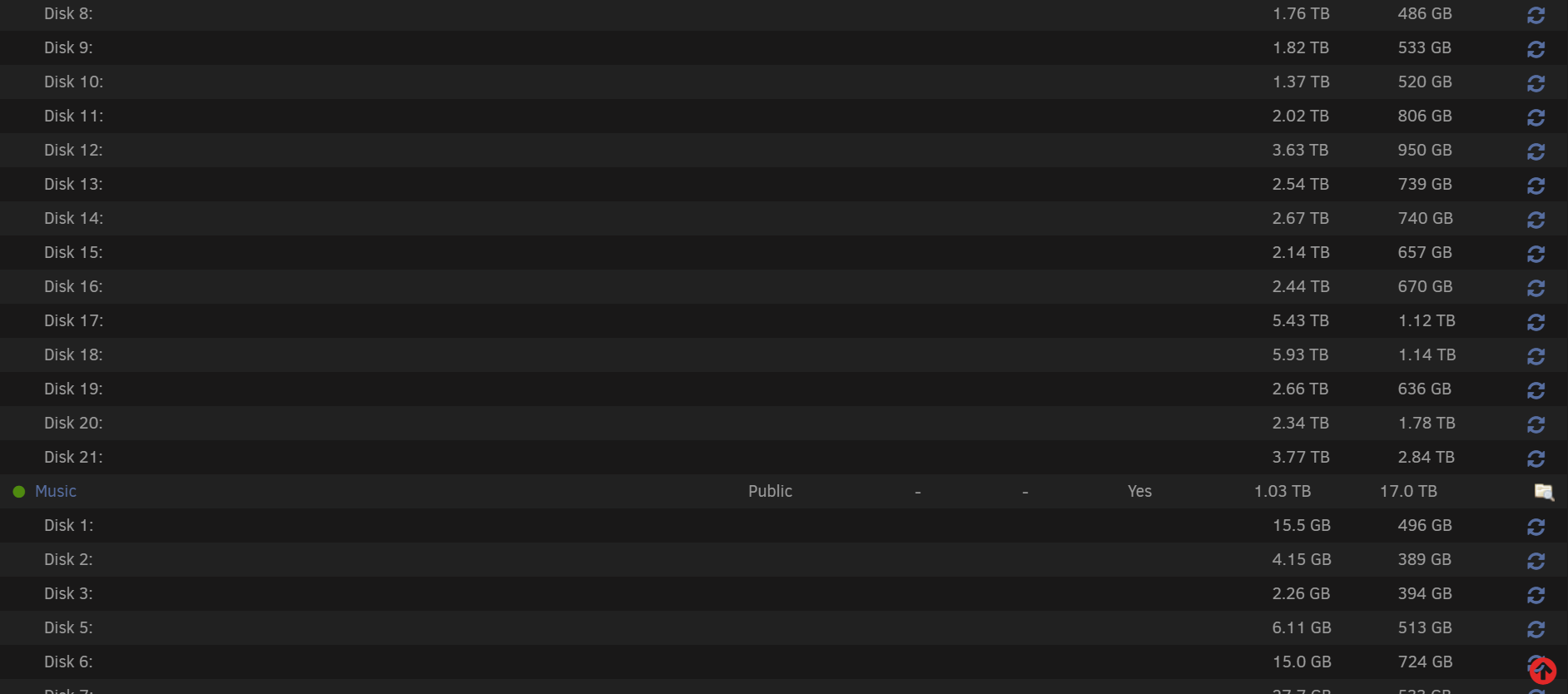

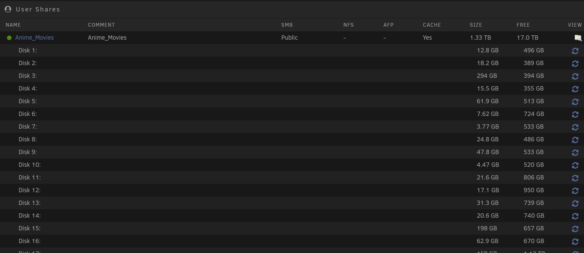

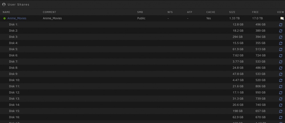

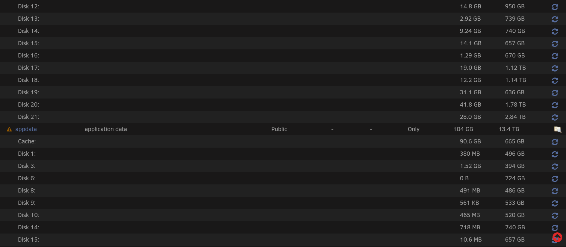

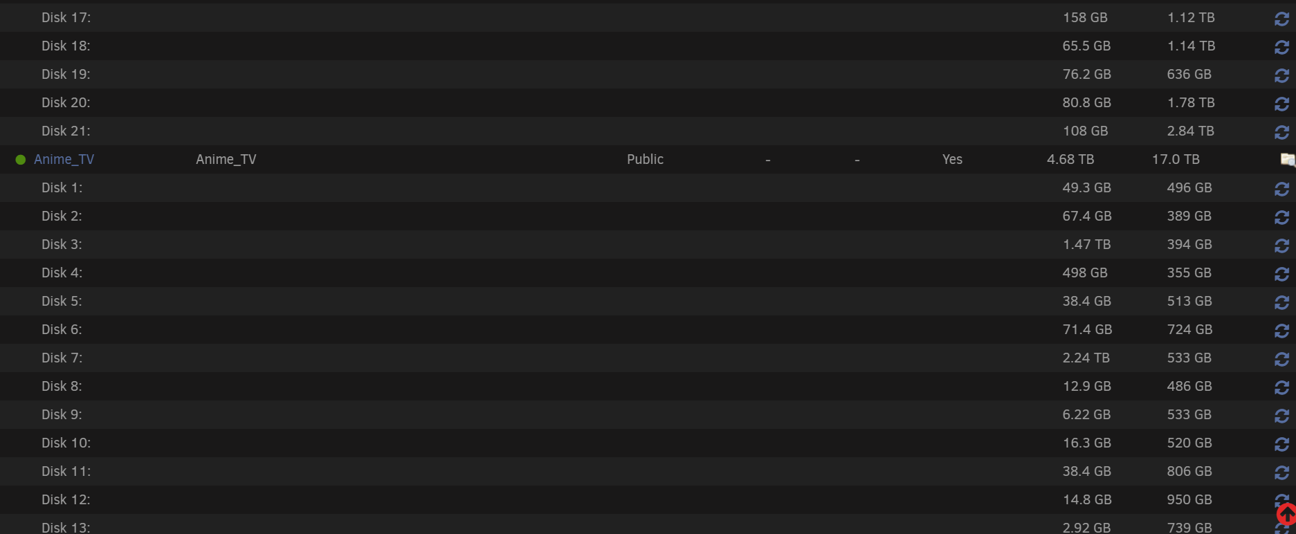

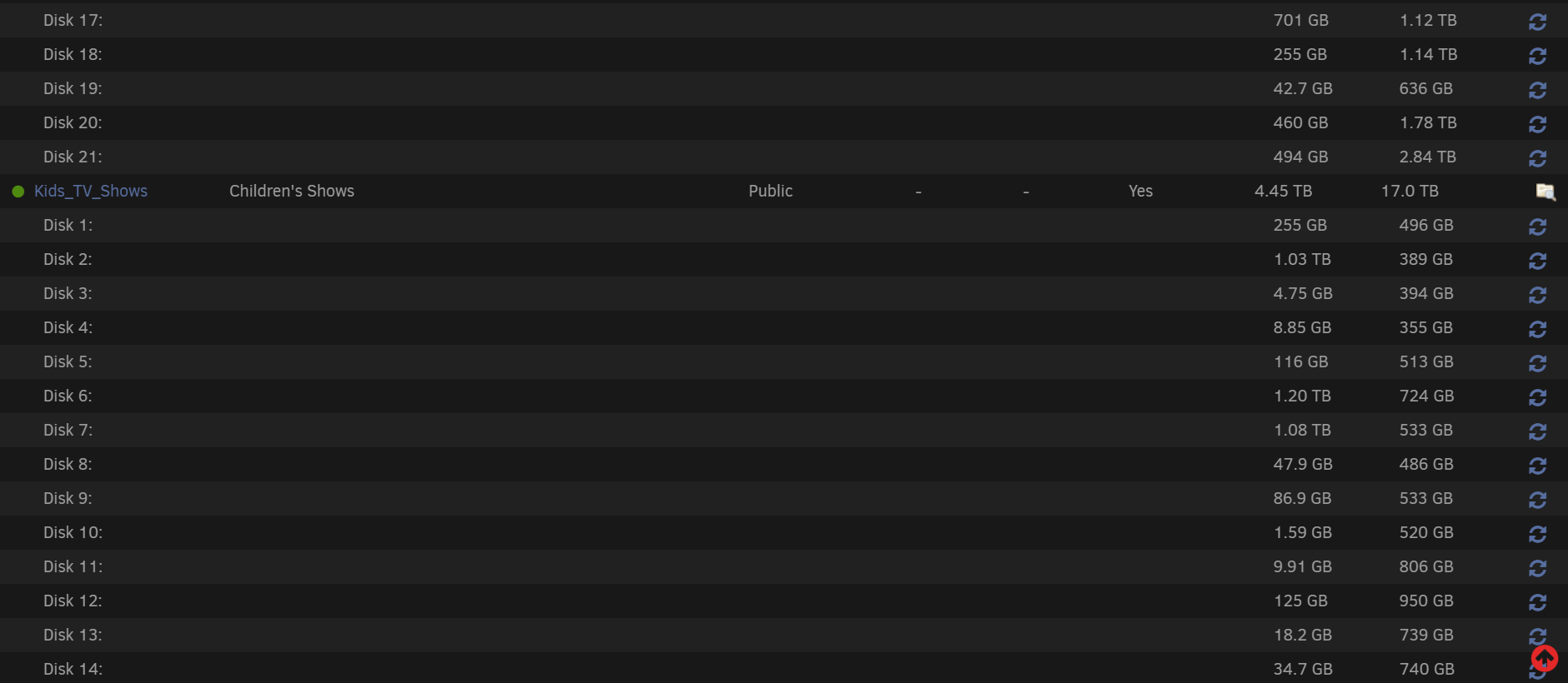

Go to Shares - User Shares, click Compute All. Wait for the result. If it doesn't appear after a few minutes, refresh the page.
Then post a screenshot of the results.

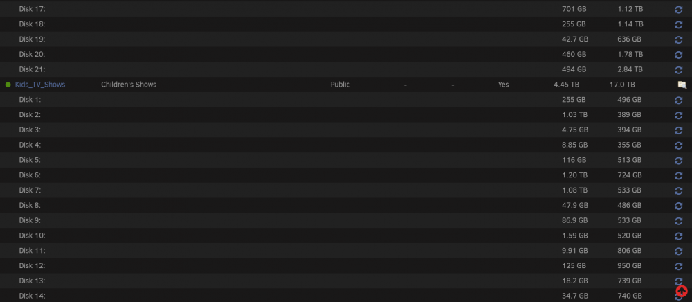

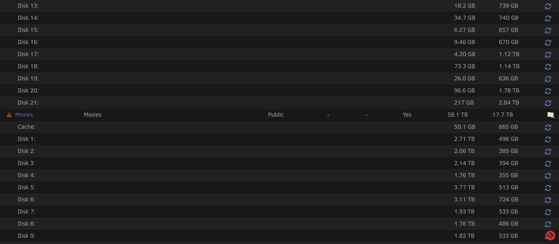

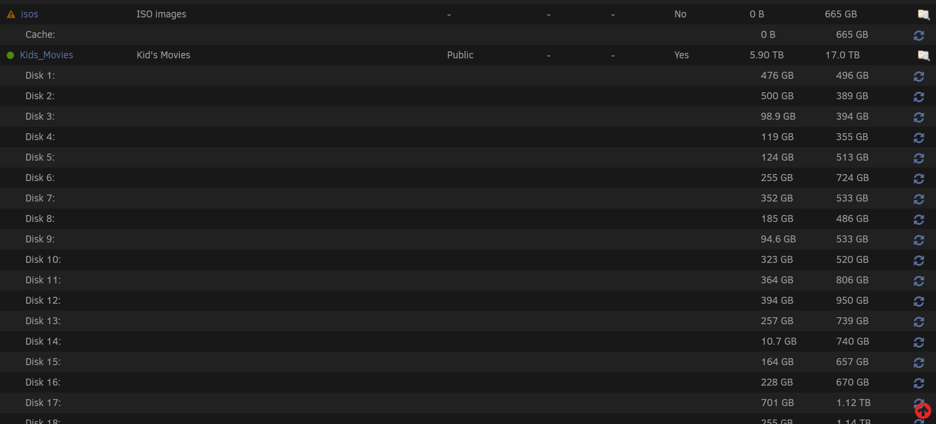

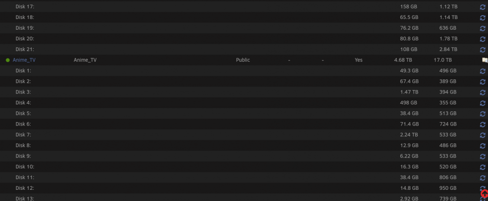

I have attached the screenshots from the compute all below sorry that there are 12. I ran mover again several times with docker disabled but those files in those directories just will not move. Its just a move and a couple episodes of a tv show so if we had to delete it it would not be a big deal but its weird that they are not moving. I have seen warnings about the particular movie thats stuck in the cache in the logs though. I don't know what to do but I have moved all I can and the Cache is now sitting at 335gb used. Let me know what you want me to do next.
Thank you,
-GTP
Lets go ahead with getting appdata, domains, system moved to cache. I'm going to bed now but I will go ahead and tell you what I have in mind for next. You can go ahead with it if you want or you can wait till tomorrow if you don't want to go without dockers or VMs until then.
Set appdata, domains, system shares to cache-prefer.
Go to Settings - VM Manager and disable VMs. Leave them disabled
Go to Settings - Docker and disable Dockers. On that same page, delete docker.img. Change its size to 20G. Leave them disabled
Run mover and wait for it to complete then post new diagnostics.
