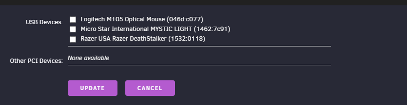

As a result, I am now able to activate IOMMU in the bios, start unraid and to passthroug my GPU when I edit my Windows 10 VM (I managed to find my graphic ROM BIOS) and the usb devices are detected :
NOTE : I tried to use the VFIO PCI Config plugin but the process just desactivate the group I chose into the VM, probably because of the "iommu=pt" command, I think), so as the device are there without any use of the plugin, I continue the process without it.
But when I select the USB devices, and then run the VM, the VM displays on my tv but I can't "press any key to start the boot from CD". The strangest thing is that the screen seems to remains blocked at this stage (when I do not select the keyboard in the VM USB Devices, if no key is press, the boot "continues" without any setup, but not with the keyboard selected) . I tried 3 différent keyboard, so I'm quite confident it is not linked to the device....

@mathieuhantz The usual way is to setup a VM without GPU passthrough via VNC, install the virtio drivers for network and make sure everything works. Enabling RDP or setting up remote software like Teamviewer or Anydesk is also a good advice, because as soon as you use a GPU for passthrough VNC should be disabled. Otherwise VNC will always be the primary GPU and the passed through one wont work.
The "PCIe ACS Override" option has nothing to do with passing through USB devices like the 3 showed in your screen. It is needed for splitting up groups for PCIe passthrough in case you have a USB controller itself grouped with other devices and you want to use the full controller inside the VM, same for GPUs or network controllers.
