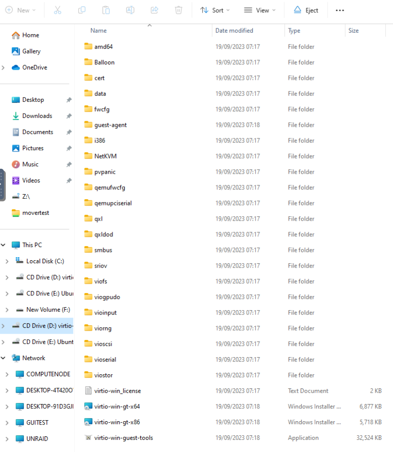

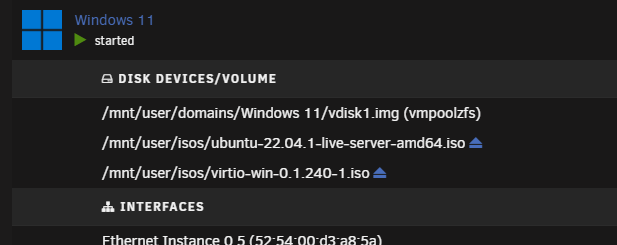

December 6, 20232 yr 40 minutes ago, SimonF said: Have you installed the guest agent in the VM? It is on the Virtio CD. Do you have step by step instructuons on how to install? I went into VM settings and clicked download on the latest drivers which saved to my ISO share folder but not sure what to do after that
December 6, 20232 yr Add the CD image to the VM either via the template or via the CDs if one is shown. You can eject and insert. Then in the VM browse to the CD and run guest tools. And they run
December 7, 20232 yr @SimonF i installed the virtio-win-guest-tools but am still missing sleep option. I just opened up the ISO from the shared cache drive which mounted it locally within windows and installed all the driver options available (0.1.240). I restarted and also tried once more to install and hit the "repair" option for good measure.

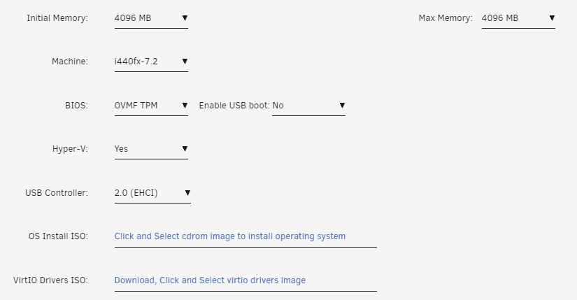

December 7, 20232 yr 5 hours ago, Linguafoeda said: @SimonF i installed the virtio-win-guest-tools but am still missing sleep option. I just opened up the ISO from the shared cache drive which mounted it locally within windows and installed all the driver options available (0.1.240). I restarted and also tried once more to install and hit the "repair" option for good measure. Not sure if you need it but I have seen posts stating having hyper-v enabled may cause this issue. Try with hyper-v set to No
December 7, 20232 yr 2 hours ago, SimonF said: Not sure if you need it but I have seen posts stating having hyper-v enabled may cause this issue. Try with hyper-v set to No Wouldn't this hurt vm performance which is what I'm trying to optimize (faster VM, less CPU usage, ability to save power/free up CPU & RAM by sleeping VM if idling for more than 30-60mins etc) Or am I confusing what hyper-V does and how to interacts with the changes I did to my VM XML from m00nman's optimization guide
February 14, 20242 yr On 12/7/2023 at 4:22 AM, Linguafoeda said: Wouldn't this hurt vm performance which is what I'm trying to optimize (faster VM, less CPU usage, ability to save power/free up CPU & RAM by sleeping VM if idling for more than 30-60mins etc) Or am I confusing what hyper-V does and how to interacts with the changes I did to my VM XML from m00nman's optimization guide bump - curious on if disabling hyper-v altering performance. i had finally tuned my windows VM for high performance (especially switching to microsoft RDP for access, installing intel-gvt for virtualized iGPU acceleration and following m00nman's perf thread. I did make a bunch of his XML edits which reference hyper-V so i don't want to then toggle the hyper-v in the non-XML edit of the VM which may cause issues with what i setup via @m00nman Edited February 14, 20242 yr by Linguafoeda
