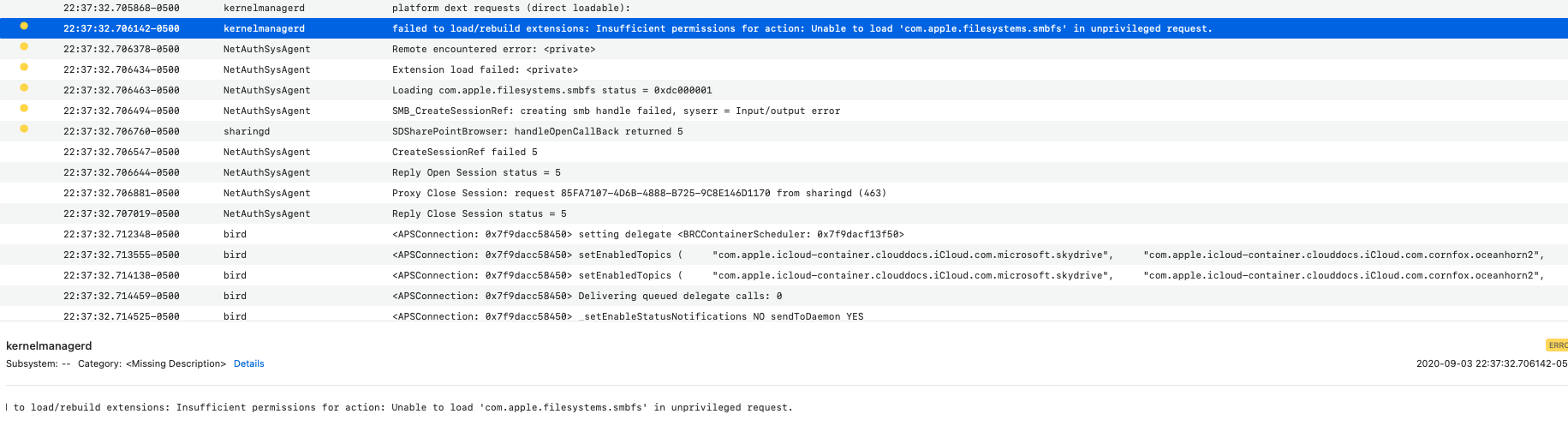

I started doing some digging to file a proper bug report (side note Apple updated my ticket and there are more than 10 reports on this issue) and it appears to be a permissions or kernel problem based upon the attached screenshot.
Mmm ok.  Is there a command that we could run on our Apple Big Sur that will fix the Permission ?? would be an easyfix! Probably not, but who knows! :)

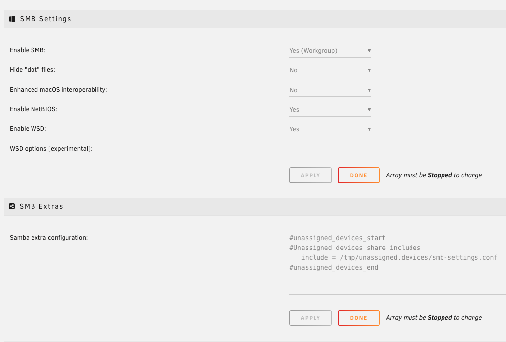

Can you post your smb config please?Which unraid version?
10 minutes ago, ghost82 said:
mmm this is weird...for me ahah :D
6.9 beta 30, settings are attached as a screenshot. AFP is beta 30 is no longer a thing, so it's SMB only.
