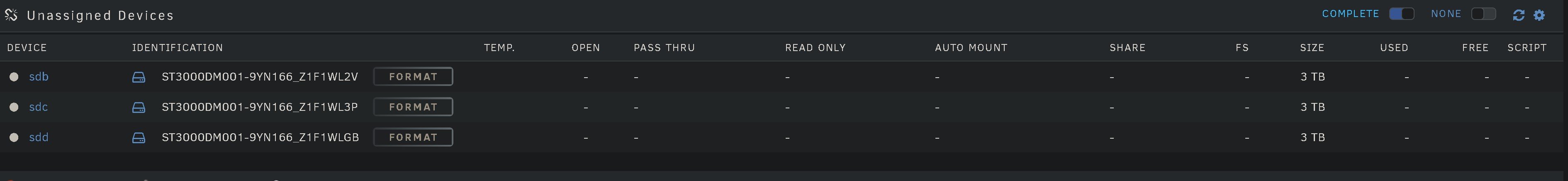

See if any of those unmountable disks mount with UD in read only mode.
It does not look like it, see screenshot.
Unraid can give an invalid partition error for various reasons like the MBR not conforming to what is expected or the partition not being the correct size, and that can happen when you for example change from a raid controller to a non raid controller or vice-versa, but in your case there are no partitions, so something else happened, if just the partitions are missing but the data is still there you can try unassigning one of the unmountable disks and starting the array, Unraid will recreate the partition and as long as the disks weren't wiped it might be able to rebuild it correctly, check if the emulated disk mounts and data looks correct, if it does, and only if it does, you can rebuild on top, then repeat for the other disks.
