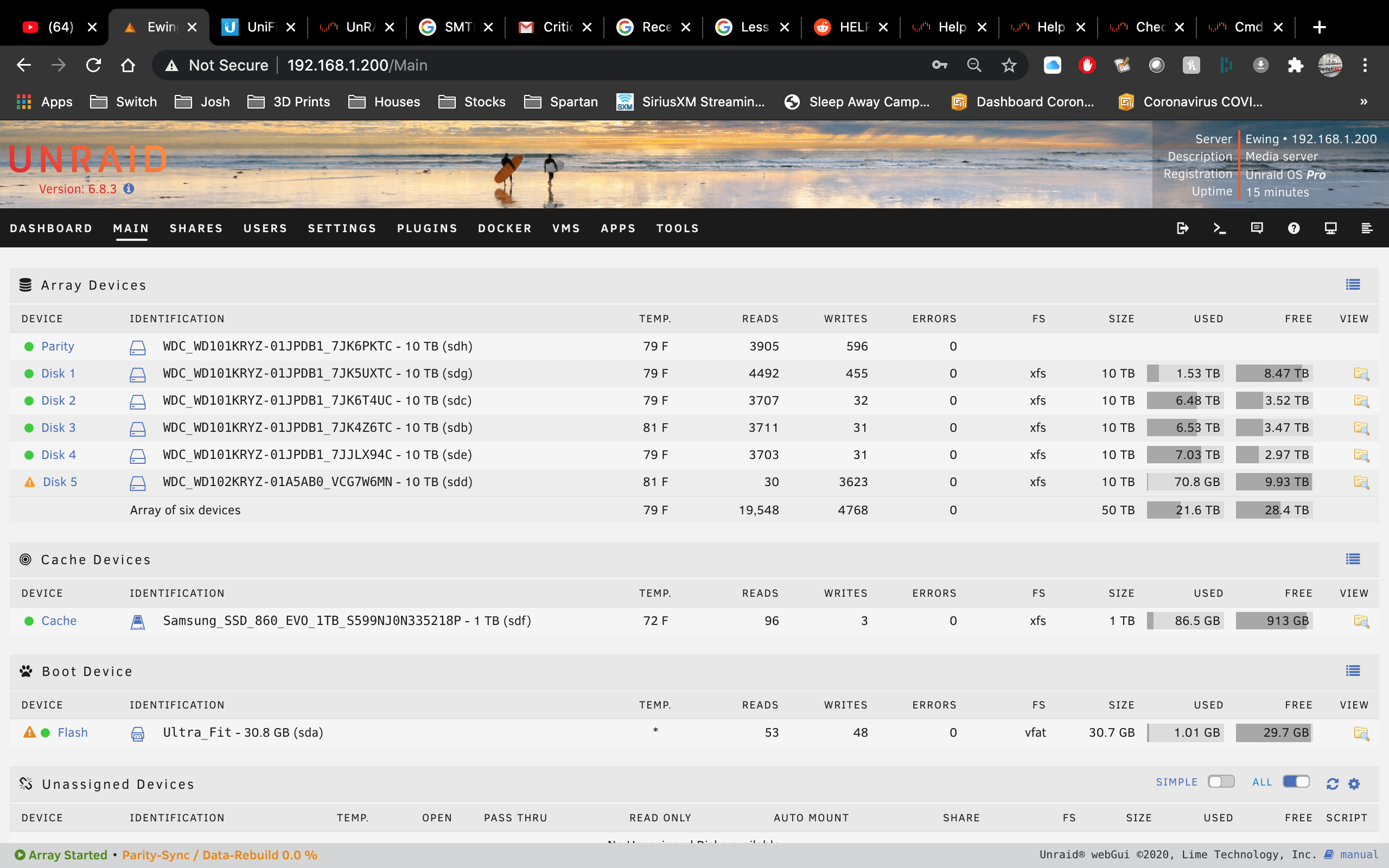

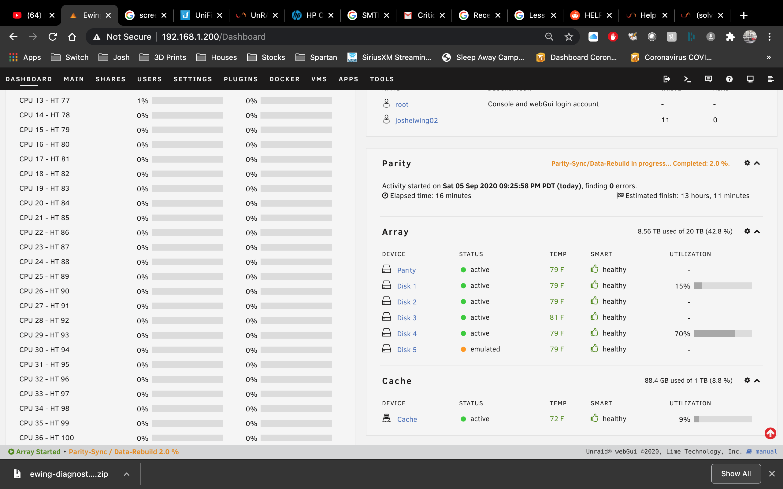

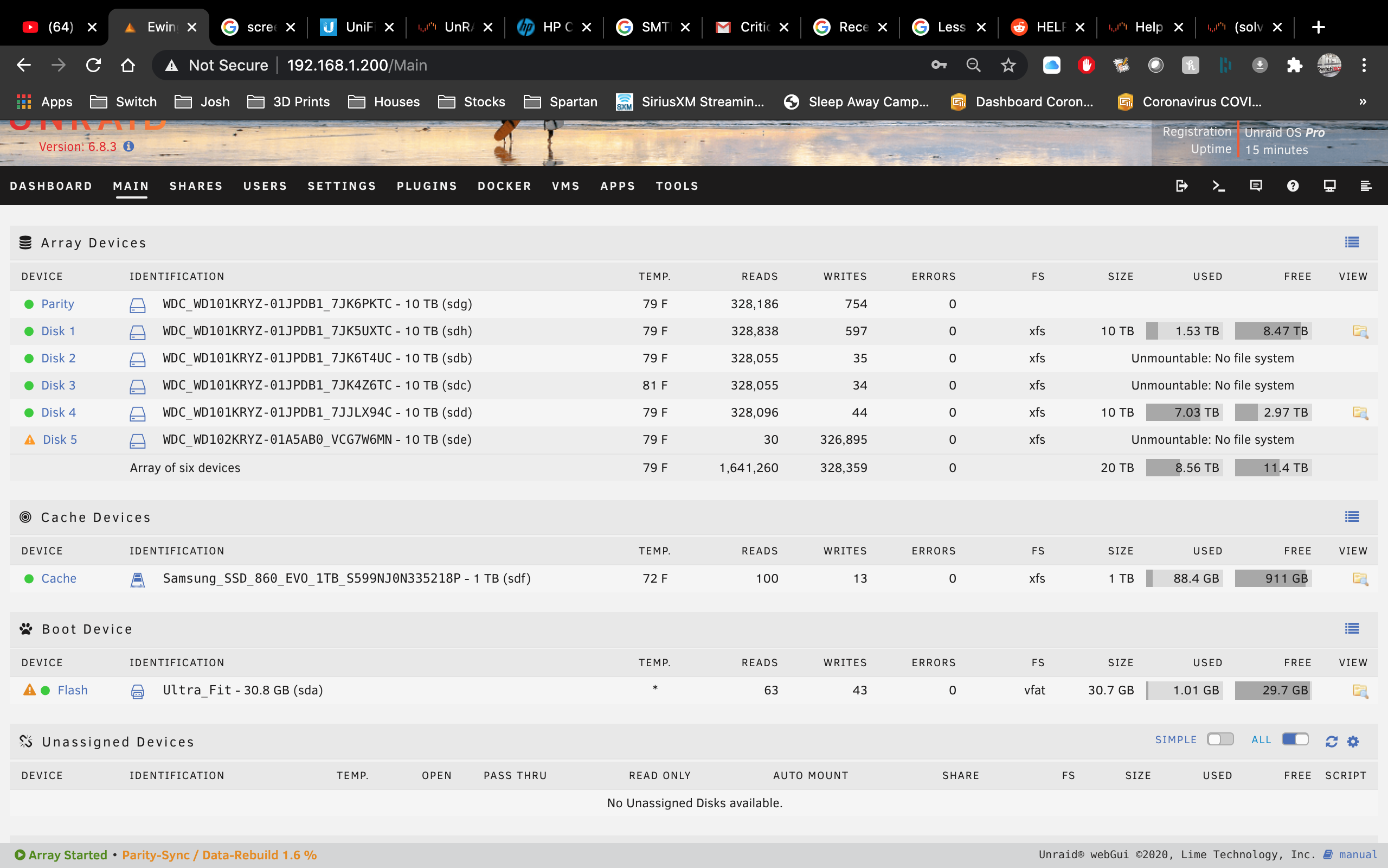

Had a 6TB WD Gold Hard drive fail on me and give me a read error and disabled itself.  Not exactly sure what happened.  I had a spare backup new 10TB that I threw in the system to replace it.  When I started the array it shows (2) of my other drives and the new 10 TB all as "Unmountable : No File System).  Its already starting the Parity Sync : Data Rebuild.  Not sure what my options are now to get these back online.  The 2 drives are my main Movie and TV show Shares for my plex server.  I have not started any dockers or VM's and am just letting this thing  go at this point.  Attached are my diagnostics.

Thanks.  Just woke up to find that is says Disk Read error on Disk 5 again even though it is brand new.  Not really sure where to go from here.  Going to swap out the Sata Cables this morning.  I also have a HBA controller I can throw in later I guess.
Post the diags before rebooting, it might show the problem.
Got it.  I had already shut down.  Will keep you posted.

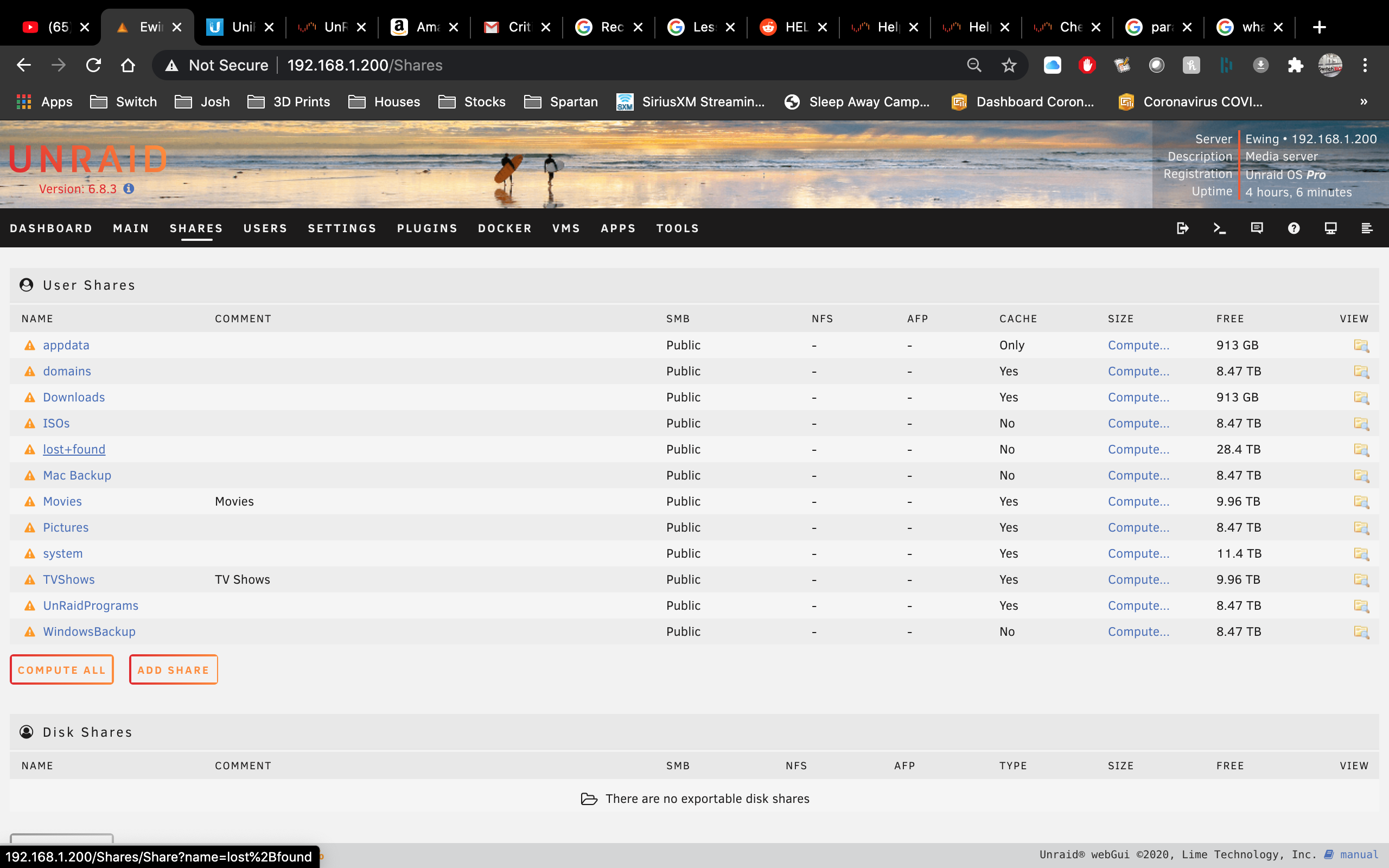

30% complete and going well.  I have not started anything and am just letting it do its thing.  One thing to note is that I did have a Share folder called "VM Storage".  I noticed even though disk 5 is "emulated" currently.  I cannot see my "VM Storage" share anymore.  I do however have a new share called "lost+found".  Any thoughts what this could be?  The fact that I got a "Disk 5 Read error" not just on the 6tb existing drive but again on the 10tb makes me feel the issue is not the drive.  Now that I already assigned the 10TB to disk 5's space I know I cant go back and put the 6tb in but can I plug the sata drive into another PC and pull the data off this 6TB drive?  Just incase the parity rebuild doesn't rebuild the VM Storage Data?
lost+found is where filesystem repair puts the data for files it can't figure out. Typically these will be difficult to use again, especially if there are a lot of them. The names of the files and the folders they belonged to is unknown.

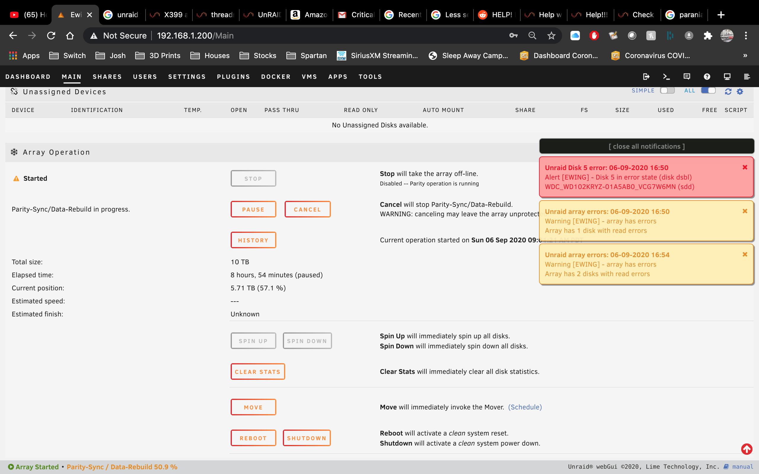

Well this totally sucks.  Failed again at 57% this time.  Grabbed the diagnostics attached before shutting down.  Where to go from here????
ewing-diagnostics-20200906-1756.zip
Problems writing disk5 and reading multiple disks. How are these connected?
All Sata drives are connected to the onboard sata ports on my new Asus Zenith II Extreme Alpha.  I don't have.  I honestly feel like there is (1) corrupt File which is causing all this.  when trying to recover.  Also noticed disk 4 had a ton of errors now.  Hopefully you can see from the diagnostic file.

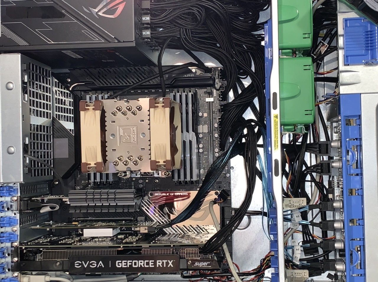

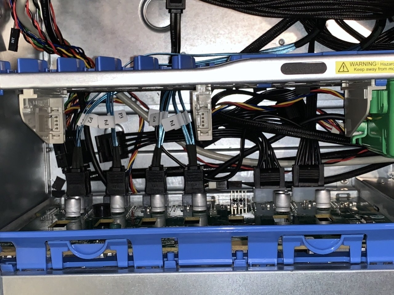

Also replaced all SATA cables this morning not necessarily trying to make neat.  I'll grab a pic in a few min.  I actually have (1) spare spot on the motherboard so I can swap to that.

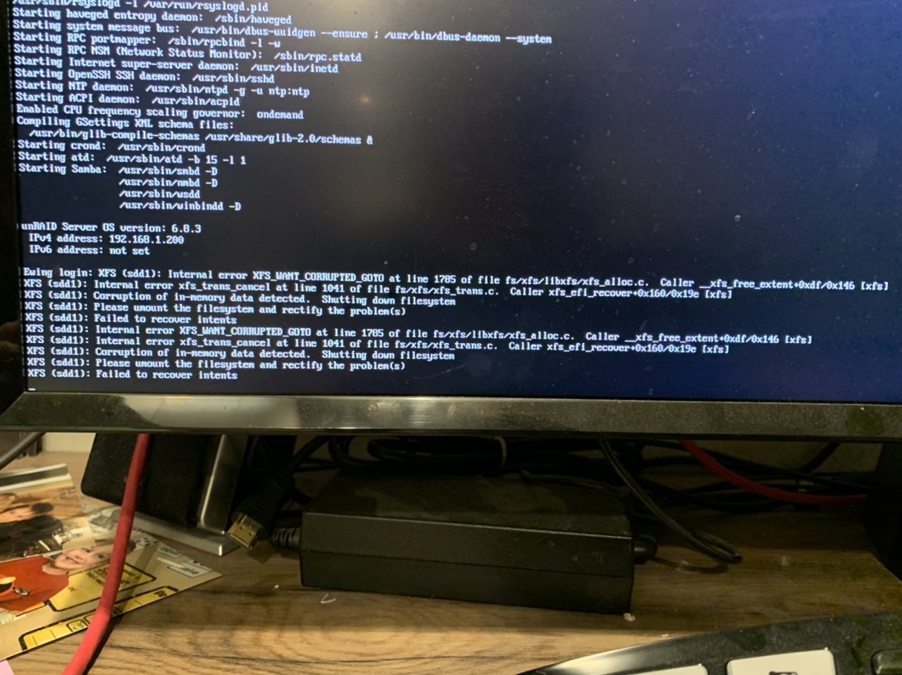

After reboot again tried mounting the drive and noticed the following since it would not mount again.  Pic of monitor.
then I threw in the IT Mode HBA cards and some new cables again.  I’ll try rebuilding this way.
It's a problem with the onboard SATA controller, quite common on AMD boards, there are reports that running the latest beta helps due to newer kernel, disabling IOMMU should also help if not needed.
