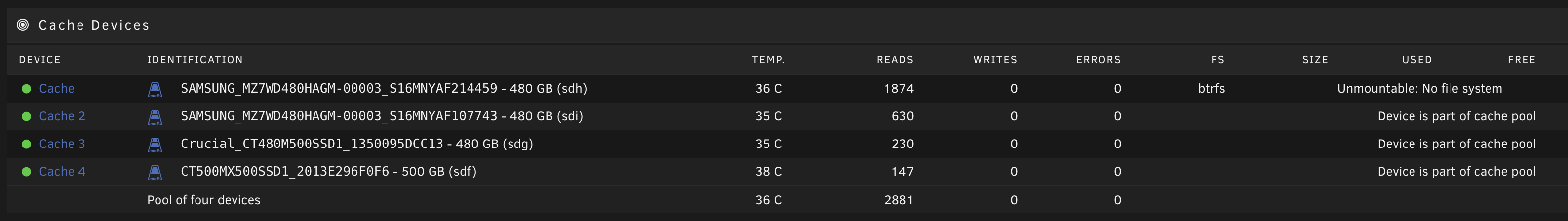

But... whilst the offending disk shows as a 'new device', now one of the other other 3 disks is showing as Unmountable: No File System
I've tried stopping the array again, and removing/re-inserting the disk. I've also tried putting the old disk back in, but I don't seem to be able progress from here.
Is this recoverable? I have partial backups, so not all is lost, but annoyingly I think my PLEX instances were on my exclude list, and probably my biggest 'loss'
Although, perhaps I'm just being a dunce - is the Unmountable message just reflecting that the pool as an entirety can't be mounted?

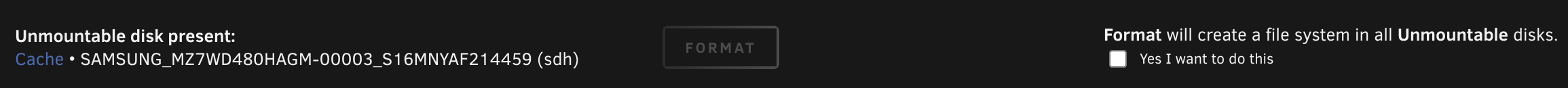

It's prompting me to format the 'lead' disk in the cache - it was cache 4 which I swapped out

According to syslog you're missing two devices:, devid 3 and 4, it's detecting 2 new devices.
Sep  6 17:31:02 DEMETER emhttpd: cache uuid: c8f42191-039e-41d8-894d-bdd878c15864
Sep  6 17:31:02 DEMETER emhttpd: cache TotDevices: 4
Sep  6 17:31:02 DEMETER emhttpd: cache NumDevices: 4
Sep  6 17:31:02 DEMETER emhttpd: cache NumFound: 2
Sep  6 17:31:02 DEMETER emhttpd: cache NumMissing: 1
Sep  6 17:31:02 DEMETER emhttpd: cache NumMisplaced: 0
Sep  6 17:31:02 DEMETER emhttpd: cache NumExtra: 2
Sep  6 17:31:02 DEMETER emhttpd: cache LuksState: 0
Sep  6 17:31:02 DEMETER emhttpd: shcmd (408): mount -t btrfs -o noatime,nodiratime,degraded -U c8f42191-039e-41d8-894d-bdd878c15864 /mnt/cache
Sep  6 17:31:02 DEMETER kernel: BTRFS info (device sdh1): allowing degraded mounts
Sep  6 17:31:02 DEMETER kernel: BTRFS info (device sdh1): disk space caching is enabled
Sep  6 17:31:02 DEMETER kernel: BTRFS info (device sdh1): has skinny extents
Sep  6 17:31:02 DEMETER kernel: BTRFS warning (device sdh1): devid 3 uuid 91c09af4-c319-4ef1-a89e-17b8b9080b28 is missing
Sep  6 17:31:02 DEMETER kernel: BTRFS warning (device sdh1): devid 4 uuid 20de7db3-546e-45a6-b08b-919ab79effeb is missing
Sep  6 17:31:02 DEMETER kernel: BTRFS warning (device sdh1): chunk 1009532010496 missing 2 devices, max tolerance is 1 for writeable mount
If you just replaced one there's a problem with another one, which is not being detected as a pool member, any idea why that would happen, did you do anything else?
I did swap 2 of the disks around (the 2x Samsungs) - that was because I thought the 'unmountable filesystem' message was specific to that disk, so swapped the bays over to check it wasn't a connection issue. But I checked the assignments still matched before moving on.
If by swapping you mean just changing slots that wouldn't be a problem, something else must have happened, or the pool was already missing a device, you can try the old cache device if you still have it untouched, if not you can't recover the pool with 2 missing devices.
