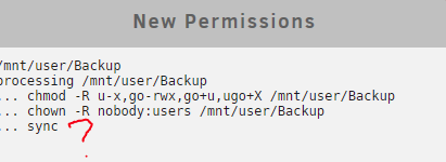

Yeah seems like shares are working like normal, but i am worried about my docker installation: "Note that this tool may negatively affect any docker containers if you allow your appdata share to be included."
As i said, i though by selecting the share and then selecting all drives it would only target the particular share that may be spread over _all drives_ but it ran on everything, i cancelled the command pretty quickly but it ran through entire /mnt/cache so everything is nobody:users now, is this bad?
I've not noticed any issues, but i really want to know what kind of issues this can create and if there's something i can do to restore it to whatever it was before i made this mistake?

So what i read this will only be a problem on particular docker containers that may run as a special user, i don't believe i have any of those, everything seems to use UID 99 GID 100 UMASK 000 which pretty much already is nobody:user ?
Follow up questions:
1. when  i first accidentally ran the command on everything i exited out before it had completed, issues could occur yes/no?
2. what exactly is it doing when it says "sync" ? Since i exited out before it had completed obviously it missed syncing, i have no idea what syncing means so i need to know what that does so i can figure out if i will have issues
Edited by je82
no.  It just cancels the script
Flushing all the writes from RAM to the hard drive.  Akin to "Safely Eject" on Windows for USB.
