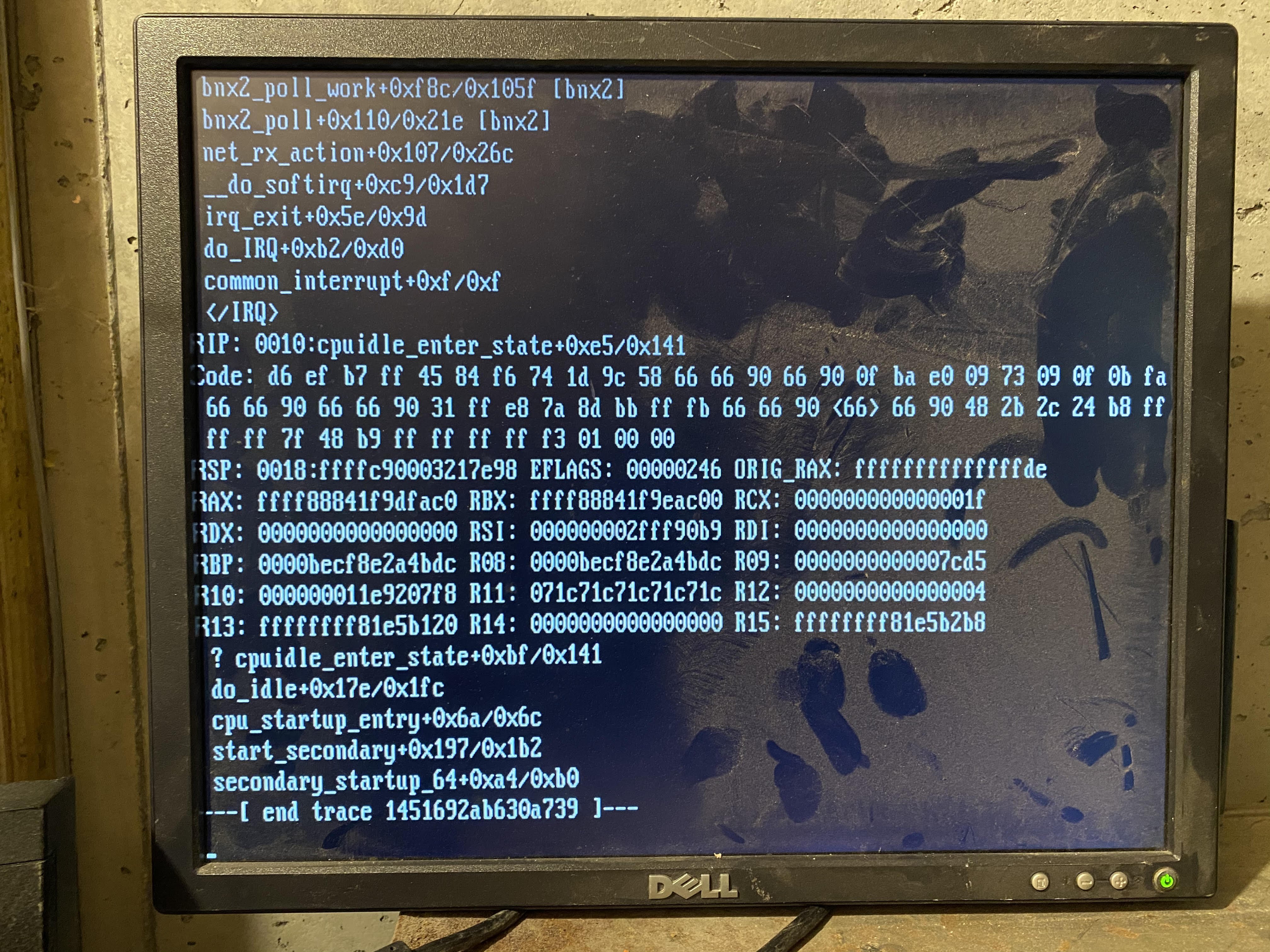

Over the past couple weeks, my array has become unstable where about daily it becomes unresponsive and an error trace is displayed on the monitor. A forced restart is needed but usually twice as the first reboot the server isn't visible on the network for some reason. Today, even though it boots, Docker refuses to start. Diagnostics and pictures of the last couple error traces attached. I also have the syslog saved to flash but it's ~65MB -- can't upload so here's a link. Wondering if it's a hardware or software issue -- I'm lost. Any help would be greatly appreciated.

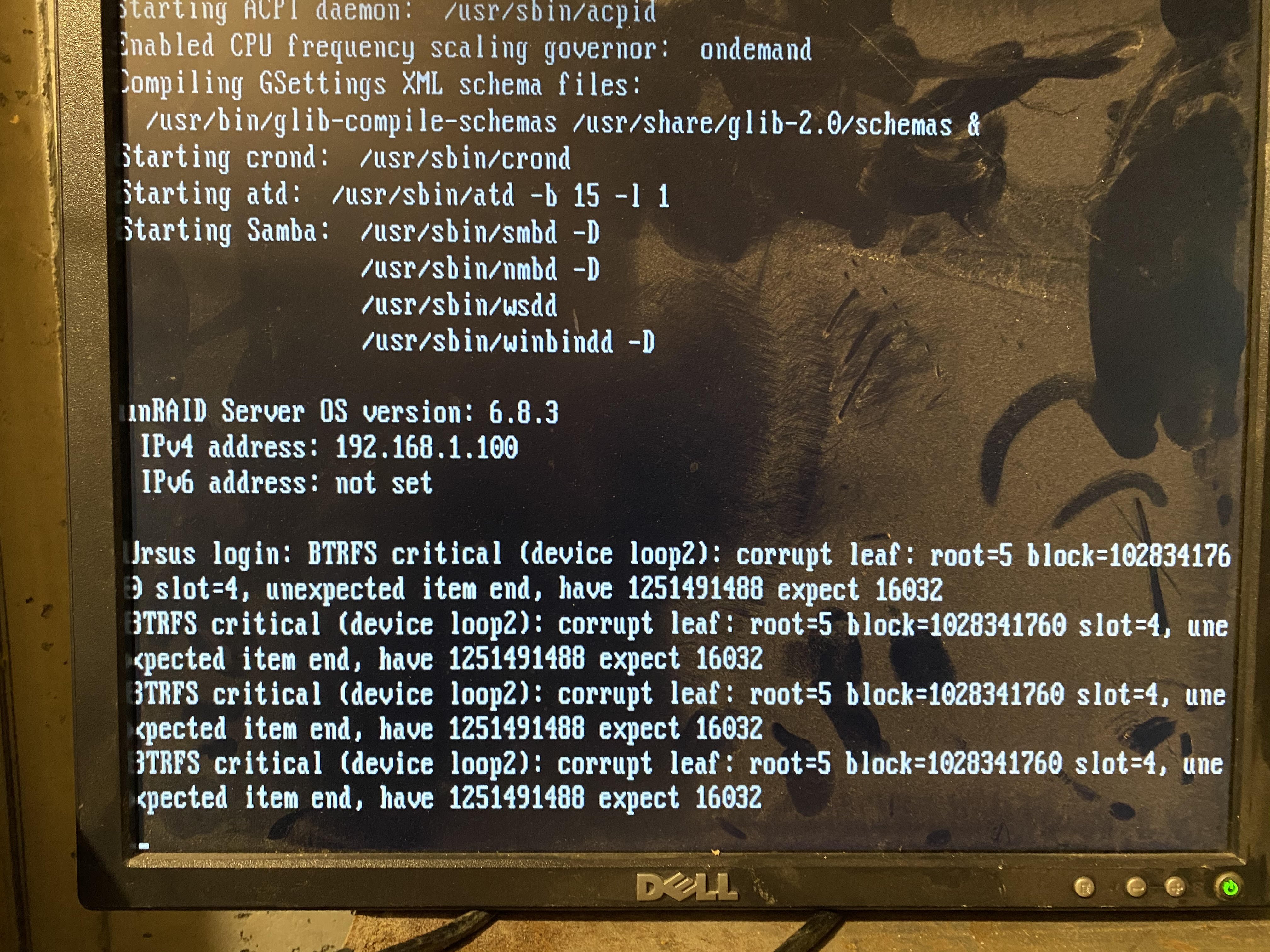

Your docker.img is corrupt. You will have to delete and recreate it. Then Previous Apps on the Apps page will reinstall your dockers just as they were.
Since you allocated 64G to docker.img, I wonder if you have had problems filling it up. 20G should be more than enough. I'm running 17 dockers and they take less than half of 20G. Making it larger won't fix anything, it will just make it take longer to fill.
The usual cause of filling docker.img is apps writing to a path that isn't mapped. The most common mistake is specifying a path in an application that doesn't correspond to a container path in the mappings. Linux is case-sensitive, so /download and /Download are different paths, for example.

Here's what was on the display at the latest crash just before Docker started failing to start. I presume this led to the Docker img getting corrupted. The array (without Docker) has been up for ~36 hours now which is unheard of as of late. Not sure what "unexpected item end" is or if it's related to the img getting full. I'll look into it -- my kids were running a couple Minecraft servers but everything I was running is pretty standard fare.
Those messages mean the docker image is already corrupted, you need to recreate it.

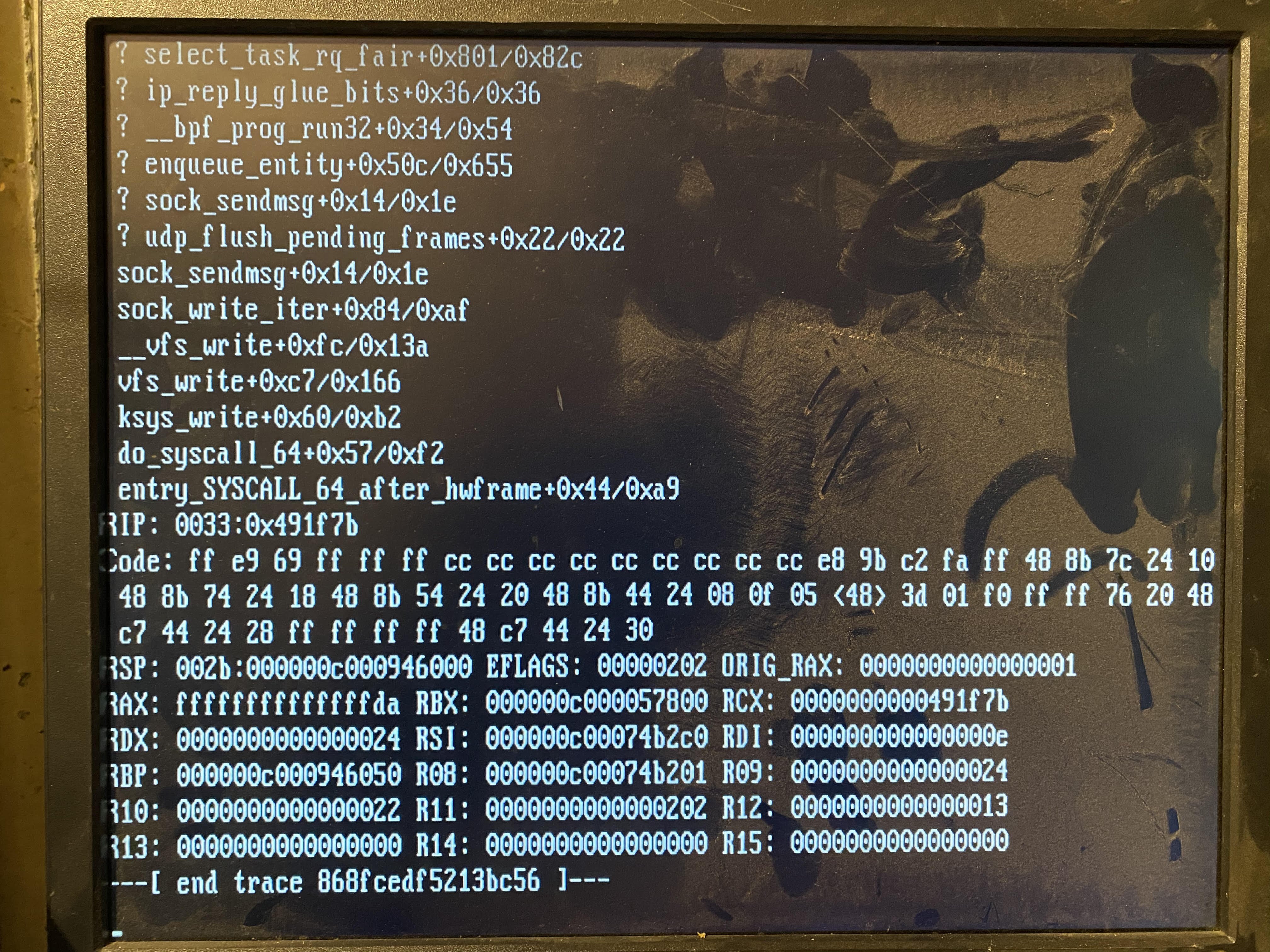

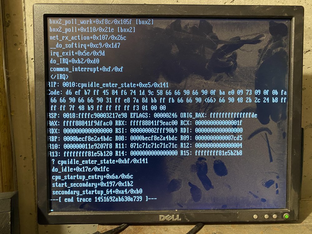

Haven’t been running the suspect Docker and still unstable. Here are pics of the error(s) on display when I go to reboot. Send to be a similar corruption. Also I’m still having the problem that I have to reboot twice to get network connectivity.
post new diagnostics
Docker image is corrupt, you need to recreate it.
