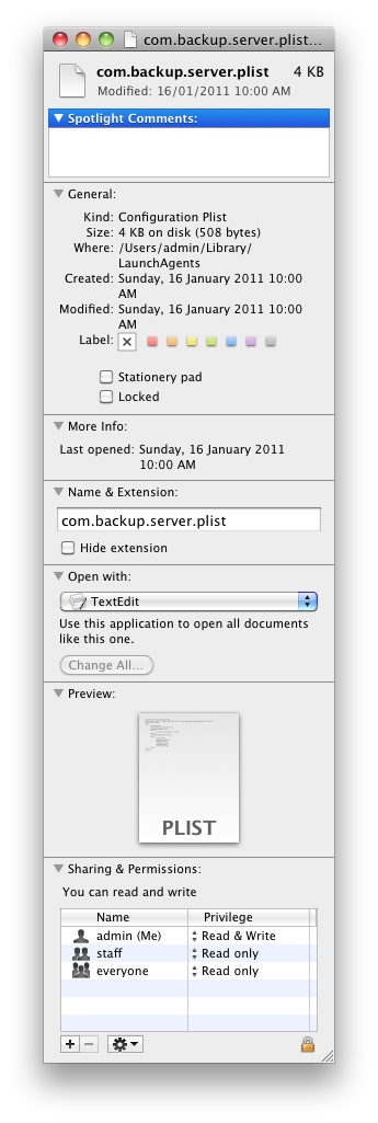

Also, remember to put in the LaunchAgents folder in your user folder. If you use the main Library folder, it won't work.

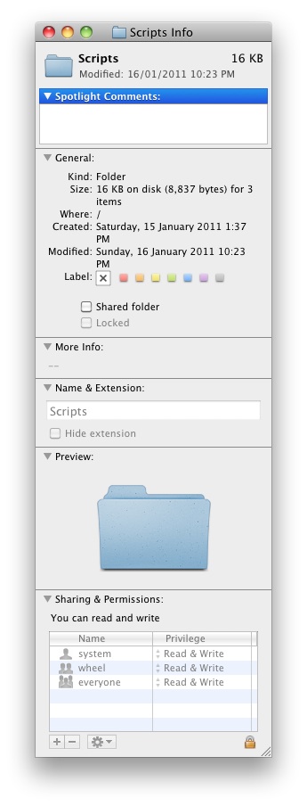

I'm not having those issues. You need to run them from your user folder launch agents. If you run from the main Library Folder, it will run as root. There's no way around this as far as I could see.
Here's screenshots of my setup.
