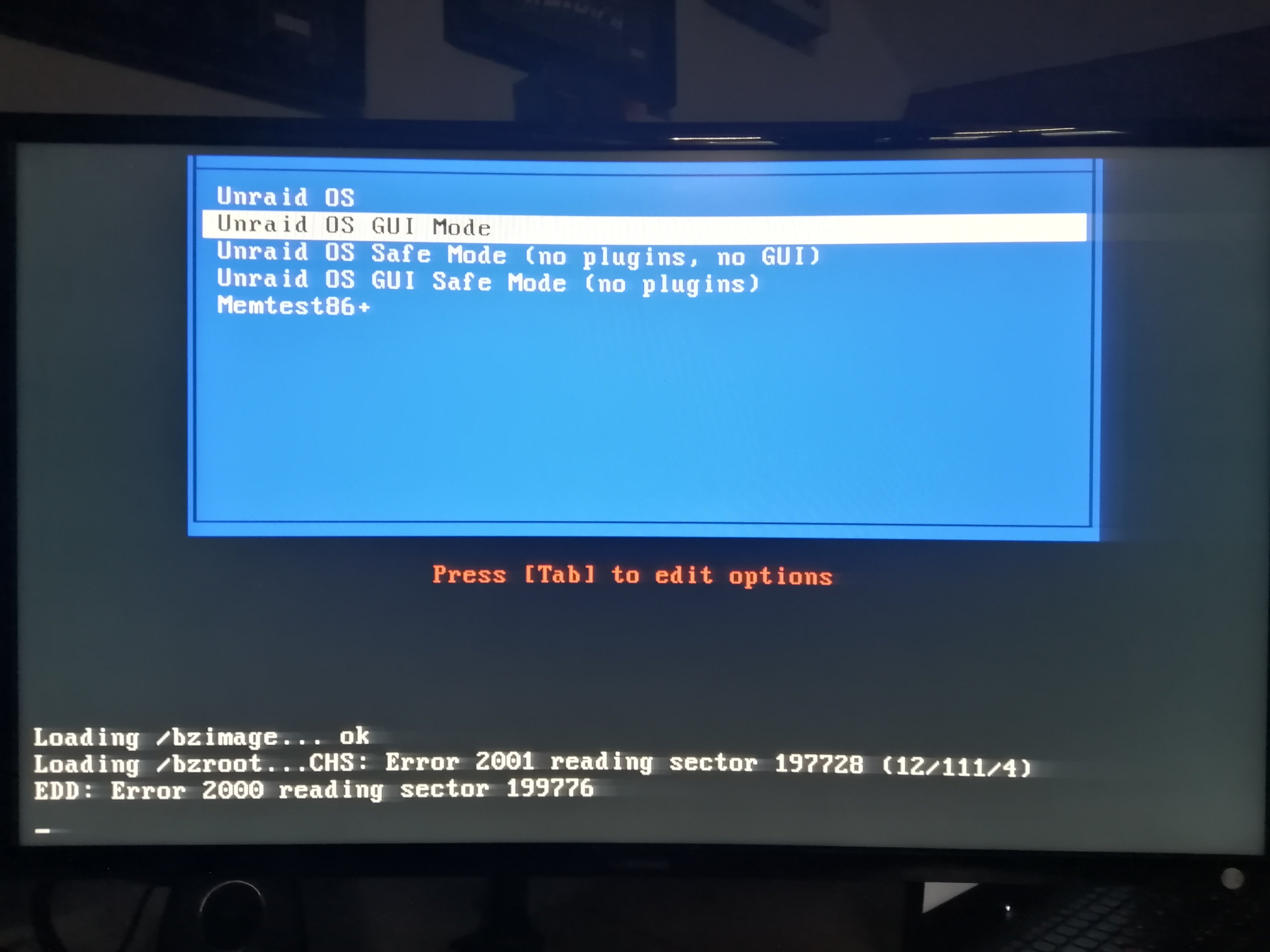

I have a very urgent problem my server does not start anymore !
the error is EDD: error 2000 reading sector and I saw on the forum that it is linked to my usb key, except that I don't have a backup if I move the config folder of my key to another with a new unraid installation will it work ?

It should, you can also try to backup and reformat that flash drive first.

Ok, you have a tool to advise me to save my usb key please ?
Backup current config folder if still possible, and reformat the flash drive,  with Windows or using the Unraid USB tool.
ok, i will do that now
