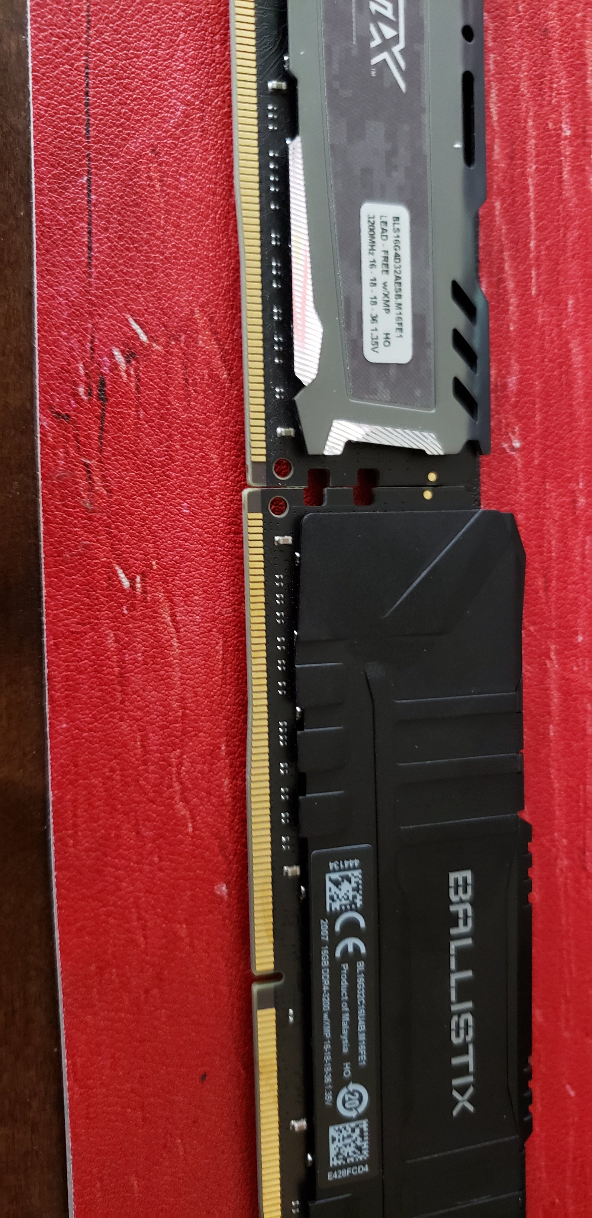

in my setup, I have 4 ddr4-3200 16G sticks.  2 were bought 6 months ago, 2 were bought this last tuesday.  They are both Balistix, but one of them is called Balistix Sport.  I know this is not an Unraid issue any longer, but maybe, just maybe someone would be nice to school me on why I am obviously having a memory issue when I am using the same speed memory?

memtest failed when all 4 sticks were put in together.  If I did 2 at a time of the same exact type, it passed in each of the slots (4 slots).  I must not be understanding memory when it says dd4, 3200, I thought it would be ok to purchase.
looks like you're mixing single rank with dual between those two types of sticks.  Don't know if that is considered a big no-no.  But since you're running dual rank in [some] configuration with 4 sticks, try lowering the RAM speed to 1866, since 2133 might be considered an overclock.

thanks for the reply!!! How can you tell the difference?  Did I miss something stupid or is it just an experience thing?
Just looking through your diagnostics says everything about your configuration, which is nice to spot things like this.  Looking at system\meminfo.txt in the diagnostics, it lists details about your memory. Two of the sticks say this:
Speed: 2133 MT/s
Manufacturer: Unknown
Serial Number: E0F78509
Asset Tag: Not Specified
Part Number: BLS16G4D32AESB.M16FE
Rank: 2
While two other say this:
Speed: 2133 MT/s
Serial Number: 00000000
Part Number: F4-3200C16-8GVKB
Rank: 1
Then referring to this for the proper speed

Awesome, thank you for the help.  I thought that the speed of the RAM was reflected in the number after DDR4... in my case, it is 3200.  RAM has always been difficult for me, and I thought I had it worked out, but obviously, I haven't and need to read a bit more.  Thanks for the schooling.
No prob. and that is the advertised speed that the memory itself can operate at - but it is dependent on if the CPU and motherboard support that speed as well.  In the case of Ryzen, there are a lot of factors that come into play.

so, since I believe I have 1st gen Ryzen, I should go into my bios and downgrade the DDR4-3200 RAM that I have to the max that is allowed.  Or, if I am leaving it at 3200, I am basically overclocking the RAM.  Correct?  Or, even better... dump Ryzen and go with Intel and swap motherboard and cpu out...
I believe you have a second gen Ryzen, but then again AMD's naming convention confuses me.  Set the memory speed to 1866 in the bios and try running a few cycles of memtest with all of your RAM installed and see how that goes.  If it passes then that was probably the cause of all of your issues.
