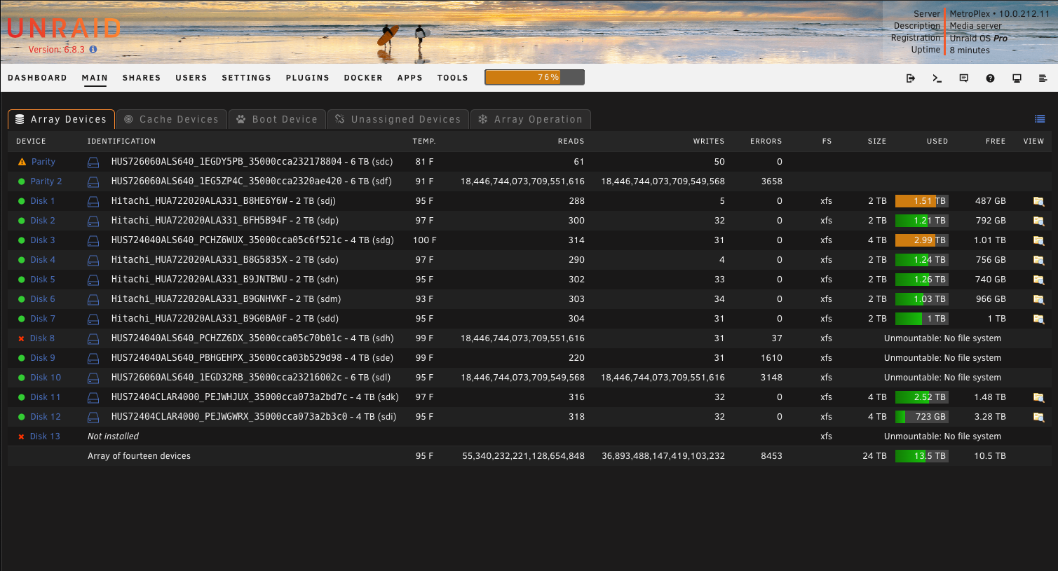

WTF?  I powered down, checked connections, started back up and suddenly have 4 drives saying they are unmountable with no file system! Trying to run another diagnostic but it's taking forever.
There are errors on multiple disks, this suggests a controller/connection/power problem, rebooting should bring the unmountable disks online, at least most of them, some might need a filesystem check, but don't try to do it before rebooting, also try to at least get the syslog before rebooting, even if you need to do it manually:
