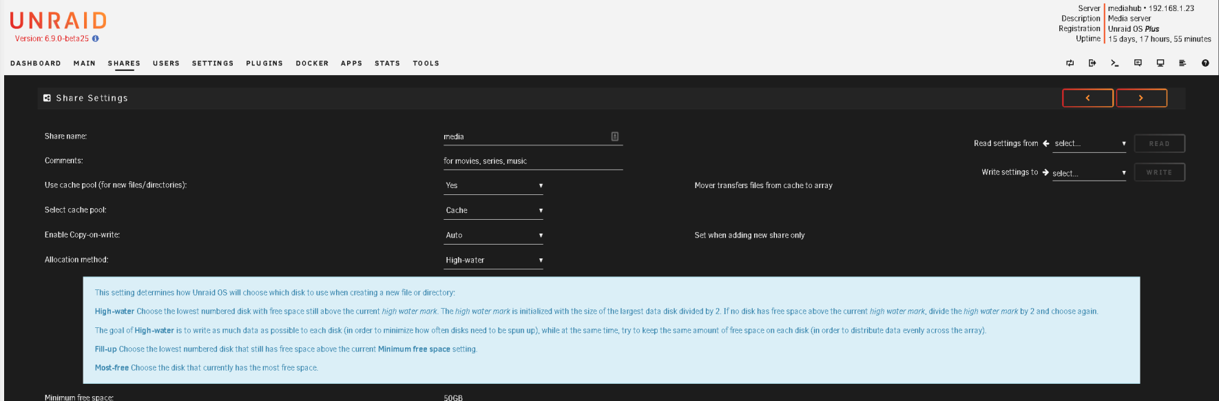

September 8, 20206 yr As said by jonathanm, It is advised not to use a cache drive during the initial data transfer, exactly to prevent the issue you have. I don't know how it will behave if you pause, make some changes and restart. But as you said, the file being pause would probably be an issue. Are you moving or copying the data from your original location ? Regarding the file allocation, it seems normal to me. It is specified in the share settings. The Default is High Water : the first disk is filed to half it's size then it can go to another disk depending of the size of each drive. You can see what is in each drive on the Main tab. Click on the small folder with the magnifing glass. You will not be able to see the files, but you will be able to see the directories.
September 8, 20206 yr Author 4 minutes ago, ChatNoir said: As said by jonathanm, It is advised not to use a cache drive during the initial data transfer, exactly to prevent the issue you have. I don't know how it will behave if you pause, make some changes and restart. But as you said, the file being pause would probably be an issue. Are you moving or copying the data from your original location ? Regarding the file allocation, it seems normal to me. It is specified in the share settings. The Default is High Water : the first disk is filed to half it's size then it can go to another disk depending of the size of each drive. You can see what is in each drive on the Main tab. Click on the small folder with the magnifing glass. You will not be able to see the files, but you will be able to see the directories. High Water explains it....didnt know what that was. I'll try to figure out a good place to pause the transfer and see what I can figure out....hopefully it wont ruin the data. I was under the impression it moved data off cache once a day but also as the cache got filled to a certain point that it started off loading to make room for more.

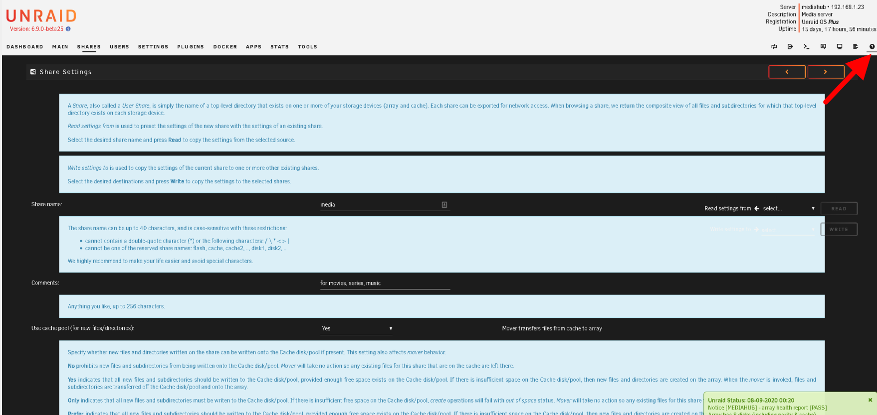

September 8, 20206 yr 5 minutes ago, SPOautos said: High Water explains it....didnt know what that was. Most (maybe all ?) menu line have a built-in explaination. You can either: click on each line to see the details temporarly activate the Help on the top right corner
