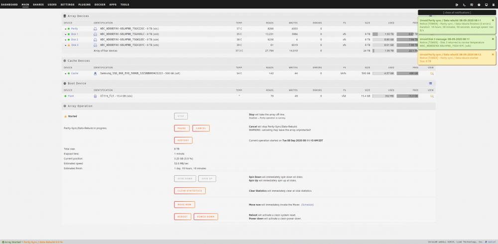

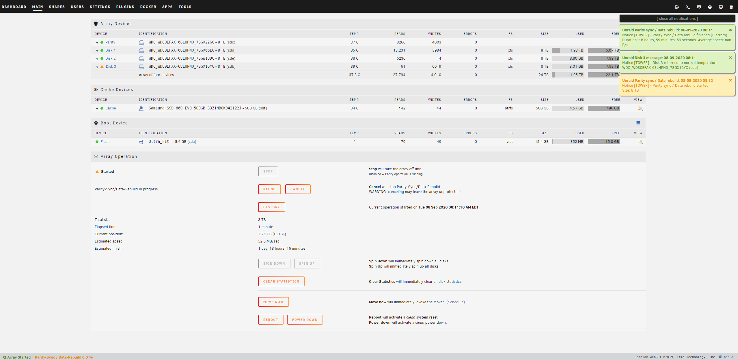

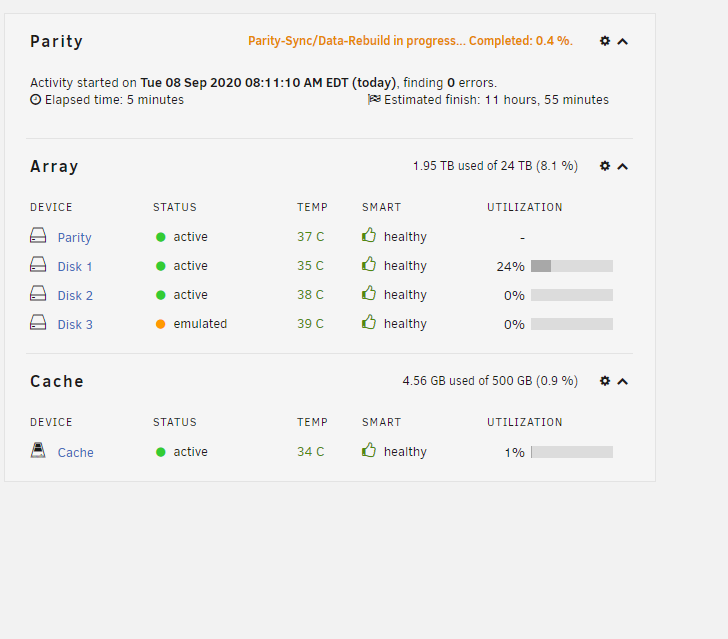

I wanted to replace a 1tb with an 8tb (that is the size of my parity as well).  Followed instructions and started the rebuild.  I ran mover but I realize now maybe not do extra stuff during the process.  Woke up this morning and tower was not responding at all and couldn't connect via putty.  I did a hard reset and it popped right back up but I noticed some weird stuff.  Had a message that said the drive was rebuilt and that it was rebuilding it as well (see attached pics).
I turned off all the dockers except plex and foundry VTT (neither should be writing etc).
My question is does it look like I am ok and just need to wait for the rebuild to be done?
I think I got lucky here and just have to wait correct?
That's what it looks like.
Thanks bud.  I know it's a super basic question but it makes me feel better.
did you have any Data on the 1TB drive that you are replacing ?
Because from the dashboard picture you posted it looks like disk 2 and 3 are empty.
