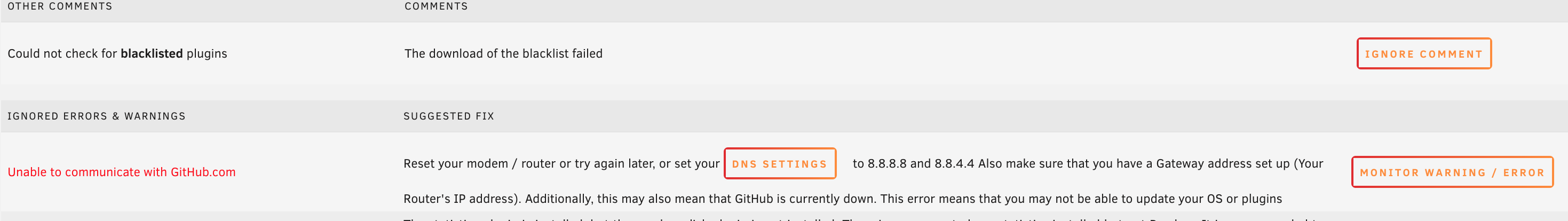

September 10, 20206 yr Do a scan with fix common problems. As I recall your diagnostics didn't show that it had any problems with internet
September 10, 20206 yr Author 3 minutes ago, Squid said: Do a scan with fix common problems. As I recall your diagnostics didn't show that it had any problems with internet It shows no connection.
