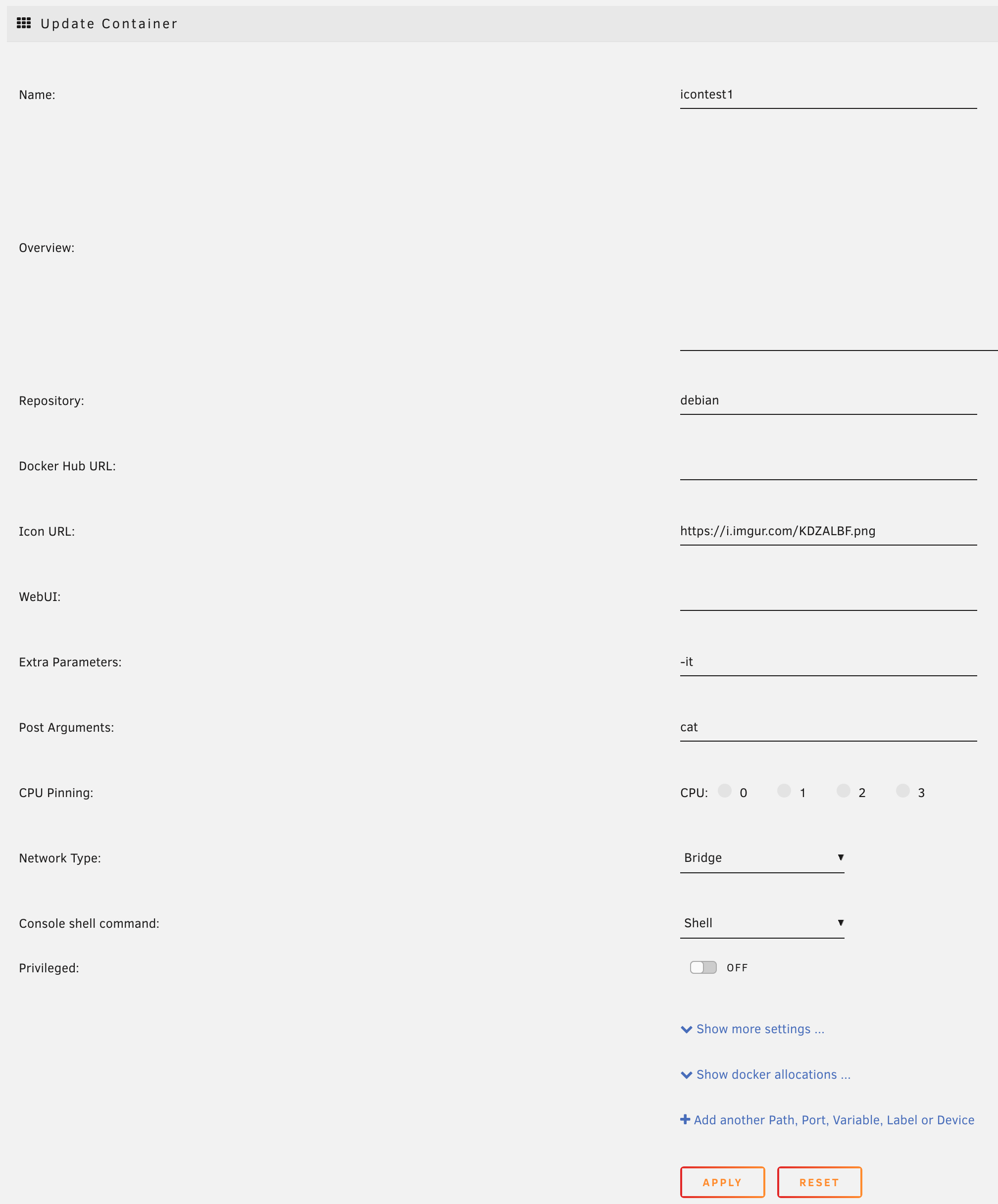

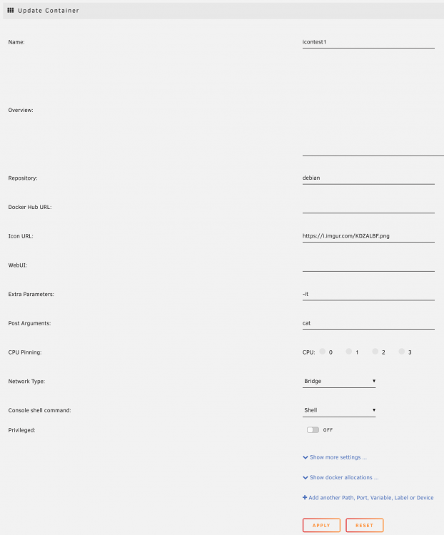

I just tried it with a new container and it happens again.
Initial container configuration:
Initial icon URL: https://i.imgur.com/KDZALBF.png
Updated icon URL: https://i.imgur.com/ajVjfzk.png
When trying to change the icon URL to the updated URL, the icon still stays the same.
