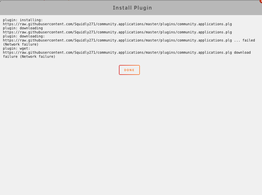

So I renamed as you said, and lost all my network configs, the result is the same. If I try to install CA I get this error:
Any other idea? All my network is working fine.

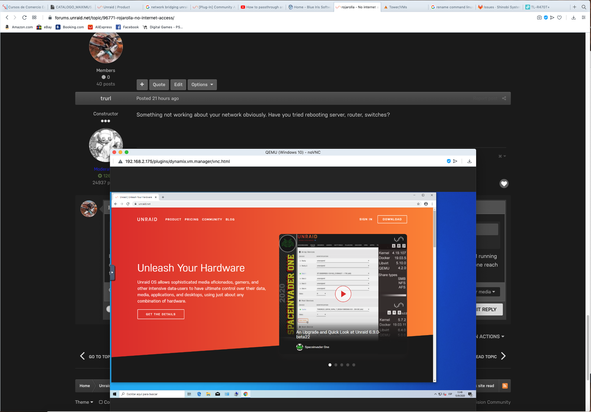

I doubt there is something wrong with the hardware, I can access Unraid's GUI and my shares. All my network works fine. Moreover, I have a Win10 VM running on unraid, how can it reach the internet and Unraid not? Take a look to my screenshot:
It's got to be something else.
