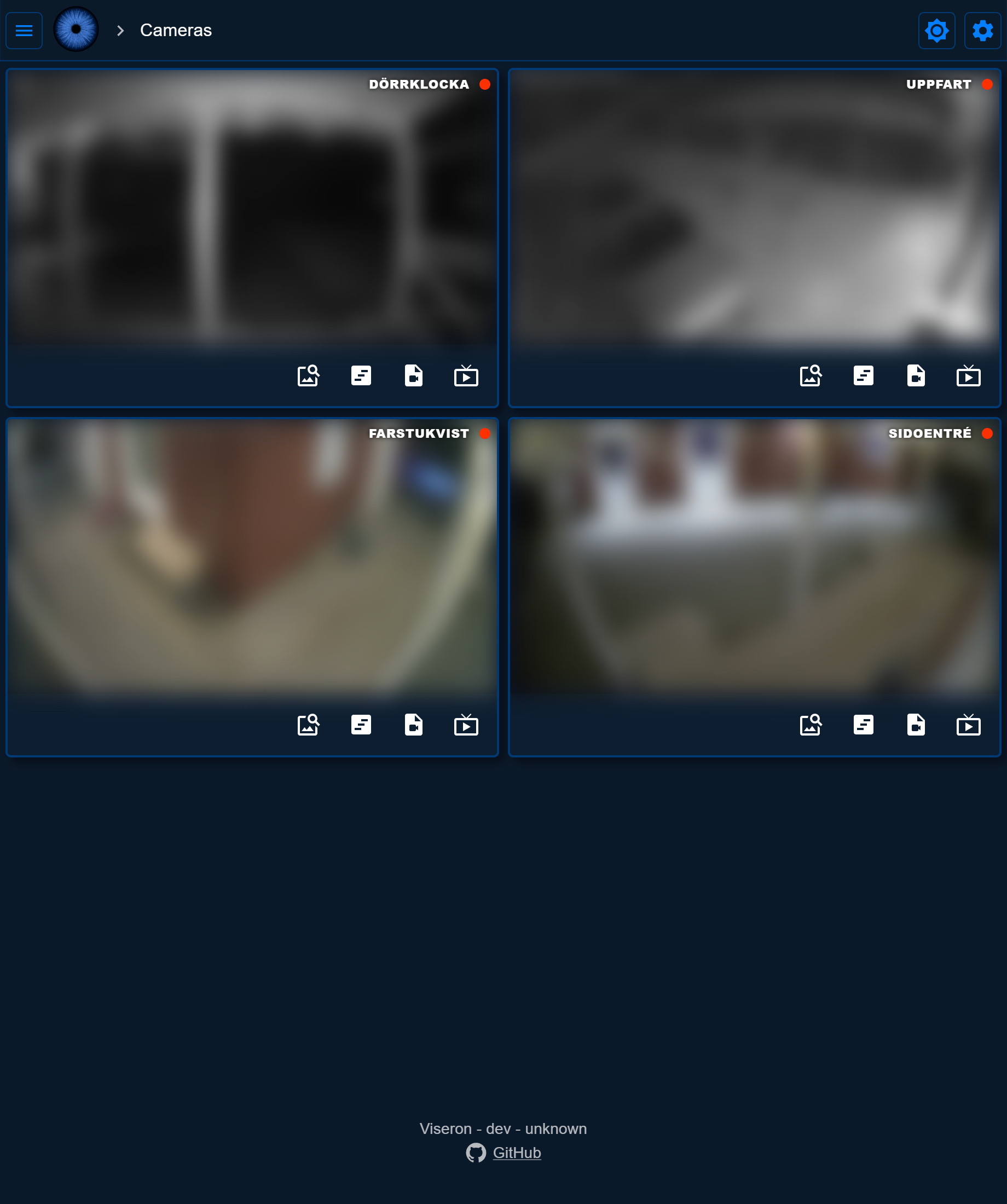

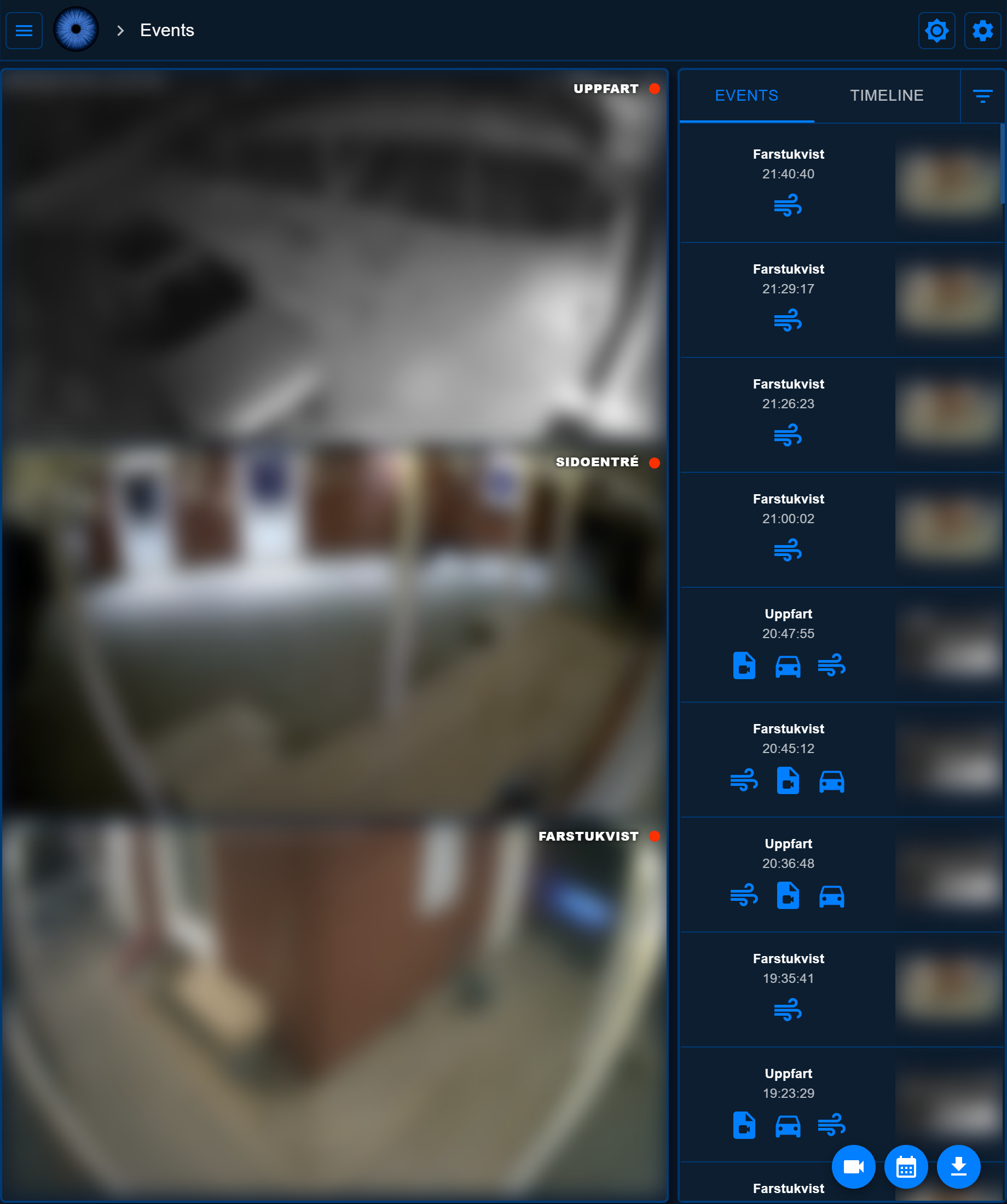

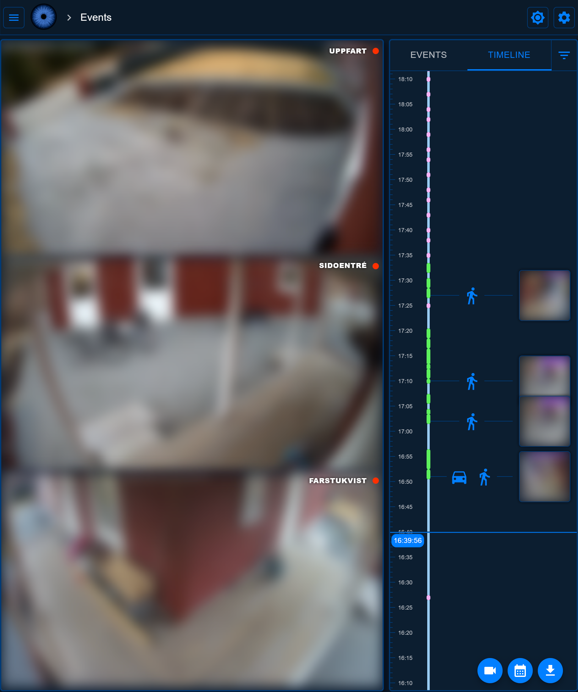

A few screenshots are included below, please go to the documentation for more: https://viseron.netlify.app/docs/documentation#screenshots

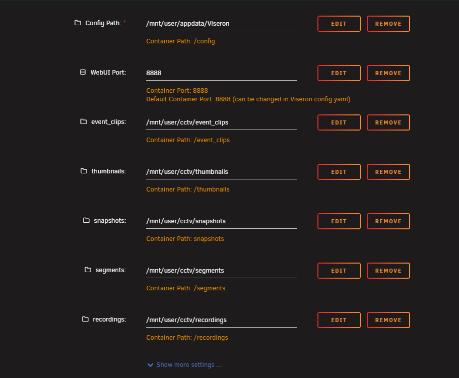

3 hours ago, roflcoopter said:
Updated the template, but i think it is broken now.
Can anyone assist in reviewing the template here: https://github.com/roflcoopter/viseron-unraid-ca-template/blob/master/Viseron.xml and see whats wrong with it?
I just tried out the current listing for Viseron on Unraid's Community Apps and it looks like it successfully installed. I'm able to get to the Viseron's web ui at least. I haven't tried adding any cameras or anything yet.
EDIT:
I just tried putting in the camera sample configuration as well and it looks like the sample cameras are working correctly as well. Haven't done anything with recording yet though.
I did notice that the icon for Viseron in my docker containers page isn't there. It's just using the standard blank icon image. I don't know much about templates though so I can't assist much with helping you there.
Edited by jeremytodd1
Okay great, thanks for confirming! I will look at the icon issue.
