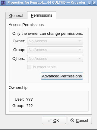

I have a folder in downloads/incomplete share. Folder was created by Deluge some time ago. I am able to rename the folder but i can't delete it. I have shut down my Deluge docker container.
Folder was originally called "freeman" or something like that. I have renamed the folder to "1" to make typing our commands easier for myself.
I've tried terminal running the below commands but the folder won't delete. Its throwing up this error rmdir: failed to remove '1': Directory not empty
rm -rf 1
rmdir 1
rm -f 1
So i've navigated to each folder "cache, disk1 ,disk2, disk3, disks, user & user0".
I found a file within the "1! folder on disk2, so i've ran the below in the terminal.
root@Voyager:~# cd /mnt/disk2/downloads/incomplete/1/
root@Voyager:/mnt/disk2/downloads/incomplete/1# ls
/bin/ls: cannot access 'Feast.of.Love.2007.1080p.BluRay.x264-CULTHD': No such file or directory
Feast.of.Love.2007.1080p.BluRay.x264-CULTHD/
So i presume i can't delete the folder called "1" because there is a file or folder in it. I can see the file/folder with Krusader but i can't delete it. When i check the permissions for the file it shows as below.
I tried to run chmod -f 777 on the file from the terminal and i get...
I've ran docker-safe new perms on the share (i think that is the correct step since its inside a folder created by Deluge) and i still can't access or delete.
What is my next option to rid this file and folder from my system.

58 minutes ago, remotevisitor said:
You did have file system corruption and the last run should have fixed it.
if you start the array, does the problem directory/file still exist, and if so can you now successfully delete it.
It looks like a bunch of files have been recovered into the lost+found directory.   Unfortunately they will not have sensible names, so unless you can identify them by their content there isn’t much you can do with them.
The question is what caused the file system corruption .... has your system lost power or been force powered off without shutting down in the past?   That could possibly cause corruption if it was writing to the disk at the time.   Otherwise I suspect you will not know what caused the problem.
Yes i have managed to successfully delete the directory/file & i've checked "cache, disk1 ,disk2, disk3, disks, user & user0" and it doesn't appear to be present in any of those dir's. Thank you remotevisitor & Squid.
I've deleted the lost+found data. I couldn't identify the data. I did have some issues with my build so there was some file system corruption.
My motherboard and CPU died and had to go for RMA (post here) & then one of my lesser important drives (i was using it to store some of my Deluge seeds) slid out of my case during the rebuild and bounced off the ground (post here). I managed to recover some data from the drive but not all.
The last few months of my "new build" have not gone very well for me. I think its all ironed out now
