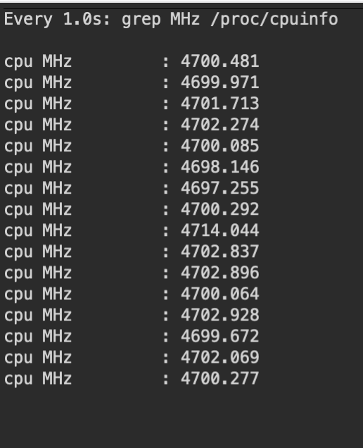

I did this, but not sure what I am looking for. I have 10700 I7 CPU.
Speed normal ( 4.7Ghz turbo), but if according syslog raid6 performance result seems a bit low.
