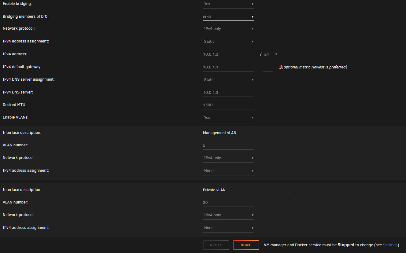

Here is what my unraid network config looks like:

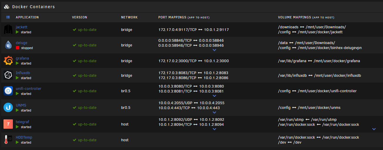

Here is a screenshot of my dockers :
While on my Windows VM (which has it's network as br0.20) I am unable to access the docker containers on the standard bridge mode (eg Grafana) however I am able to access the dockers using custom networks (eg UNMS).

For reference to anyone in the future I have fixed this by doing the following:
Removed br0.20 from unraid network settings
Set Windows VM network to br0
Set vlan tagging inside the Windows VM for VLAN 20
This has allowed for my Windows VM to connect to the correct subnet and also allows me to manage my unraid webui and docker uis also.
